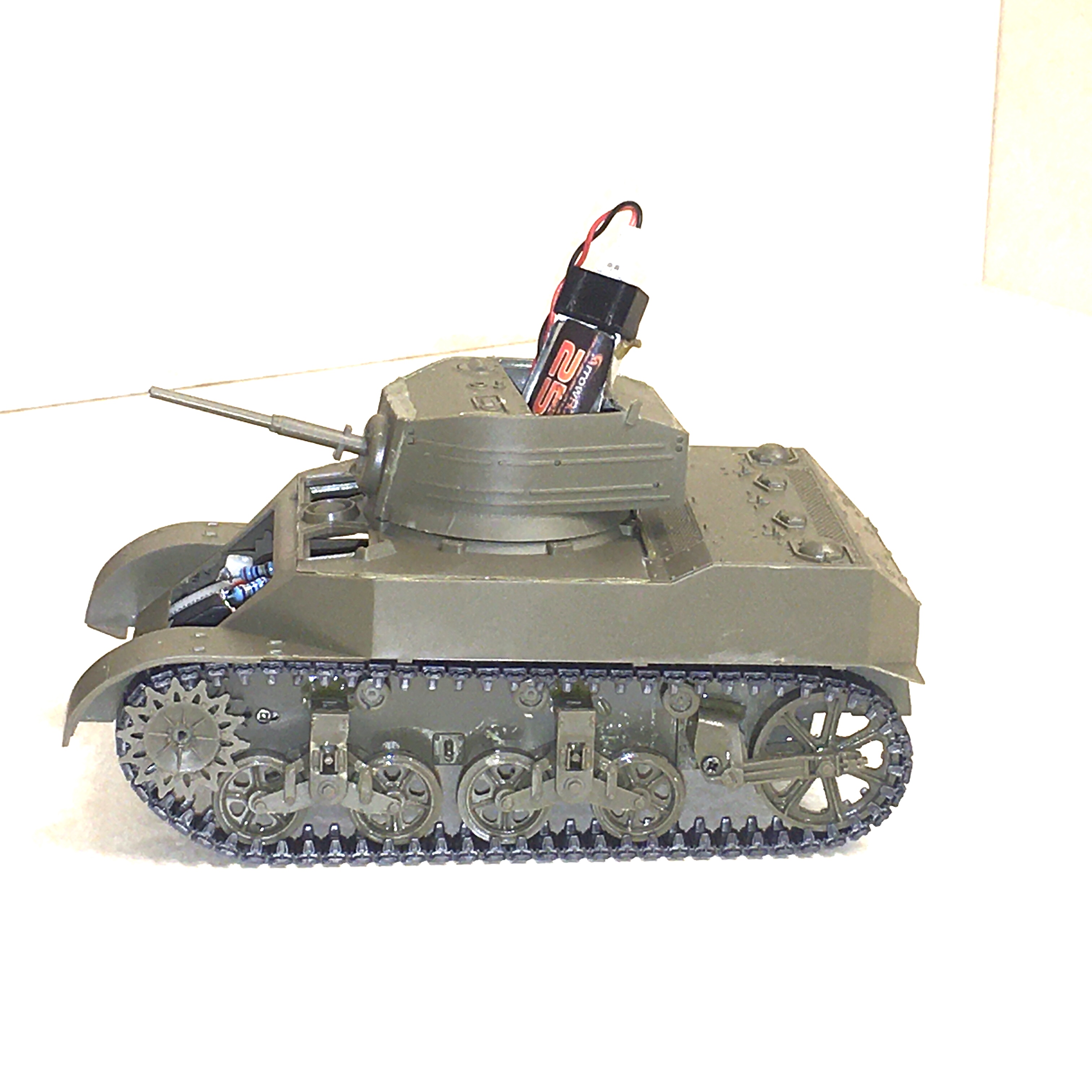

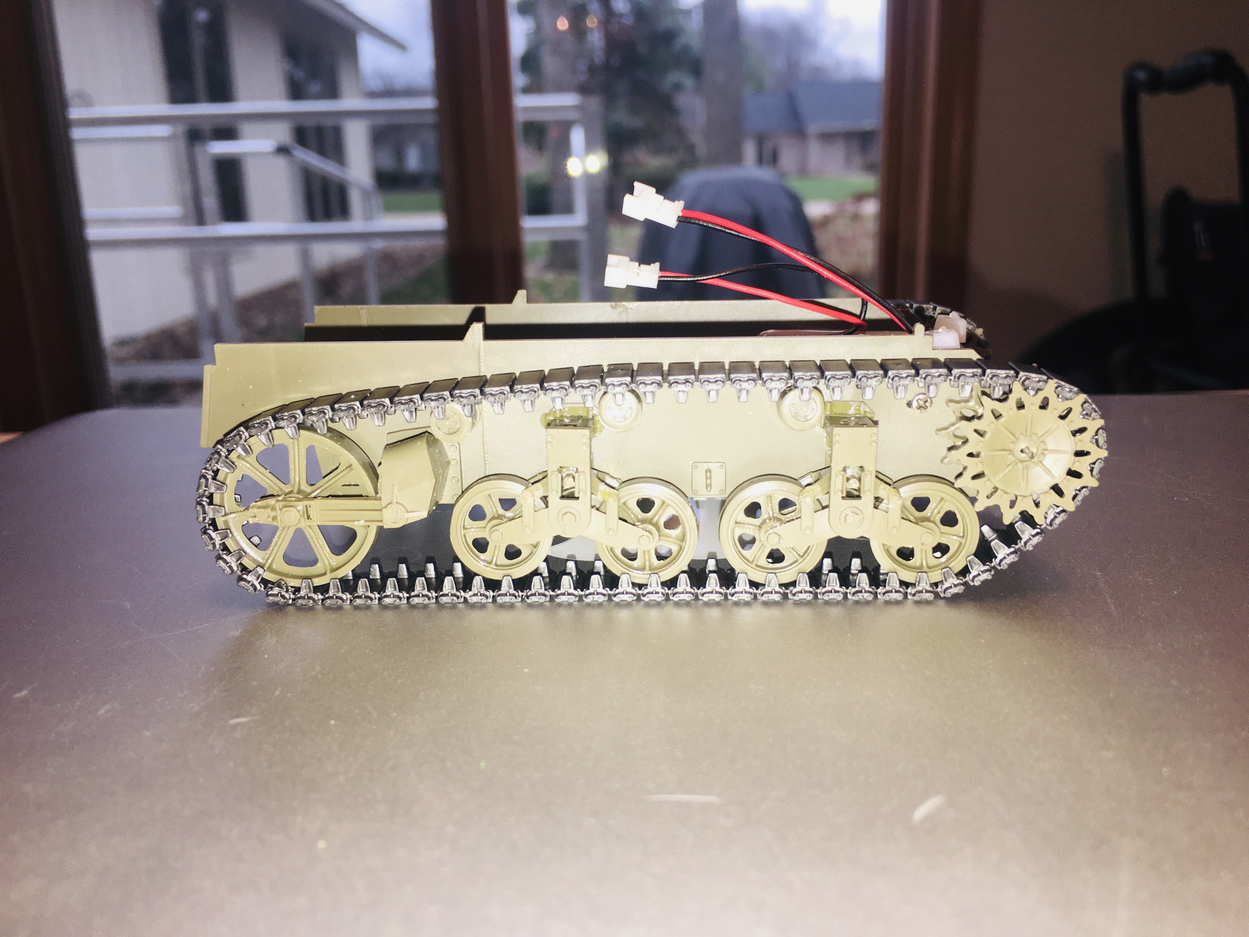

In my rush to build the chassis up on the Stuart, I was not thinking of alignment of the road wheels VS the tracks and from the first picture posted you can see some unwanted road wheel lift. The result is the lifted road wheels don't spin when the tracks are in motion. This spoils the view of the tank when moving in either direction. This is a problem with most tanks with fixed suspension and can not be resolved 100% because of the light track loading of these small models but can be improved. The picture below shows an improved road wheel\ idler stance.
edit, that front bogie is still off a bit. Still working on it. BOTH SIDES :problem:
I had to raise the idler wheel a bit on both sides, that took a good deal of time to get right but its a hobby right ;)

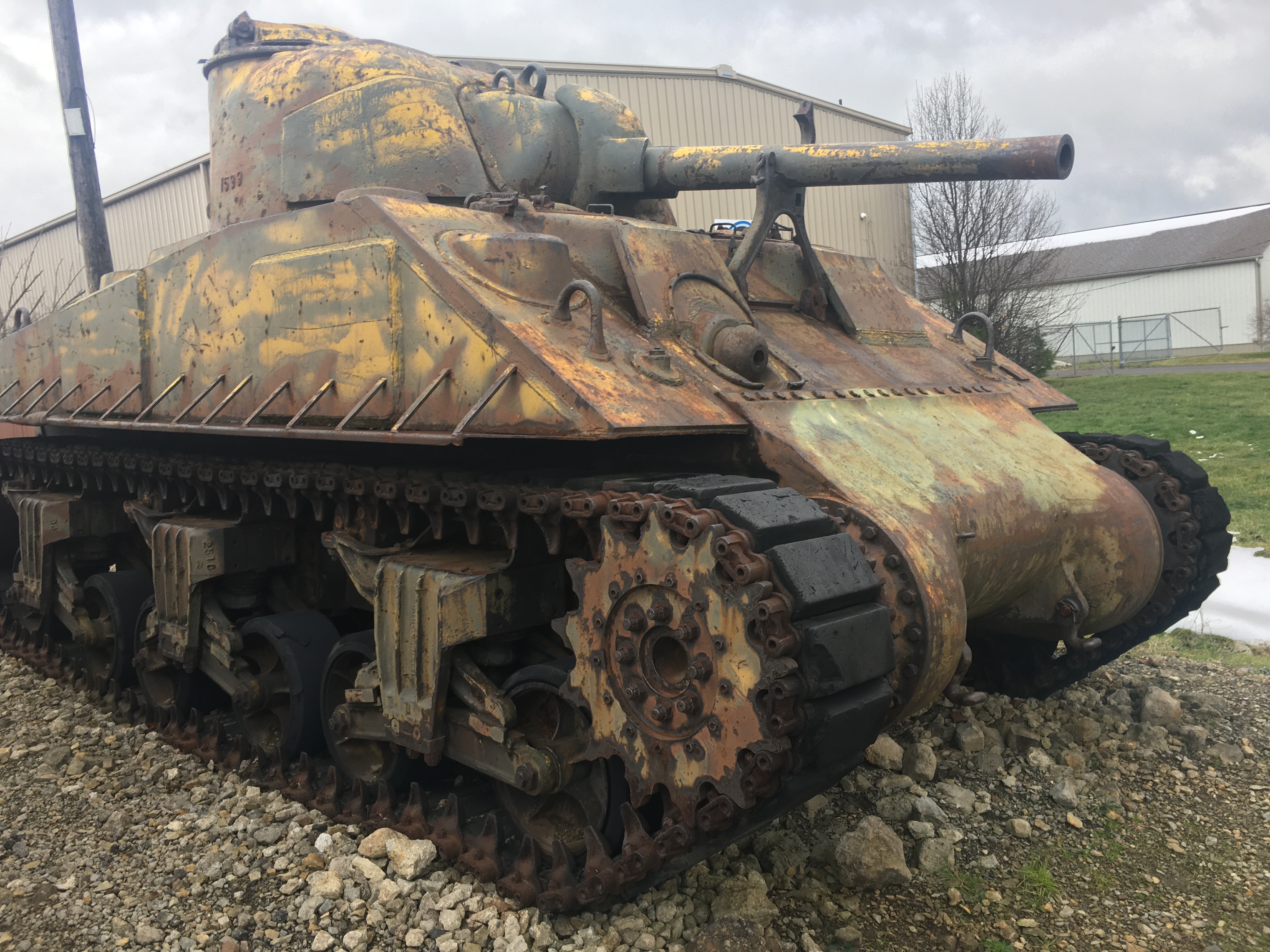

Here is that 1:1 beautiful thing again
The stance is not good here, unwanted road wheel lift and the idler wheel position is too low. This is the stance of a Tank without loading to the rear which indicates no motors or driveline is present.

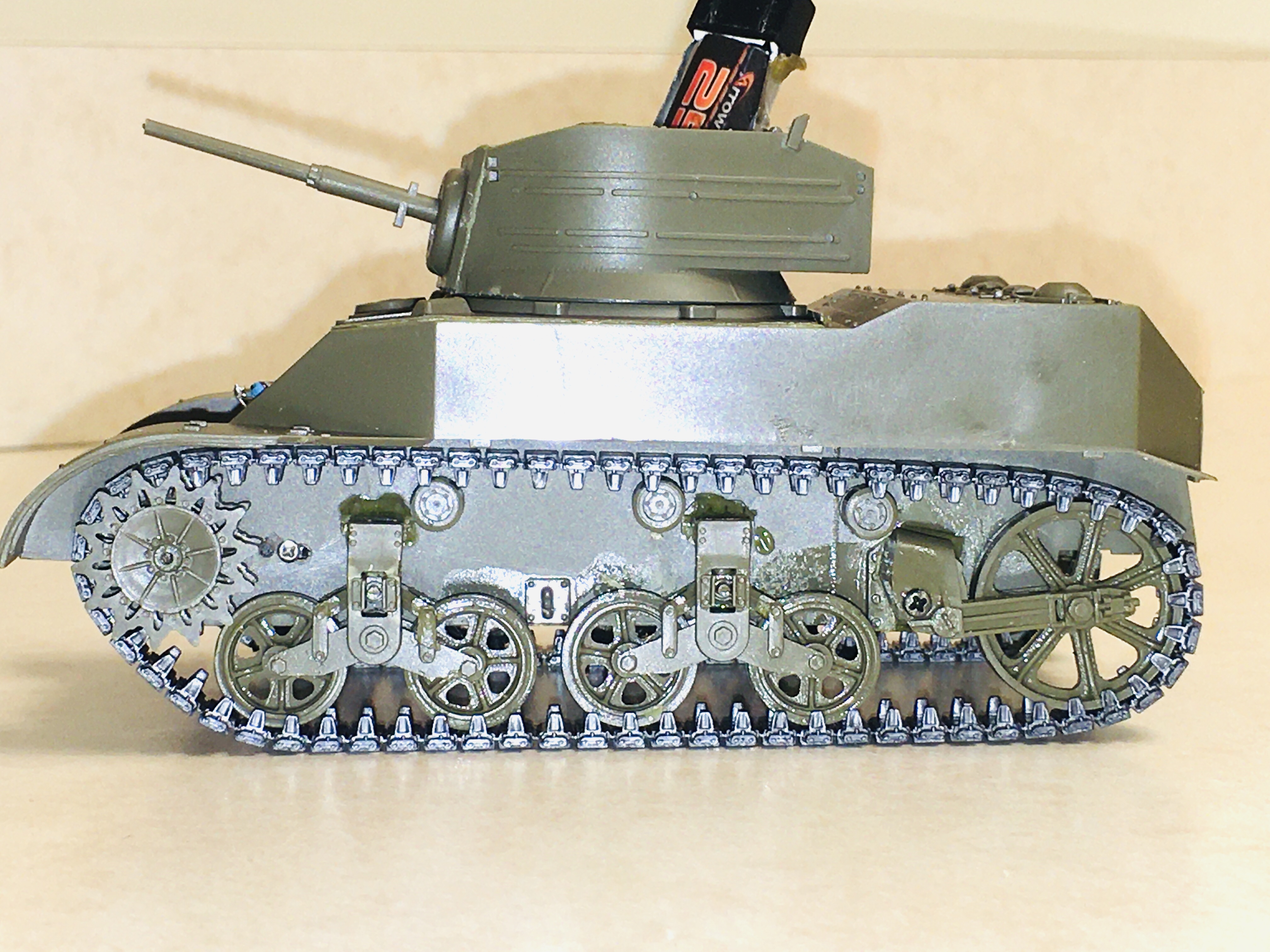

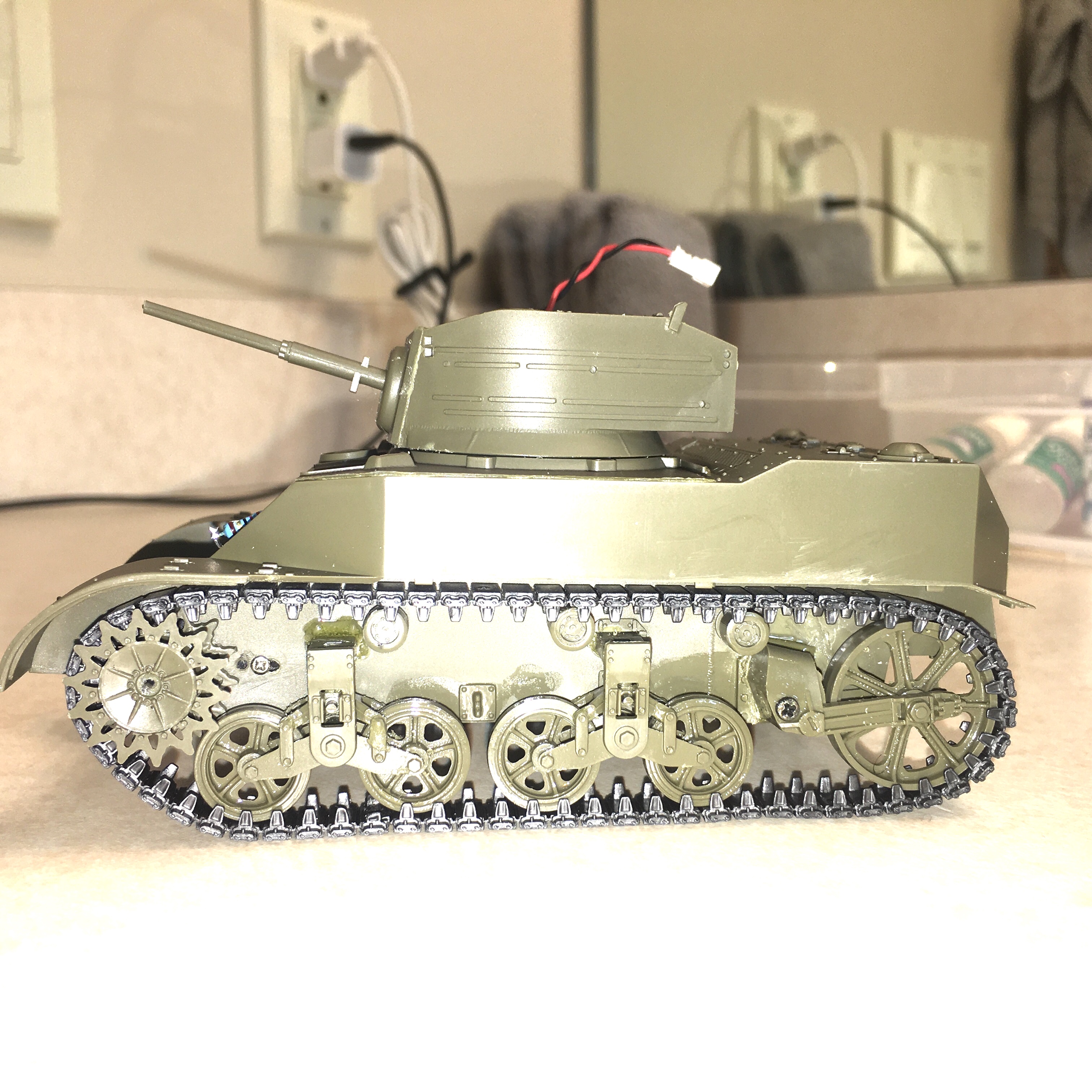

improved stance looks more realistic to my eyes. The screw in the idler wheel assembly is at the center point of rotational axis allowing the assembly as a whole to rotate CCW results in idler moving upward in the vertical axis. That and more was done to get the stance you see here. More to go to get it right. The screw head visible near the front drive sprocket is for setting Left track tension.

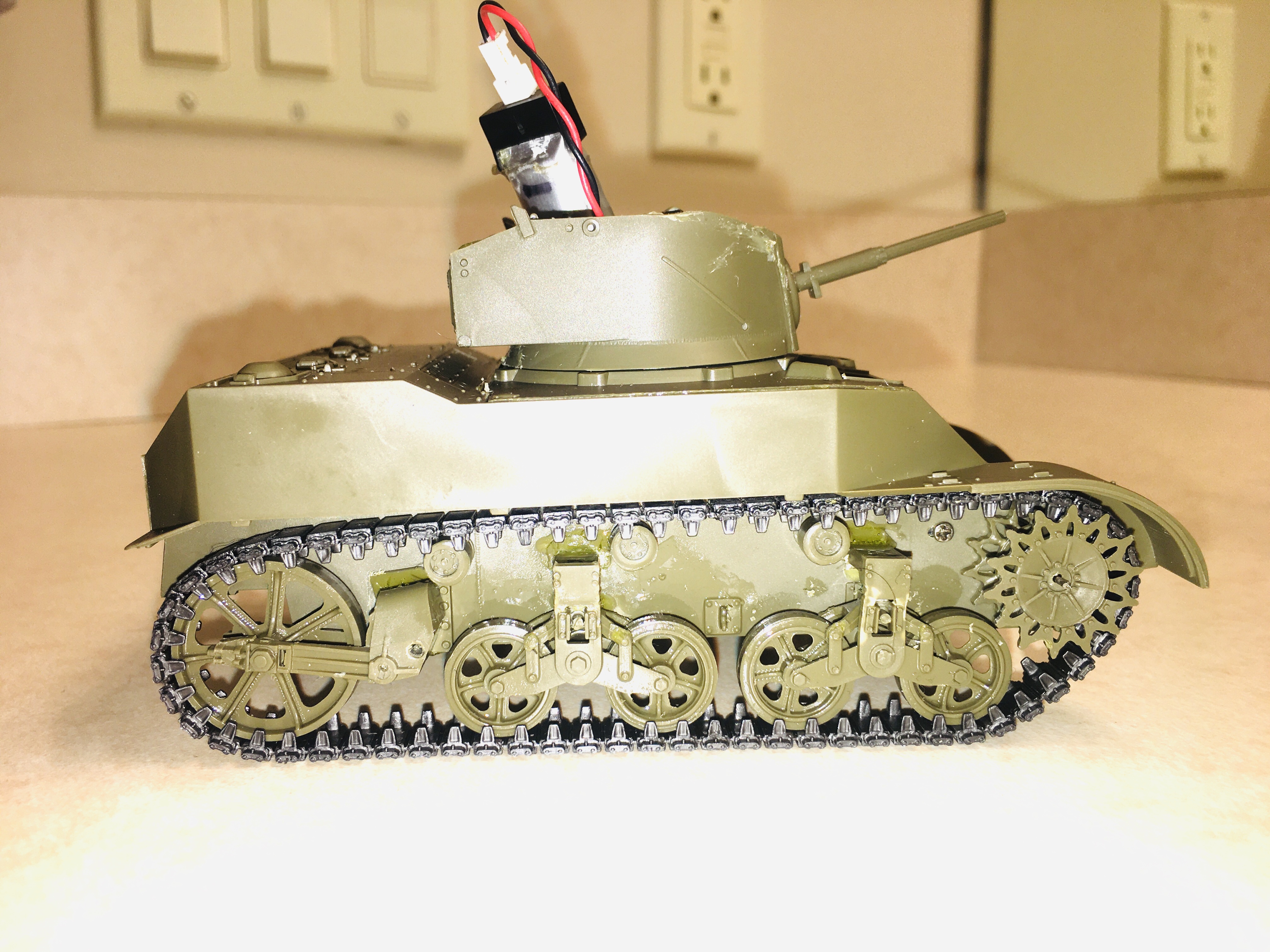

Final road wheel alignment done :D
the pictures below show L/R side shots with road wheels alined as good as I can get them.
