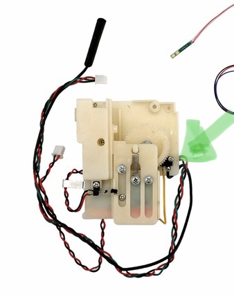

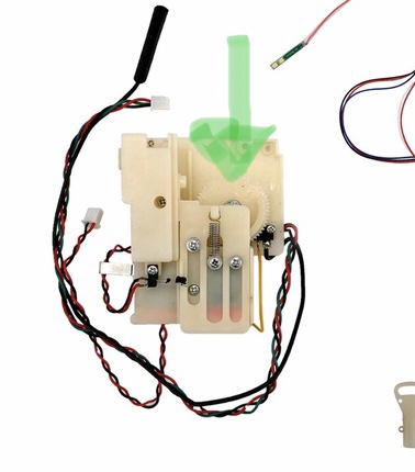

This is what the micro-switch looks like (thanks to Painless whose photo I cropped).
It would be attached to the outside of the unit that slides the barrel back and forth. For the KV-2 and others, I have to unscrew the turret ring to get at the micro-switch.

:D Hello, without wanting to upset Her professor, I was talking about the other microswicht, this one unless I am mistaken is the one that controls the Flash..
he problem comes from this pinion, generally, see if it is not blocked, and if the drive motor works well, it is easy to check, by powering the motor (green, in principle) with 5 volts directly.

Its the one Herr Dr. Professor pictured that sends the signal for the gun fire and flash
The one on the side with a yellow and black wire is a negative power supply for the recoil motor to return to its the firing position

Oh ho! So BOTH might be checked. I need to remember that. A grateful tip of the hat to Jofaur86 and John1970.
