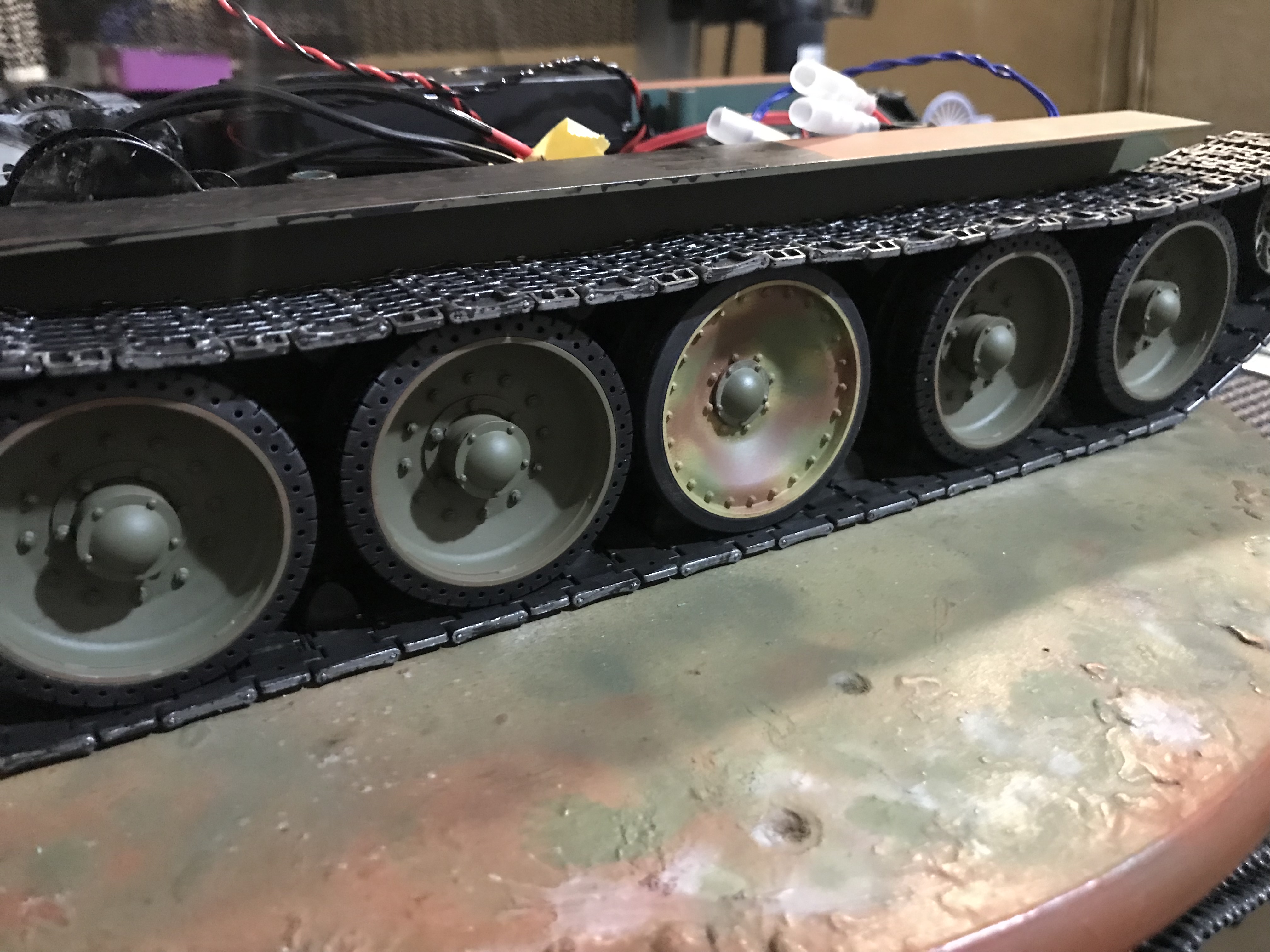

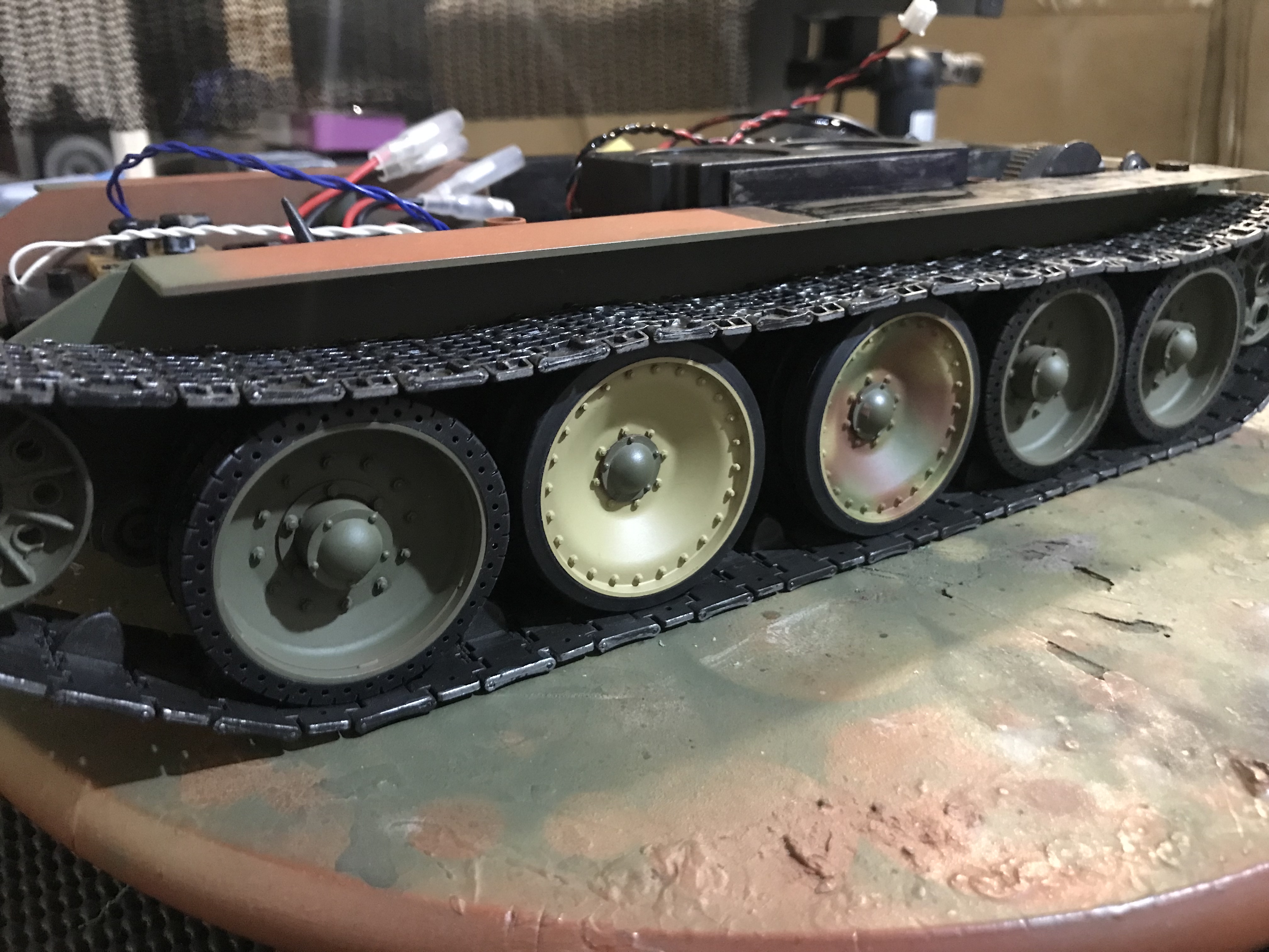

They would stick out as per the period pictures but there is not a lot of room in the Tamiya wheel to play with.
So they are not quite spot on for positioning.

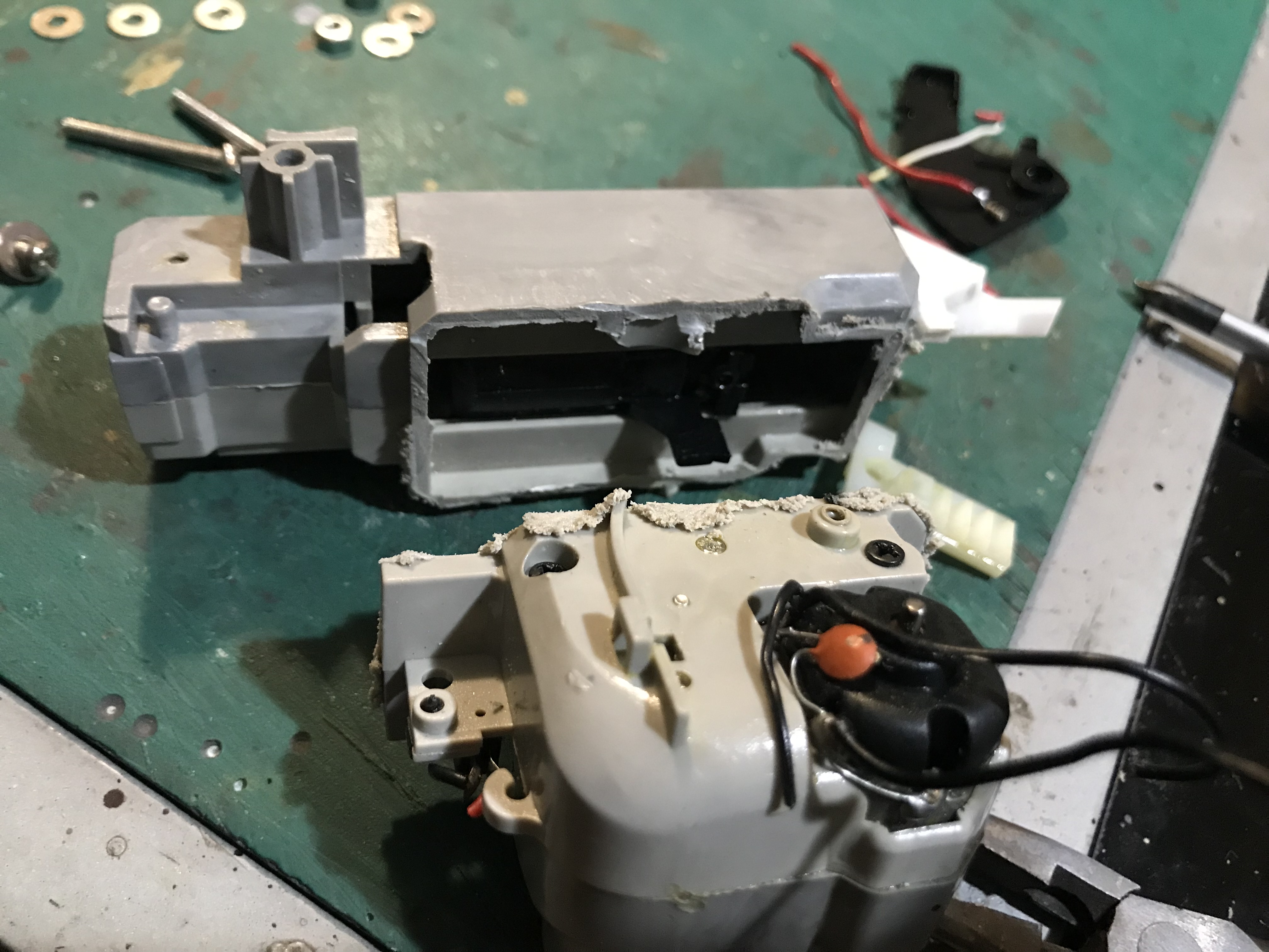

I have gone a fair way back to go forwards , ripped to bits a lot of your hard work.
The BB unit had to go.
So I sliced the bottom off it, retaining the upper bit with the piston arrangement .
I will think of how to join the barrel to this for recoil somehow.
Elevation mounts broke during testing so the standard HL unit was sent to the spares box to be replaced with a servo.

Took the advice of Mr Lav & banged a quick cam job onto two of the Panther wheels, leaving the other plain gelb.
Re: SU '85 AN-BRI-RAMINATOR PROJECT
Looking good
Subtle and not the in your face, brand new look.

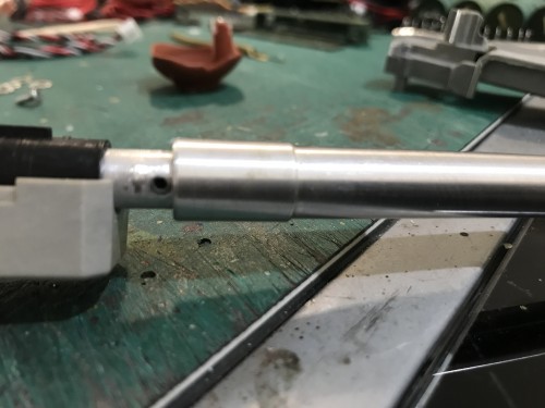

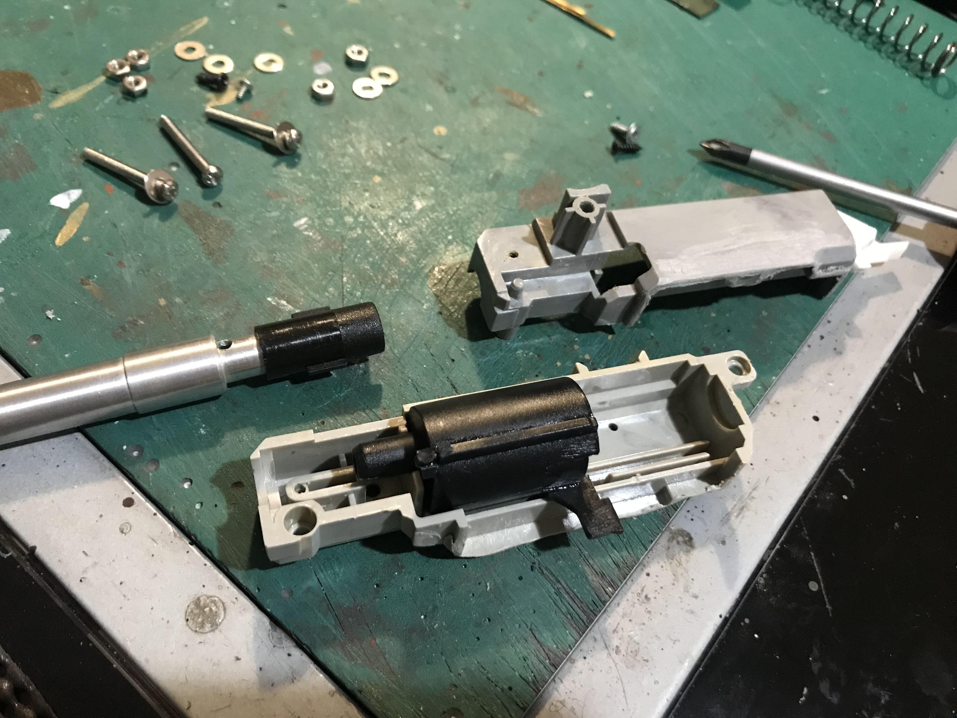

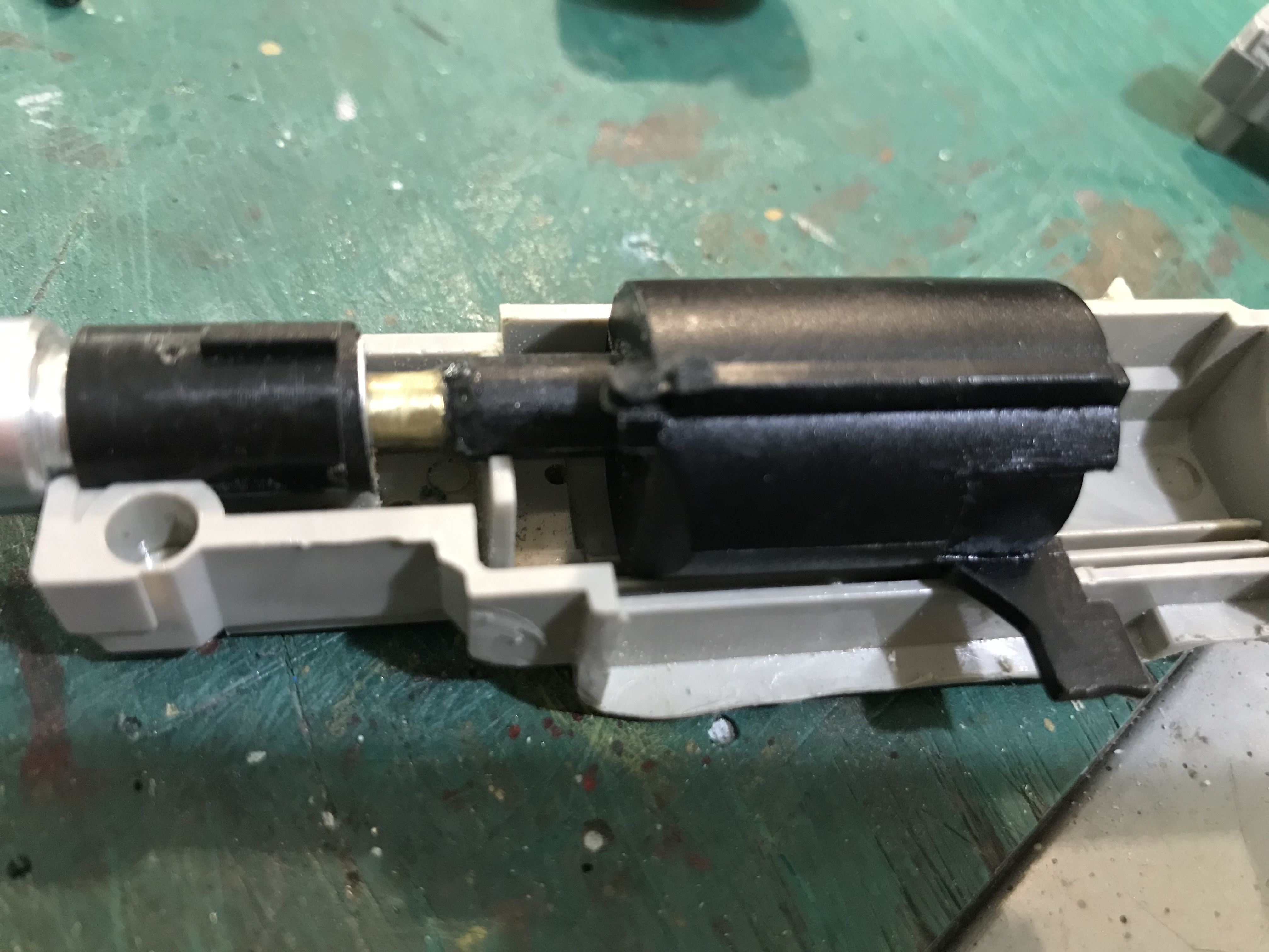

The carnage of removing the BB mechanism behind me, I came up with a plan on how to use the basic functionality of the remnants to use as a recoil system, and preserving the pre-made mounting that Mr Raminator had already made to get it into the resin An-Bri casemate.
The front part of the BB unit which is a the loading chute for the ammo, now acts as a low friction sleeve for the metal barrel.
Of course to ensure I have a plan-B if required, the barrel is removable.
I used a couple of brass tubes that telescope over each other to go inside the barrel secured by a Taigen suspension grub screw put into the hole normally used to vent the air from the BB shot.Tapped it 3mm & the screw goes onto the brass tube nice & solid.
I bored out the piston to take the other end of the brass sleeve, and after a bit of testing & setting, secured that with Gel super glue.
Once the case halves are joined together, after a little bit of lube on the sliding areas, the lot should work a treat with the servo hooked up.
No need for miles of recoil stroke, as long as it recoils
