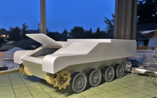

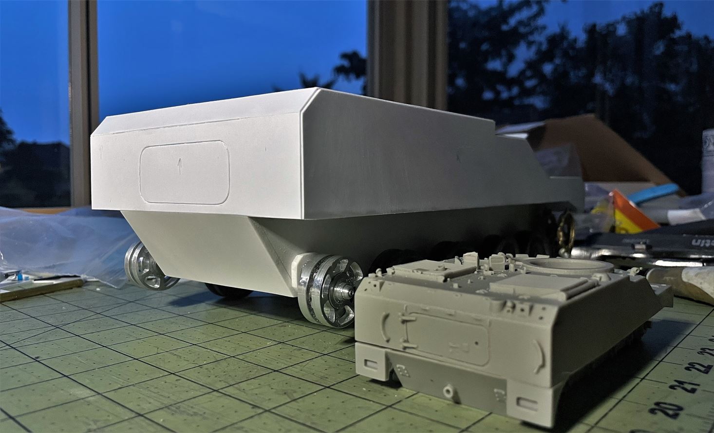

First, i need to complete the exterior armor in order to prevent residue from the construction and dust from sanding from getting inside the chassis, drive shafts, etc. The rear panel is put on, with the overlay for the static hatch. The round corners of the hatch are done with the roundel tool.

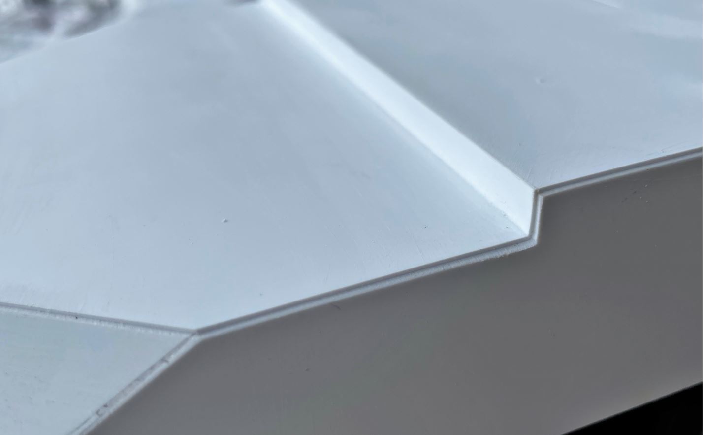

As shown in reference and contrary to the 1/35 kit, the armored roof is not flush with the side armor plates, it has a partial overlay to reproduce.
The overlay layer is added to the model roof, the top being removable, it also hide the top joints for a nice finish. Nice smooth base to build on the details.

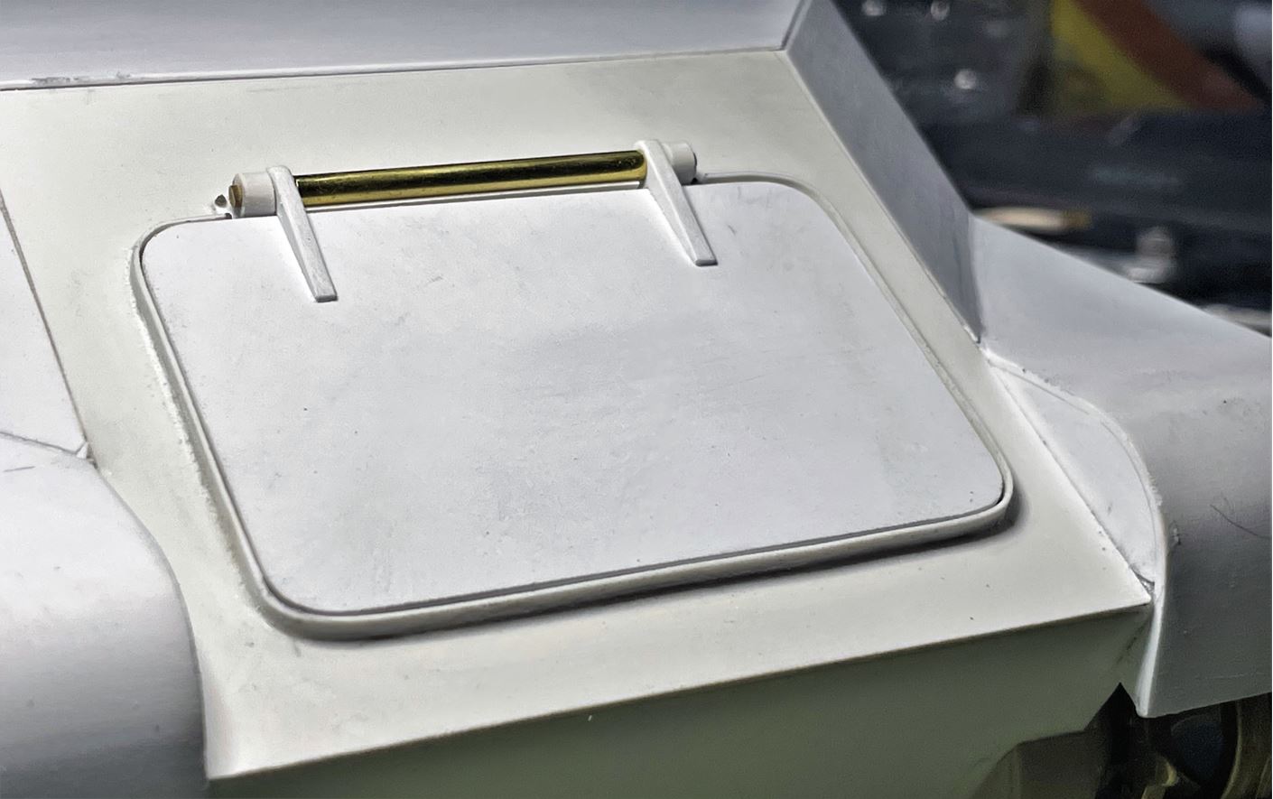

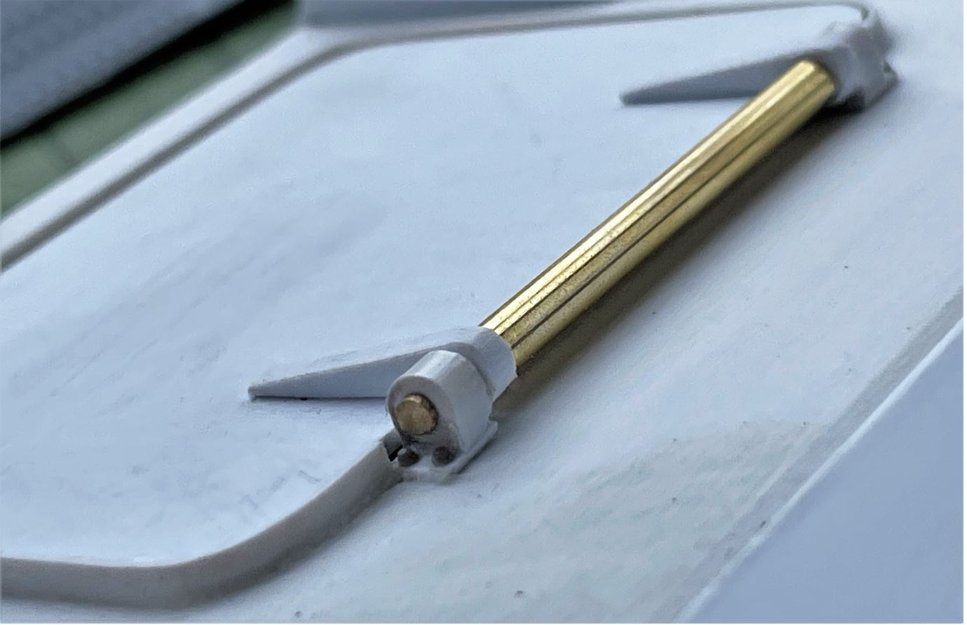

Side view of the frontal hatch with the water gutter around it and the large hinges typical of the M113.

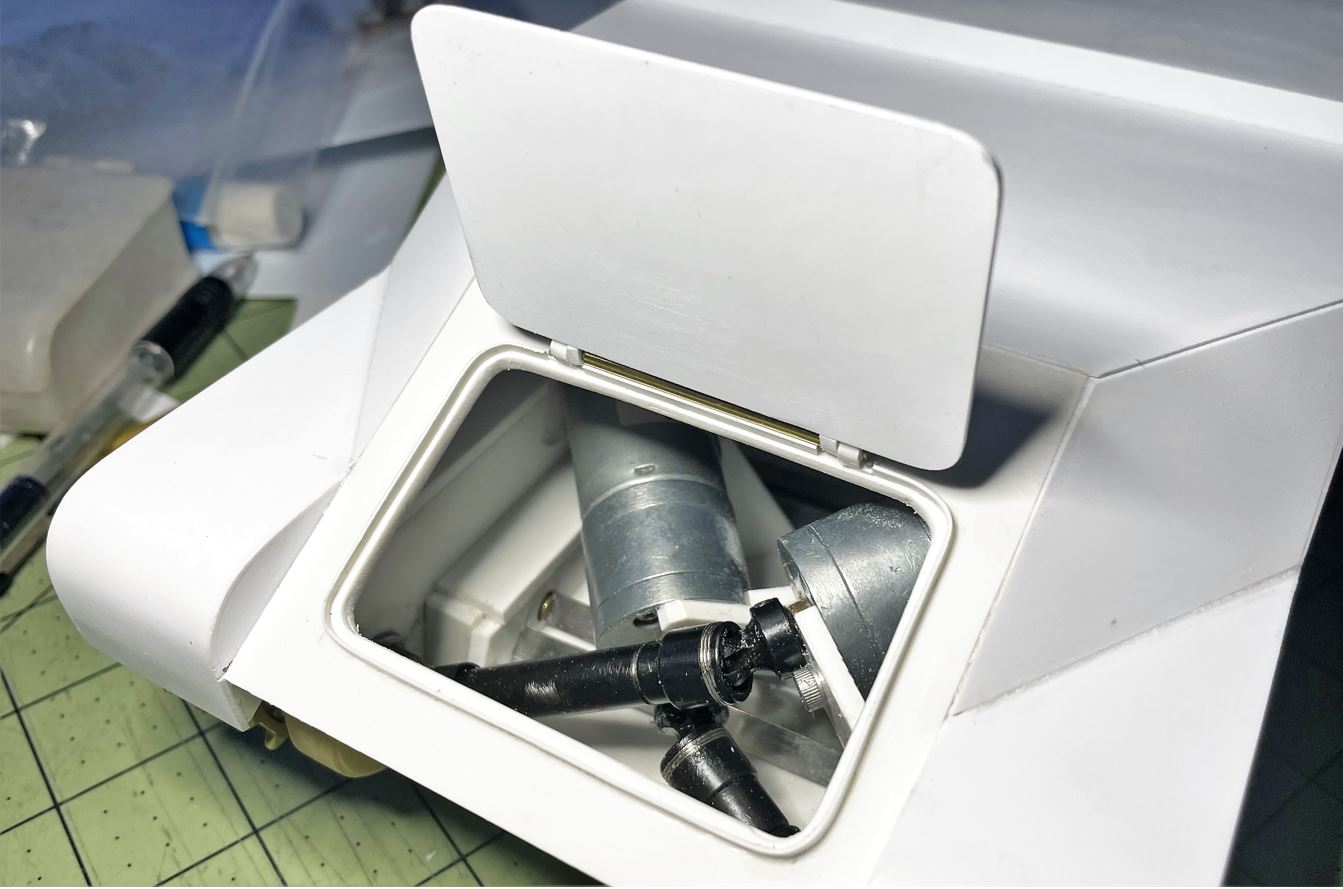

The large frontal hatch is installed with working hinge to access the motors and drive shafts inside the hull.
The model as it stands tonight.
The rear armor has the same overlay.
Now i have a sealed hull. Other than building the tracks and test the integrations, the model needs a lot of details that will take time to build one after another, but it is mostly cosmetics, no more major technical design challenges.

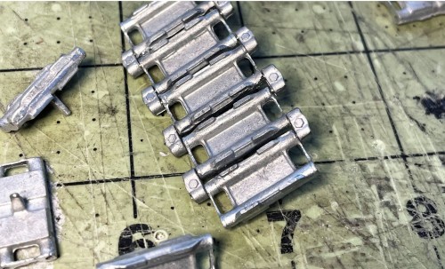

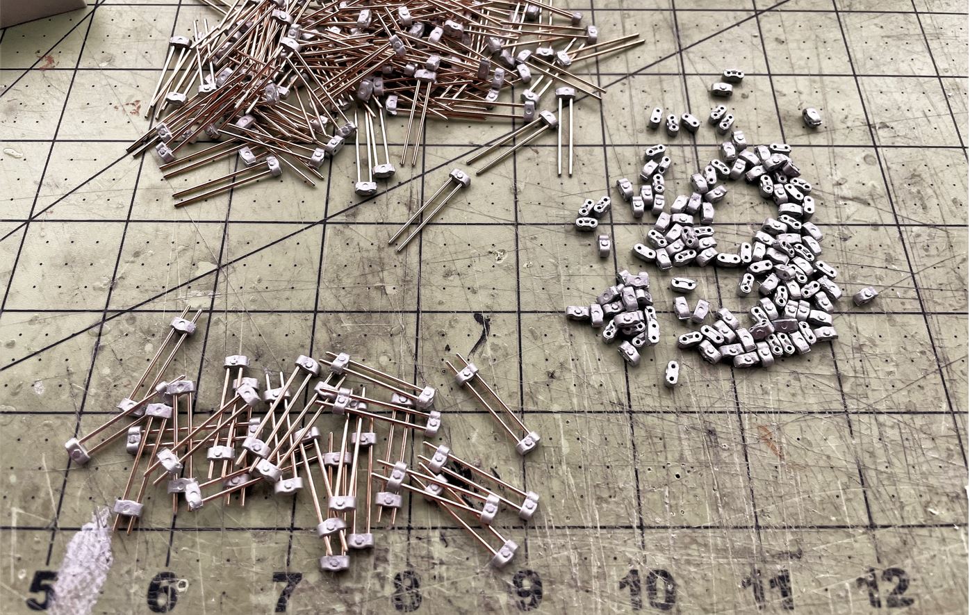

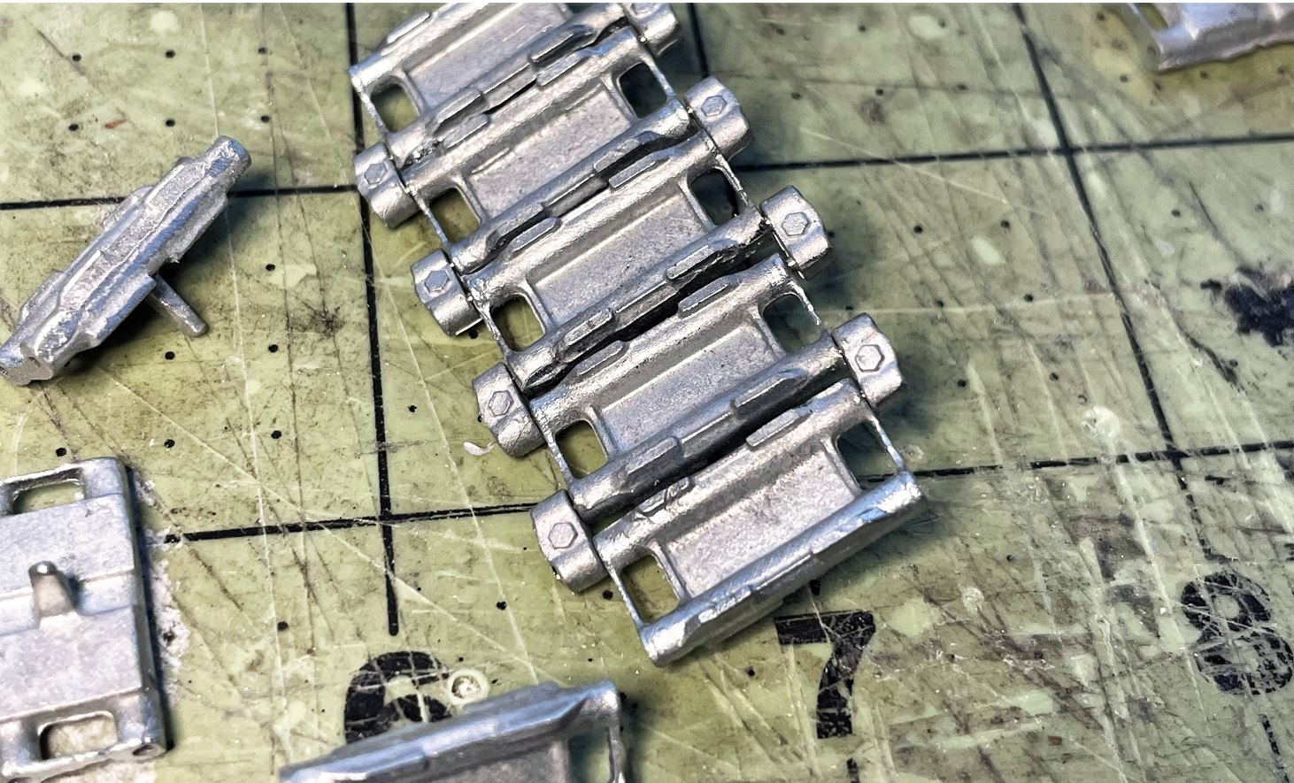

Starting to build the tracks.

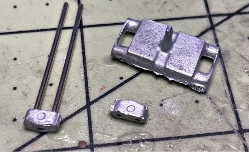

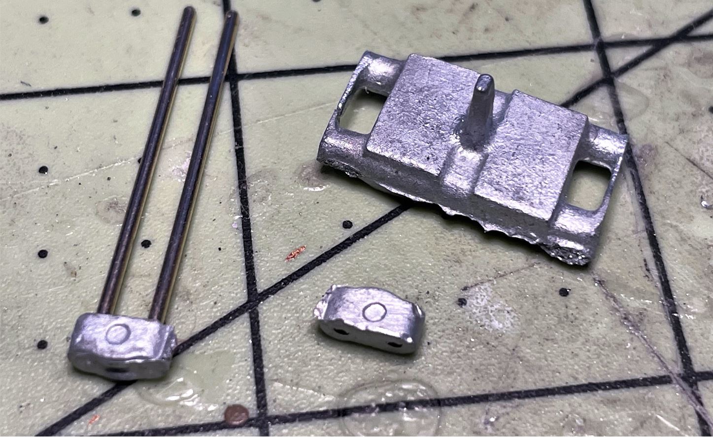

First the pins need to be prepared by removing one of the end point. Looks like the end points were molded on the pins. It takes pliers in 2 steps to remove them.
Every links and pin attachment points need to be sanded and polished for a smooth operation. You can see the bleeding on the mouldings below. This is pretty hard metal to work with. It just takes time.
Then assembled but without the rubber pads at this time. The tracks need to be built very tight, the end point is hammered on the pins but use of many pliers is required, sometimes i need to go back and reapply pressure to squeeze each connector, then file again. If the track pins are too loose on the links, the tracks will work badly. Some few links are also smaller than others by 0.5mm for some mysterious reasons. Because i think i will have many extras, the short ones are discarded.
It also takes time to cut the extra length of each pins, and then file the tip. These metal pins are hard as nails and need large cutter and muscle to cut. Its not the first time i build these.
I figure it will take a day or two.

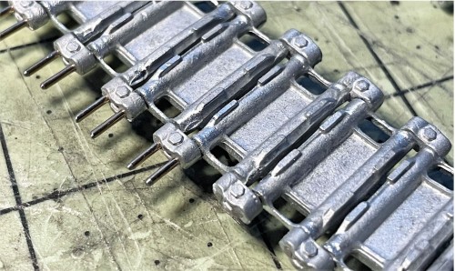

The new Tank Modellbau metal tracks are finally assembled, taking about 6 hours in total. I used a Dremel cutting disk to cut the extra length of the pins. They are without their rubber pads that will be installed only after painting. One pin has not been finalized for easy removal of the tracks. Being new and hand built, the tracks are still a bit stiff, showing it more at low speeds but they have much improving after a break in period of 30 minutes on the bench running at full speed. There is always a couple of links or sprocket teeth that cause more friction than others and need more filing. Keep in mind the tracks represents the NATO German made M-113 variant used later by Canada and other countries, not the American T130E1 tracks.
Here is a video of the motorization testing at various speeds. Its running pretty smooth for such a scratch built setup.

Thank you Herr Dr. Actually, the biggest challenge is to make the Tank Modellbau metal tracks and sprocket to run correctly. Whoever has assembled one of those tracks will understand. They still run with some unwanted tension on a few track links but it is really getting better compared to when i run them the first time. They need a lot of fine tuning, grinding the metal here and there, replacing a link here and there. Its like teaching a kid how to walk.Herr Dr. Professor wrote:It is impressive to see the tracks and that cross-shaft arrangement running so smoooothly! Congratulations on an engineering feat supreme!

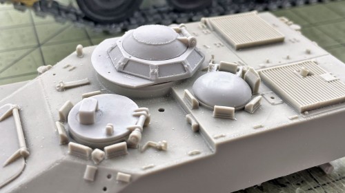

Continuing with the build, the following set of posts are for the commander's cupola and the other hatches.

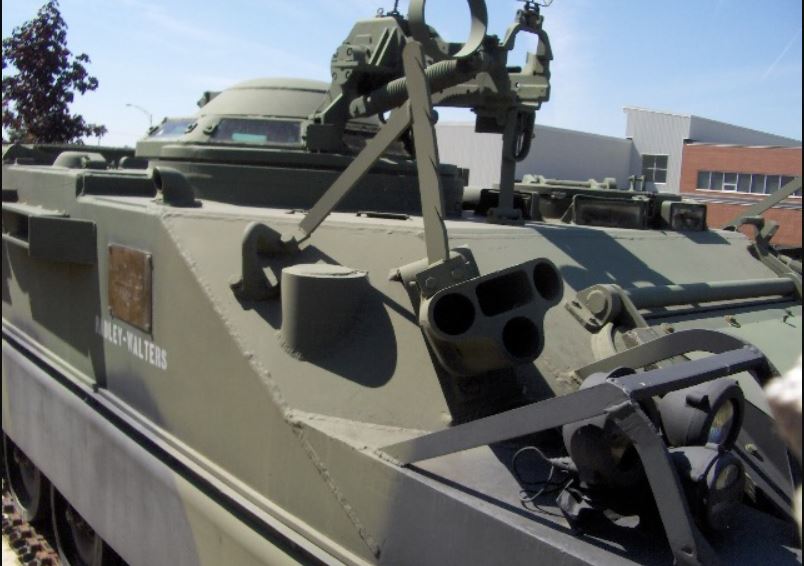

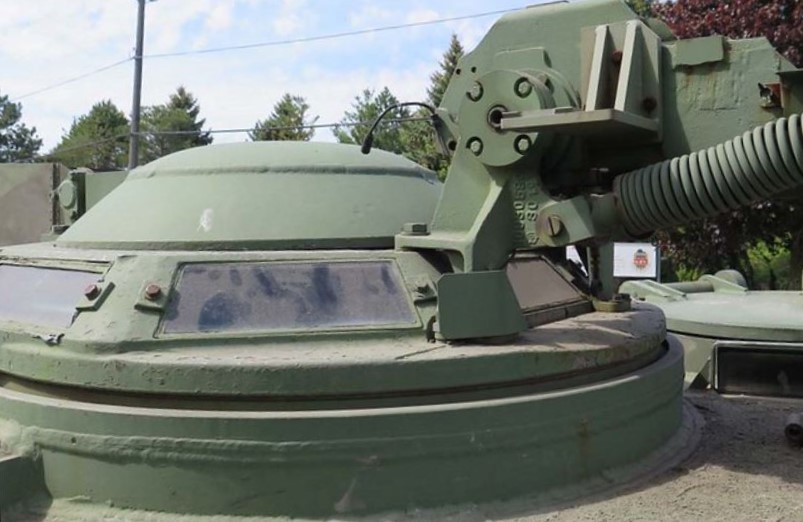

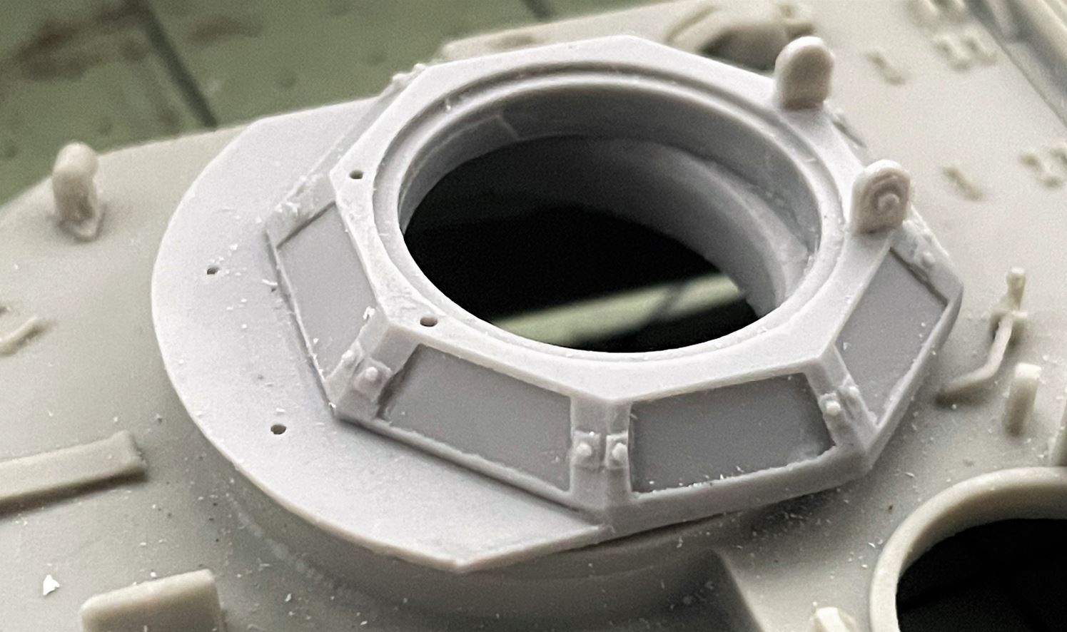

On the Canadian M113 Lynx as shown on the 1/35 kit below, the commander's has an M26 cupola, manually traversed and armed with a M2 Browning heavy machine gun installed on a flat platform in front of it, and fired from inside the vehicle. To reload, the commander has to open the hatch. The observer has a regular M113 commander's hatch and fires a rear facing pintle-mounted Browning 7.62mm machine gun. The driver has a regular M113 driver's hatch.
The M26 cupola offers good vision with all around periscopes. Notice the turret axle of rotation in comparison to its base. I have not seen this before.

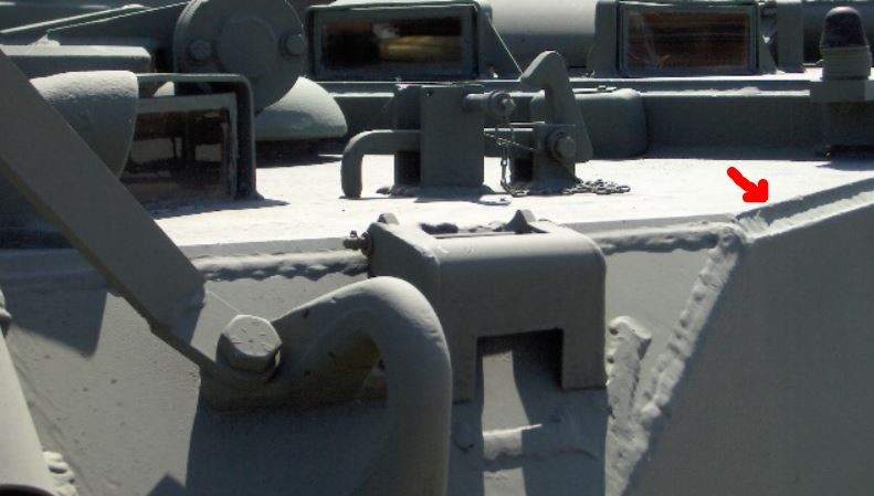

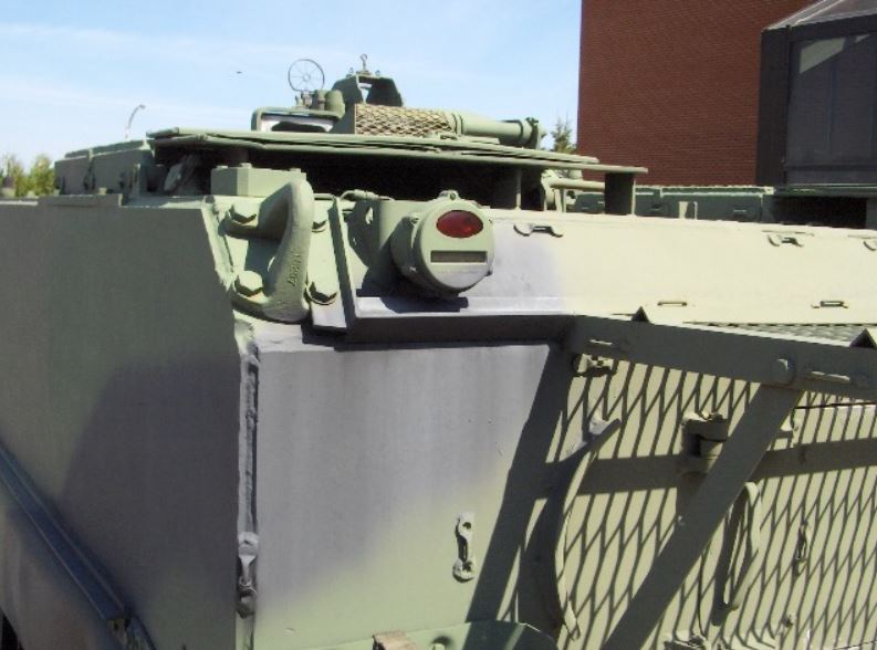

To complement the 1/35 kit that i found has some simplifications and mistakes, the web has excellent Lynx walk arounds with tons of pictures, i specially like the one on Net-Maquette.

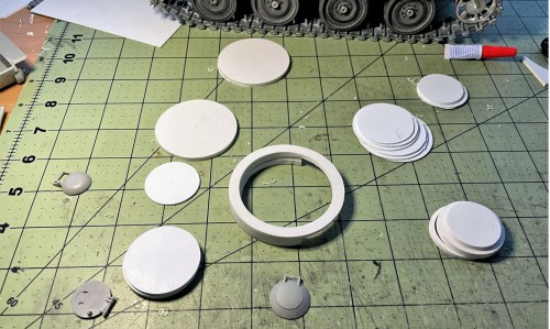

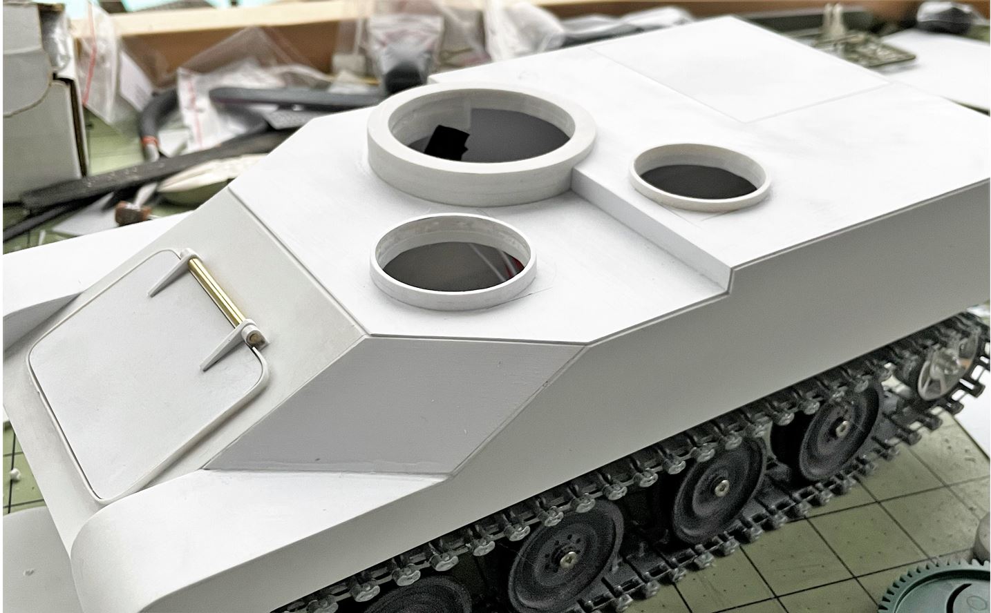

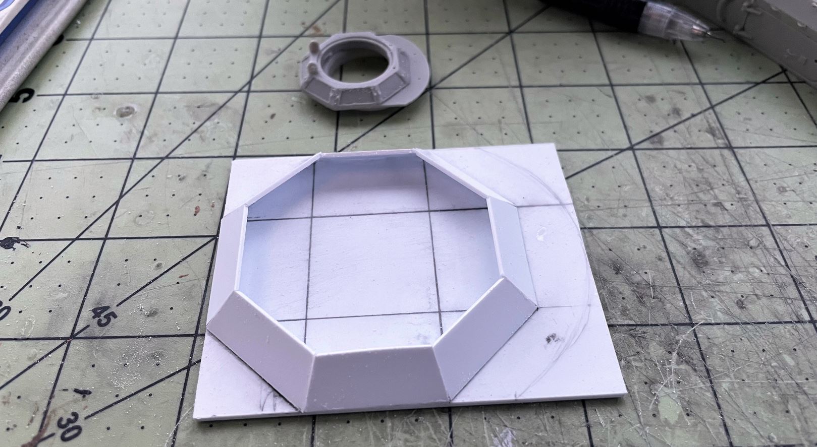

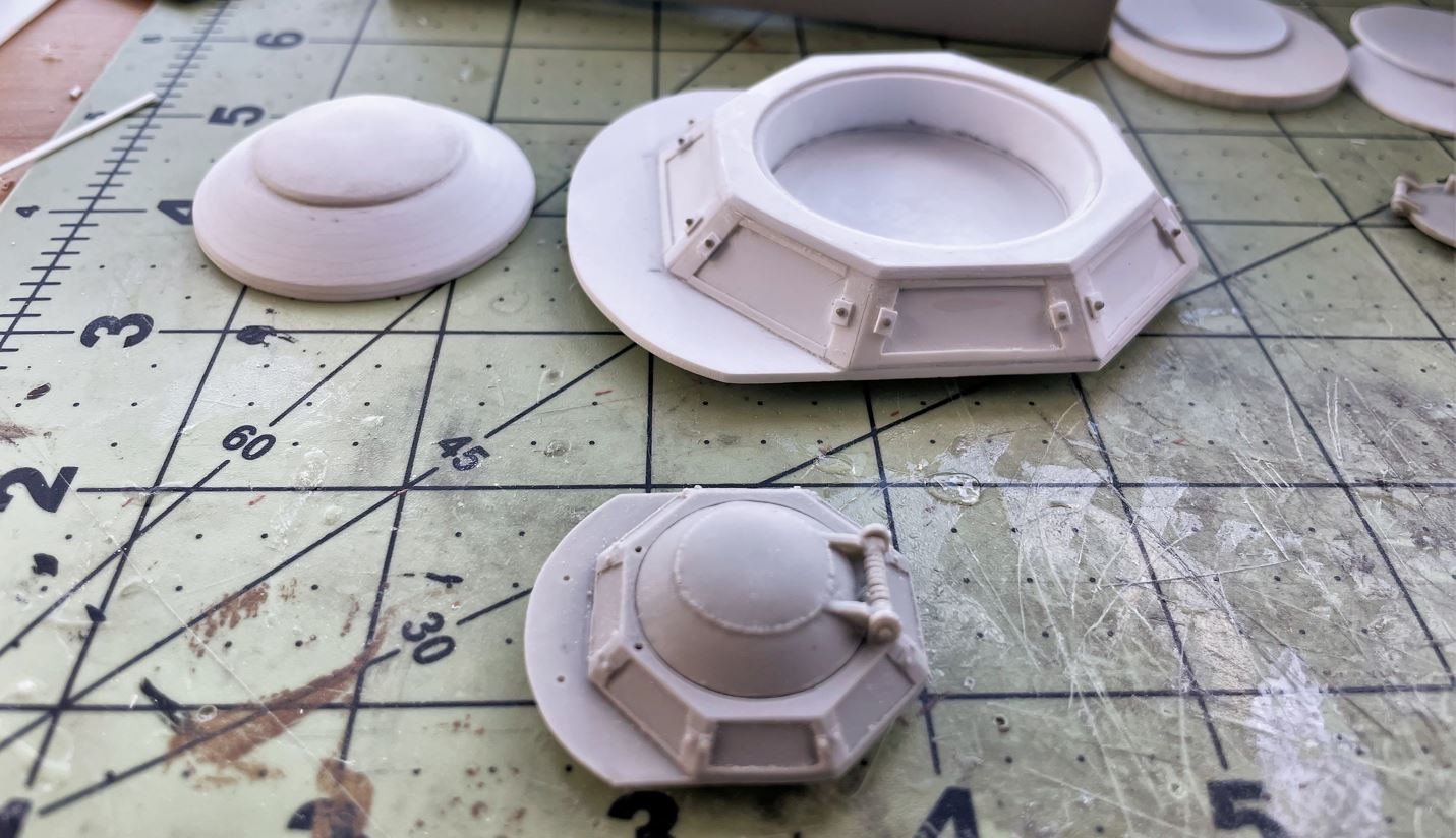

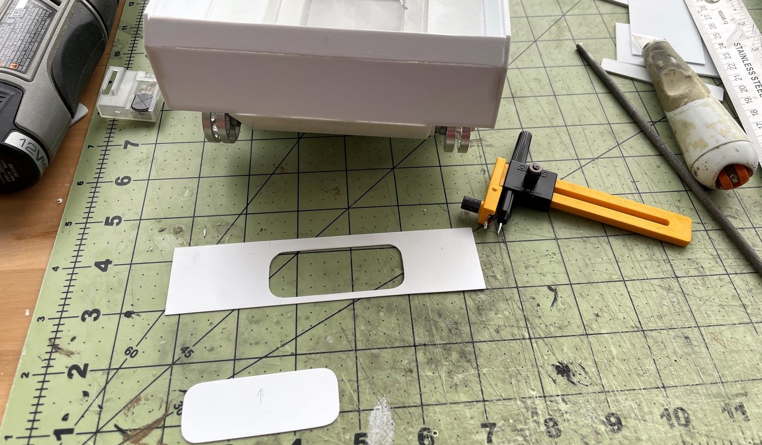

First task was to create the rings and hatch material for the 3 hatches, done with a roundel making tool with plasticard of various thickness.
Rings for the commander's cupola and hatches are installed. Notice the two level deck.

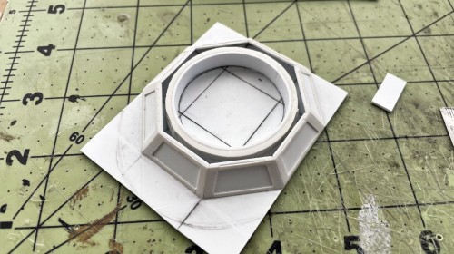

Basic shape for the M26 cupola is drawn.
The creation and assembly is done in steps.
The cupola was not given an interior due to lack of available reference.
The interior will be painted black and will have a commander's figure.
At this point, the frontal platform for the Browning stand is left larger than it should until i have investigated the situation further. I see a lot of differences between the 1/35 kit and some pictures on the web on the size of this platform.
