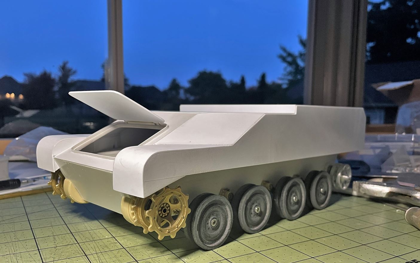

The large frontal hatch is installed with working hinge to access the motors and drive shafts inside the hull.

Now i have a sealed hull. Other than building the tracks and test the integrations, the model needs a lot of details that will take time to build one after another, but it is mostly cosmetics, no more major technical design challenges.

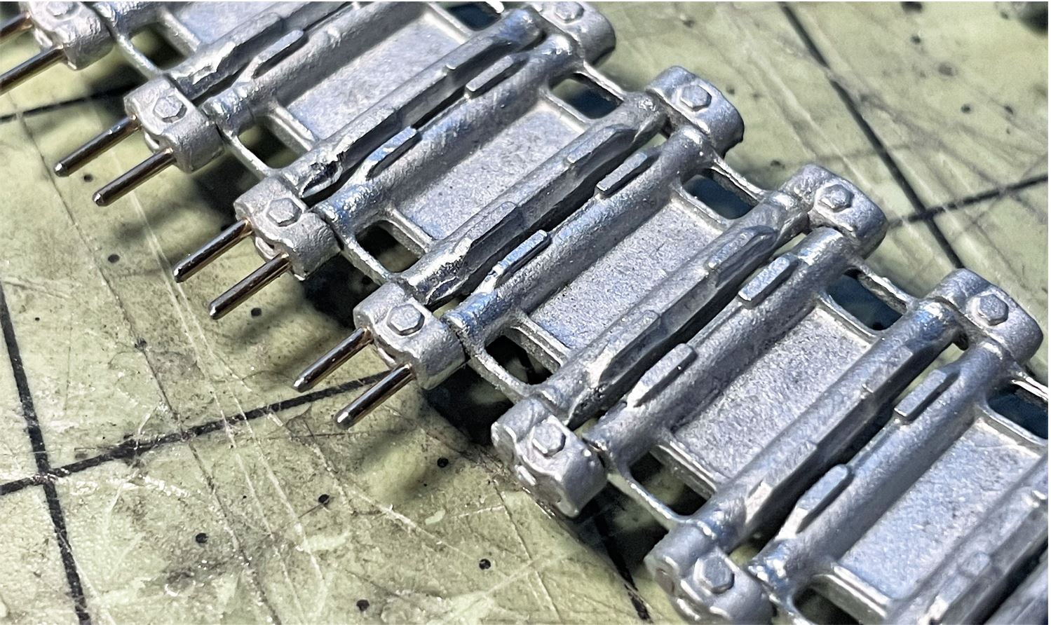

Starting to build the tracks.
First the pins need to be prepared by removing one of the end point. Looks like the end points were molded on the pins. It takes pliers in 2 steps to remove them.
RC 1/16 M113 Lynx Command and Recon tank - build
Every links and pin attachment points need to be sanded and polished for a smooth operation. You can see the bleeding on the mouldings below. This is pretty hard metal to work with. It just takes time.
Then assembled but without the rubber pads at this time. The tracks need to be built very tight, the end point is hammered on the pins but use of many pliers is required, sometimes i need to go back and reapply pressure to squeeze each connector, then file again. If the track pins are too loose on the links, the tracks will work badly. Some few links are also smaller than others by 0.5mm for some mysterious reasons. Because i think i will have many extras, the short ones are discarded.

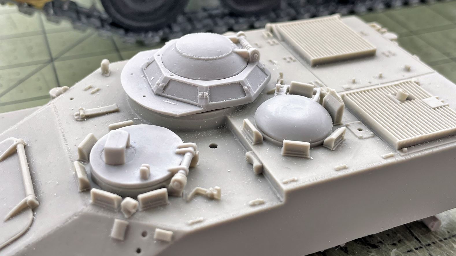

On the Canadian M113 Lynx as shown on the 1/35 kit below, the commander's has an M26 cupola, manually traversed and armed with a M2 Browning heavy machine gun installed on a flat platform in front of it, and fired from inside the vehicle. To reload, the commander has to open the hatch. The observer has a regular M113 commander's hatch and fires a rear facing pintle-mounted Browning 7.62mm machine gun. The driver has a regular M113 driver's hatch.
The M26 cupola offers good vision with all around periscopes. Notice the turret axle of rotation in comparison to its base. I have not seen this before.

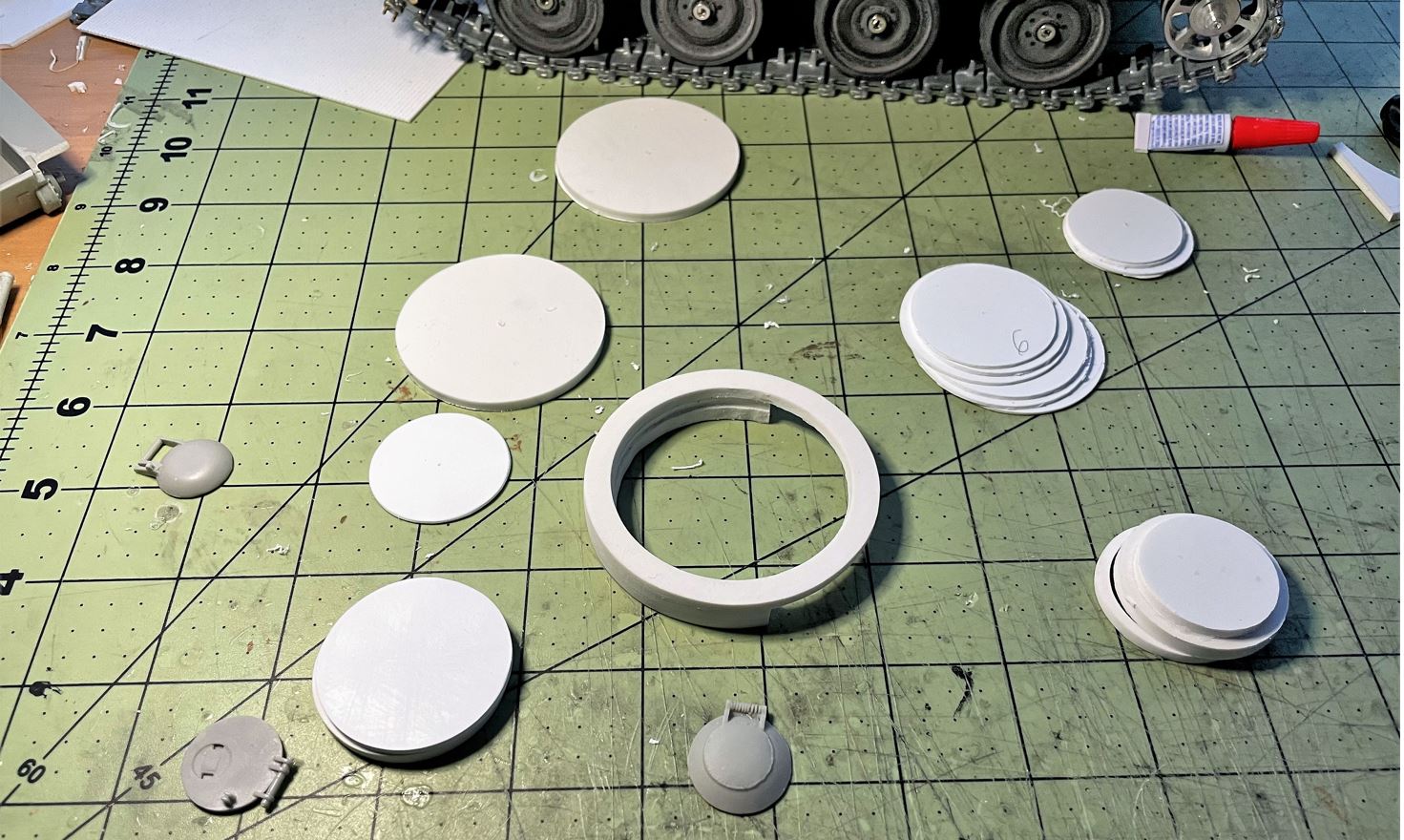

First task was to create the rings and hatch material for the 3 hatches, done with a roundel making tool with plasticard of various thickness.

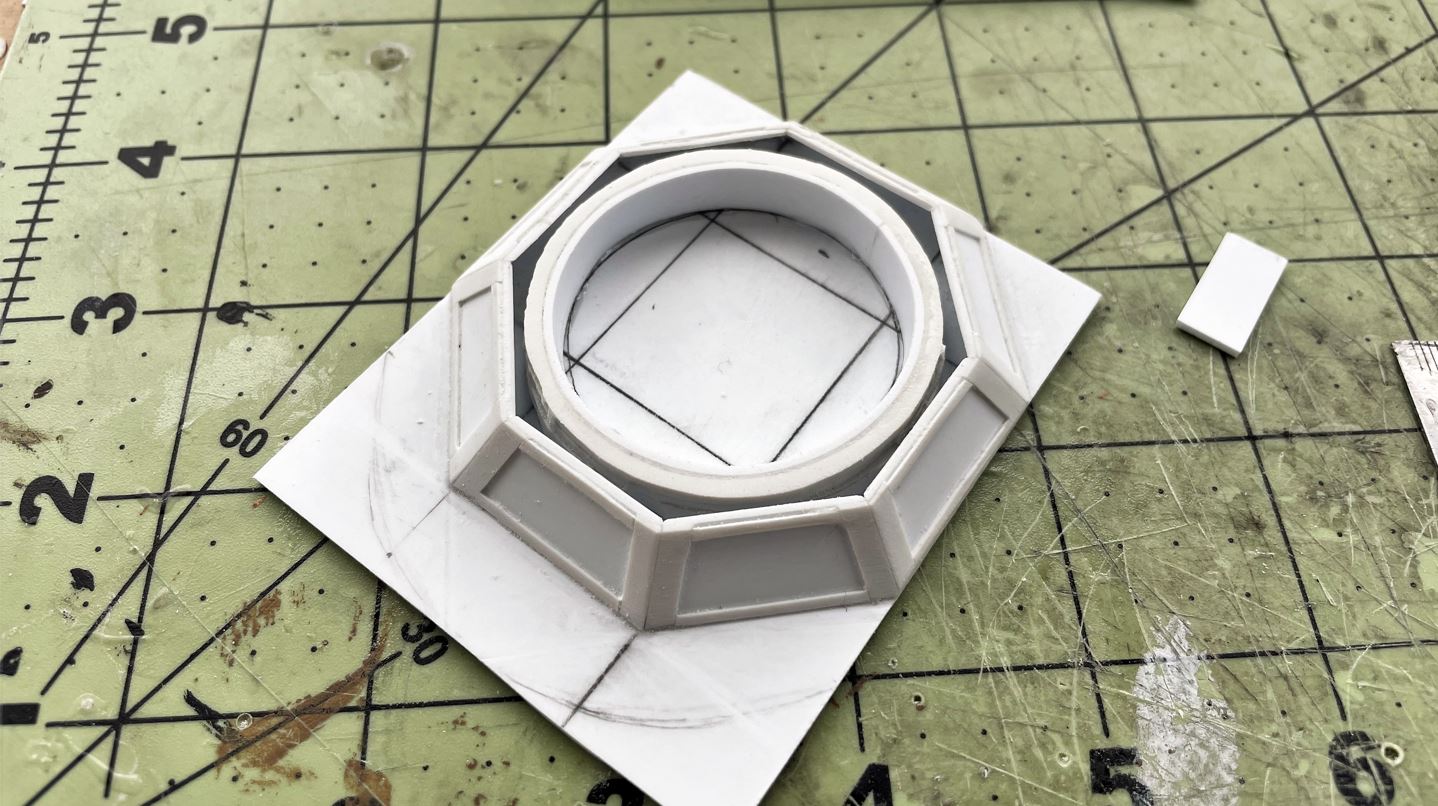

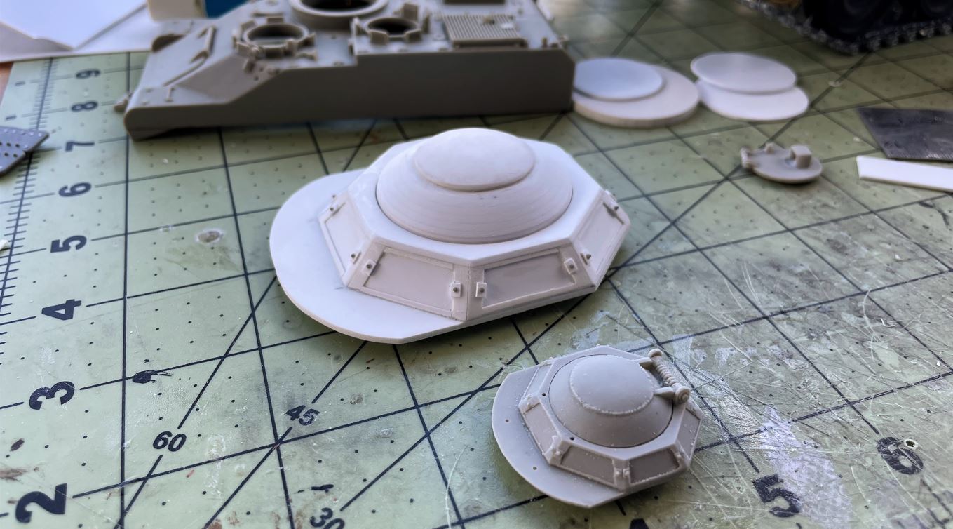

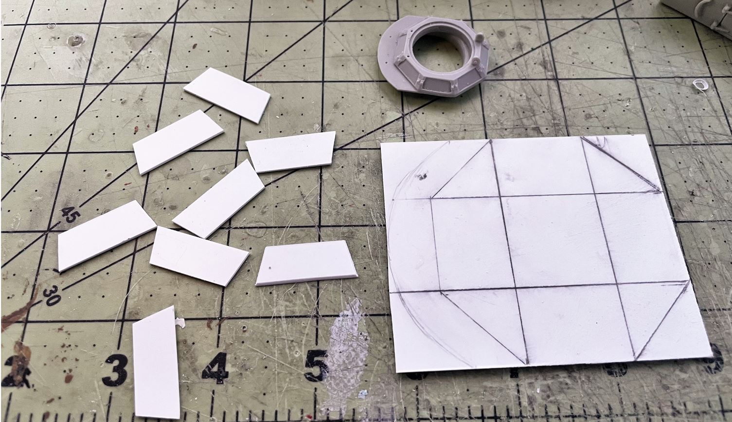

Basic shape for the M26 cupola is drawn.
The creation and assembly is done in steps.
