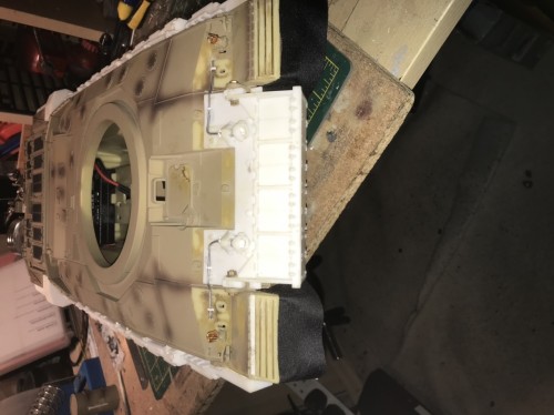

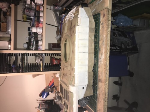

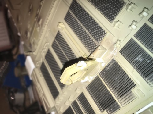

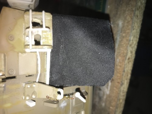

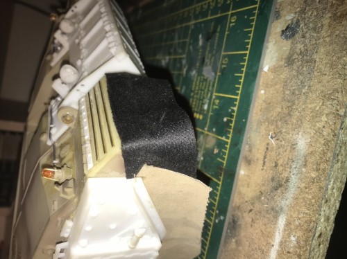

Small update on this build. An unexpected day off work has allowed a bit of work to be carried out today.
Indicators, conduits to headlights, and front mud guards fitted.
Front mud guard
Front mud guard
Side dust skirts
Side dust skirts
Working  gun lock with a bit of detail added
Rear mud guards
Rear mud guards
Went to the trouble of making the gun lock open as well. Then found I had glued it together. I need to find some small nuts and bolts and make the little plates that join the skirts together, and make the plates that hold the mud guards in place.
Your thoughts and criticisms are welcome.

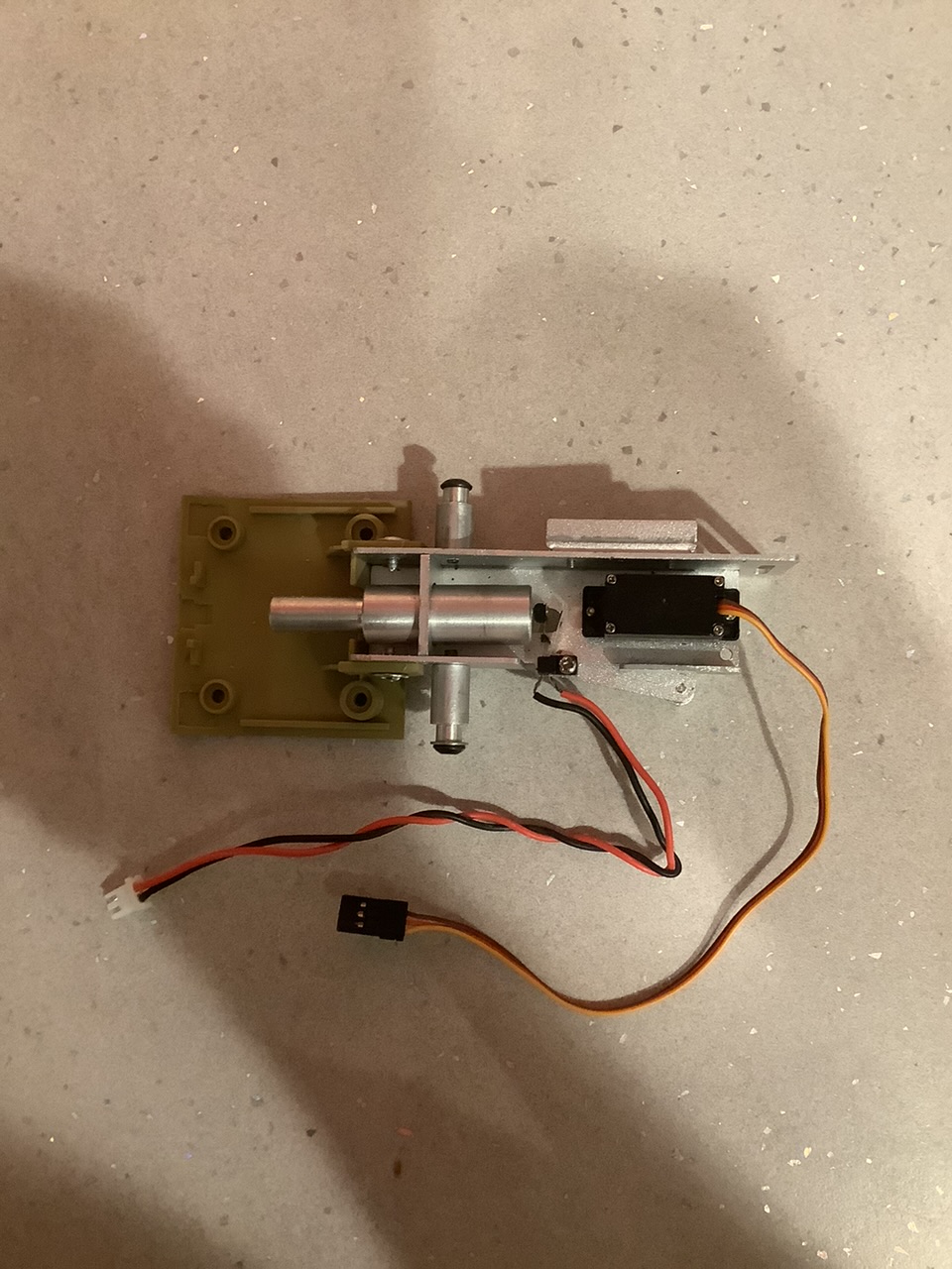

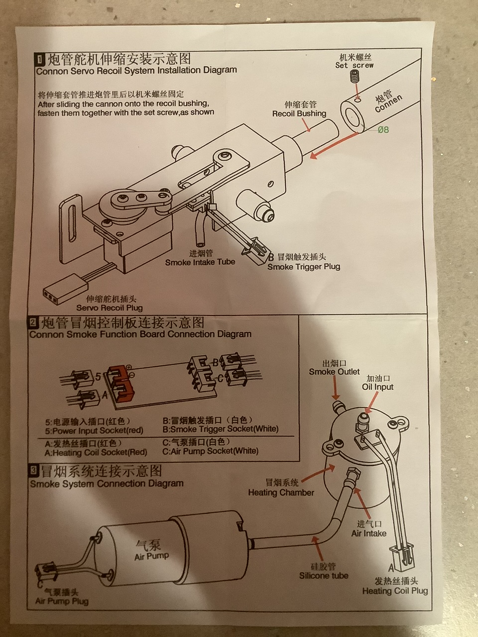

I also have this recoil mechanism from Dave at Forge Bear, but I’ll be blowed if I can get it to work.
Any help on getting this wired, would be helpful, if is anyone has installed this type of recoil? Or have I cocked up and should have purchased the cannon smoke as well? I will also post in Heng Long electronics.

The tri-colour cable should go into CN7 in your 6.1s board. That will energise the recoil.
viewtopic.php?f=1&t=30105
The 6.1s wiring layout is in here too.
The cable that runs from the microswitch is redundant unless you are running the barrel smoke system.

I tried it in CN7.
Servo works fine in the gun lifting port, so the servo is good. Plug it into CN7 and there is a small amount of movement on plugging in then nothing. I am thinking it might be a faulty board.

by HERMAN BIX
Try plugging it in the other way round. I cant remember which way/side the yellow & brown wire should go.
It will fit both ways as there is no 'key' to orientate the servo plug.
Its got me before too.

by HvyCgn9
with that servo lead brown is the -ve I have run those type servo lead colours in my ships. middle lead is +ve, yellow is signal
cheers Bruce

Thank you all for your help. I now have a working recoil. As stated by Mr Bix it need a jumper wire in CN6. That could be something they put in the instructions. >:<
