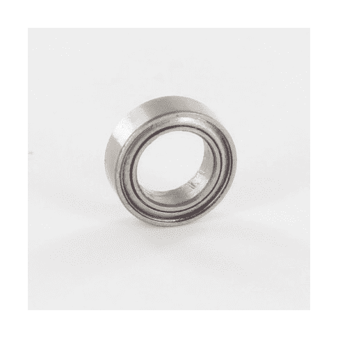

following my many questions for drilling the pebbles of the Sherman Tamiya? I found this, fried bronze rings, the right dimensions (5/8/10) there is a slight clearance? but think of sticking them to the cyano, think that will be superior to the plastic rubbing on metal ?? what do professionals think?

Yes - 'sintered bronze bearing'.

Bushes are the very best alternative to bearings, material wise for humble modelers brass/bronze is the most available, but engineering wise there are a range of materials out there which are better for what we may need, but do not have off-the-shelf convenience ,like Orcot and Nylatron.
Rule of thumb is to make the easiest replaceable part to be the one that wears, rather than the part thats harder to obtain or replace.
