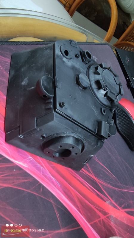

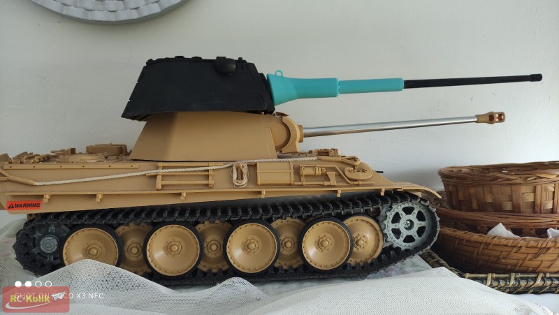

I printed a Panther F turret and next is the design of mechanical parts.
I am looking for dimensions/cad drawings of Tamiya Panther turret ring gear.
Can anyone help?
Jofaur86
Posts: 2205
Location: Centre France
Re: Tamiya Panther restoration questions
Post by Jofaur86 »
Jagdpantherx wrote:I printed a Panther F turret and next is the design of mechanical parts.
Can anyone help?
You have them there. All you have to do is unscrew the vent on the rear of the engine deck, that holds the upper hull in place, and slip it backwards off the lower hull. Or, simply turn the turret through 120 degrees, or so, left or right (assuming the barrel is facing directly forwards), and carefully lift the turret out of the two slots used to fit it.
There's probably a Tamiya Panther PDF. manual available in the Downloads section here.
edit. yes, having just checked, there is a Tamiya Panther manual in 'Downloads'. 'Downloads' is at the end of the top main menu bar. It should help.
