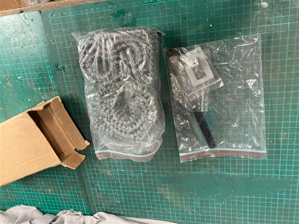

O I see, do I need anything for the rear of the upper deck to lock into the lower hull?

There are two smaller metal items. One is seen on the left.

Post by Topper »
Thanks again
I think I will have all the parts

Yes you do. It all comes with a new lower hull.
Mind you the system was designed for the early HL upper hull with a single post at the front. The later hulls come with two posts. So you need to make the plate flat and then screw through the plastic with a countersunk screw. Then some filler on top.

Here’s some photos of “Ol’ Ugly” (my pet name for my beloved Initial Production Tiger).
It shows the metal tab that must be attached to the HL upper deck and slot in the Taigen lower hull. The metal tab is screwed and glued.

Your pics are a great help!!!! Does the screw go from the inside out or the outside in?
