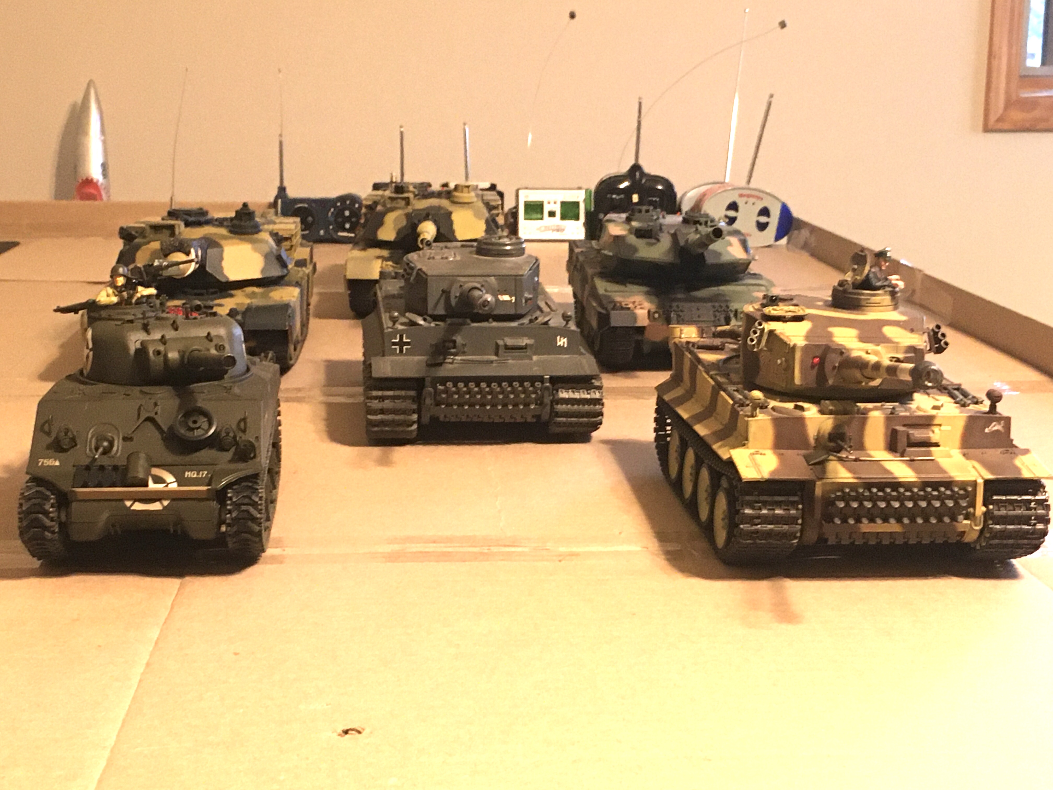

Short video showing the defeat of the Sherman
https://www.youtube.com/watch?v=kpHK-JRb500
Short video of the Tiger out of ammo but moves forward to stop the Sherman
https://youtu.be/1xqe_eiXddQ
All of these are 1/24 HL compatible Battle Tanks
