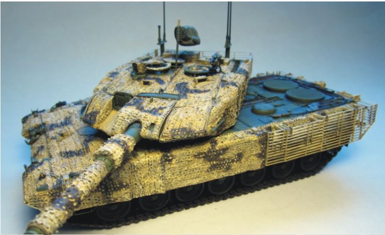

While I am waiting for electronics and other mechanical parts to arrive, I've been doing some test work for the 1:10 scale Saab Barracuda mobile camouflage system.
Before fully committing to the conversion, which will involve cutting up parts of the turret etc (the point of no return), I want to make absolutely certain that I have a scale solution for the camouflage.
I have a quantity of the vinyl garnish which was cut to about 1:10/ 1:8th of the real materiel. Simply draping the vinyl over the tank will not accurately replicate the camouflage system.
The Saab Barracuda mobile camouflage is made from a number of components to form tailored panels that are attached to the tank by large strips of Velcro. The underside of the panel is a made from a material that is designed absorb heat and reduce the tank's interior temperature. This material is covered in tough vinyl and garnish is stitched to the vinyl layer.

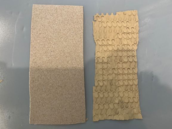

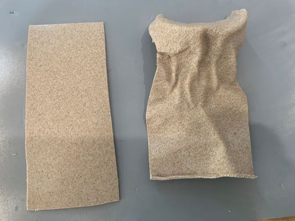

To replicate the camouflage accurately, I am using a 1mm thick thermoplastic sheet. This sheet becomes highly malleable when heated. This will be used make the individual panels that cover the tank. Because the sheets can be molded to tightly conform the shape(s) of the tank, the final result should look like the real thing.
Thermoplastic before and after heating

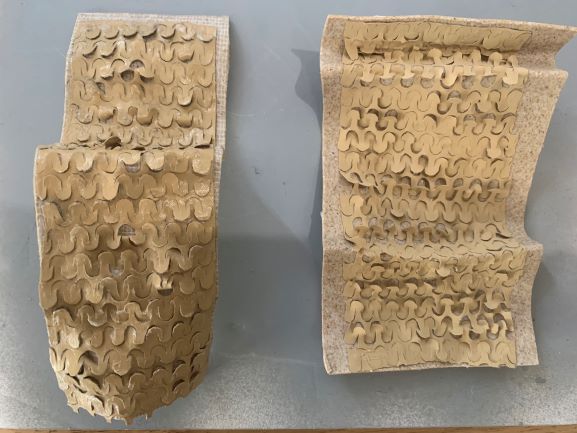

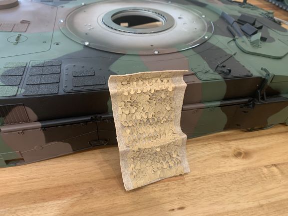

It took a couple of goes to figure out the best way to attach the garish is a realistic way. I am using Mod Podge Matte (a highly tacky pva glue that dries clear) to glue the garnish to the thermoplastic sheet. In the first attempt I covered all the garish in glue on both sides. This resulted in something looking like fish scales - fail!
Attempt 1 is on the left - the garnish is too flat and looks like fish scales. The second attempt is right on the and is beginning to look more realistic.

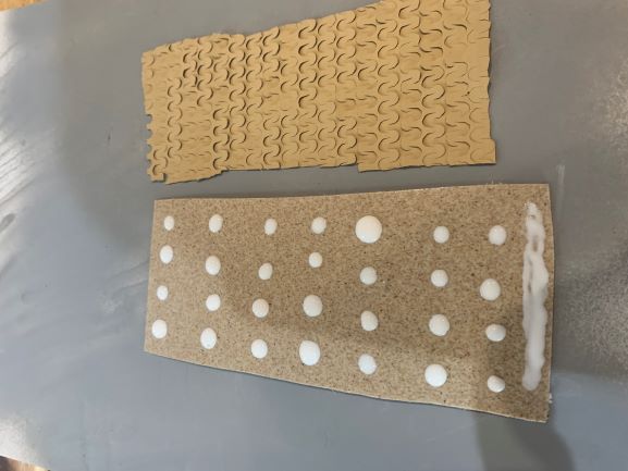

The following pictures show how I finally attached garnish to the thermoplastic.
Blobs of Mod Podge.
Blobs of Mod Podge.

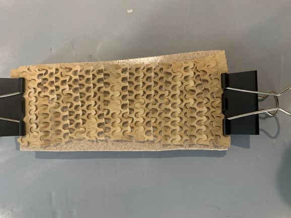

Fold back clips are used hold and stretch out garnish
The final result on the right
Final test piece - the scale effect will quite good.
