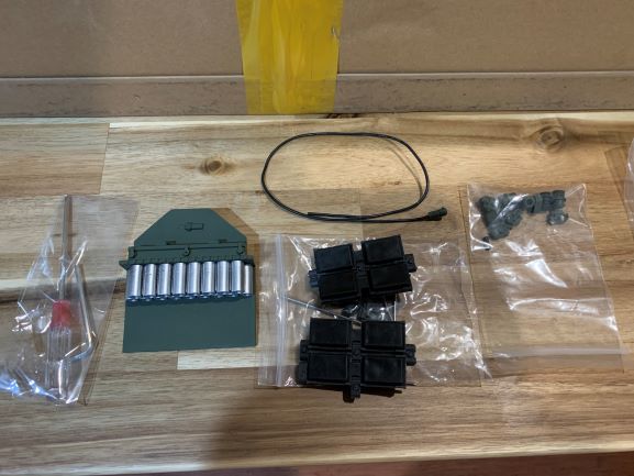

- Once again, great packaging.
- 9.JPG (44.88 KiB) Viewed 6737 times
- Despite the careful packaging, the MG3 was broken
- 8.JPG (39.74 KiB) Viewed 6737 times
- Screwdriver, Allan key and detail parts
- 7.JPG (44.46 KiB) Viewed 6737 times
- Separately boxed TX - looked encouraging at the time of unboxing....
- 6.JPG (45.24 KiB) Viewed 6737 times
- The packing was very good
- 5.JPG (40.26 KiB) Viewed 6737 times
- Always amusing translations
- IMG_0303.JPG (44.2 KiB) Viewed 6737 times
- Unboxing and Instruction manual
- 2.JPG (32.49 KiB) Viewed 6737 times
- A Big Very Sturdy box
- 1.jpg (39.19 KiB) Viewed 6737 times

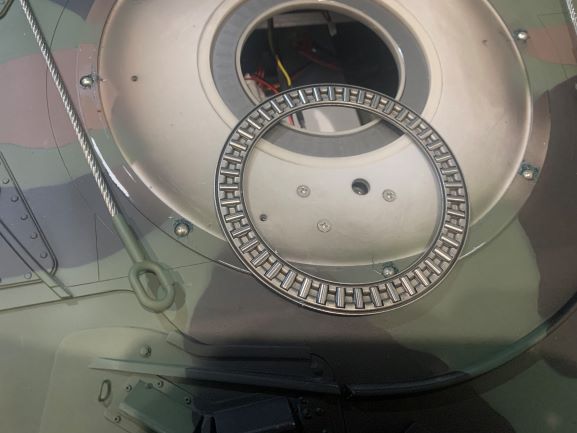

- Impressive roller bearing turret race
- 29.JPG (33.6 KiB) Viewed 6733 times

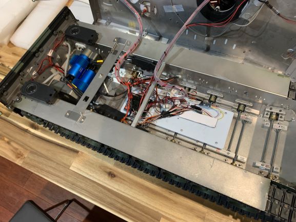

- Lower hull
- 26.JPG (56.21 KiB) Viewed 6733 times
- Under the hood
- 20.JPG (51.66 KiB) Viewed 6733 times

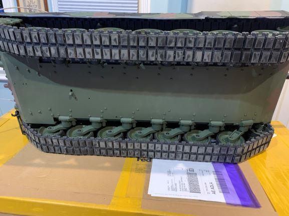

- Belly showing upper-hull release knob. Tracks are nylon. Road wheels have rubber tires.
- 18.JPG (44.57 KiB) Viewed 6733 times

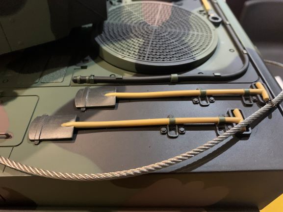

- Tools - molded tool holders - not unexpected but will replaced during the re-build
- 17.JPG (39.12 KiB) Viewed 6733 times

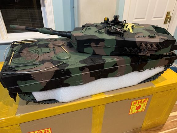

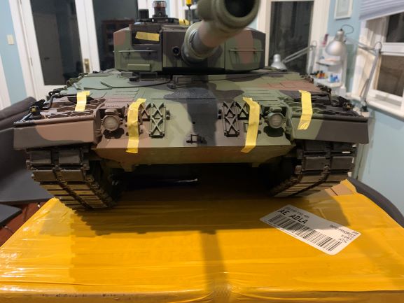

- Front view - the upper hull has a slight warp
- 16.JPG (43.3 KiB) Viewed 6733 times

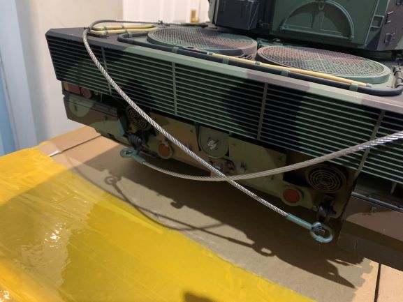

- Tow ropes are stainless steel wire
- 15.JPG (44.2 KiB) Viewed 6733 times

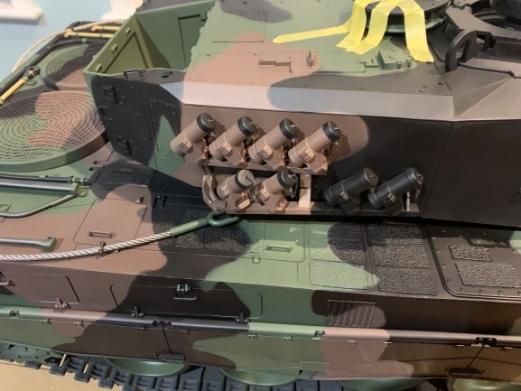

- Detail of the smoke dischargers
- 14.JPG (46.27 KiB) Viewed 6733 times

Turing to the model itself, this was in all respects a pleasant surprise.
- The overall detail is good and better than I was expecting. Out of the box, it is an impressive model and certainly not "toy-like". Many will be quite satisfied with level of detail "as is". For me the pleasure of this hobby is in the build, and aside from a complete type conversion, my plan is to make very most out of the huge canvas an add as much extra or improve detail as I can.
- In my opinion the construction technique used Hooben is quite clever. The entire lower hull, less the rear is formed and welded stainless steel. The torsion bar suspension is all very securely screwed in place. The torsion bars themselves and made from 3.5mm rod.
- Swing arms and road wheels are molded nylon. The road wheels have separate rubber tires. At the time of writing I have not disassembled the road wheels see what the axles are made of or what bearings are used.
- The idler and drive sprockets are metal. A track tensioner forms part of the idler assembly.
- The tracks are molded nylon with rubber track pads. Double track pins, as per the real tracks, hold the links together. The track horns or guides are separate pieces, again, as per the real tracks.

- Many detail components are molded separately and held in place by pins and friction! This is in contrast to the metal parts which are screwed in place and secured with a Loctite type paste.

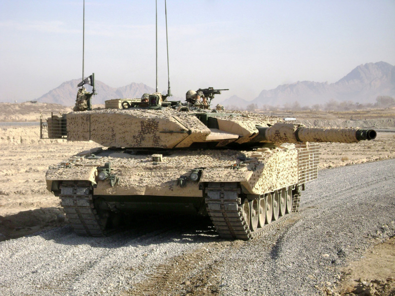

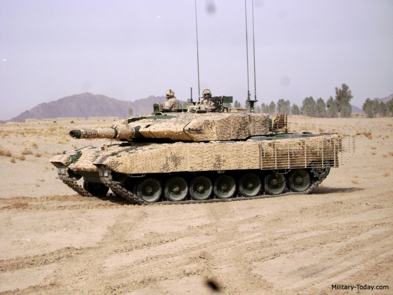

I will convert the model to the 2A4M CAN as deployed to Afghanistan by Canada in 2011/12.

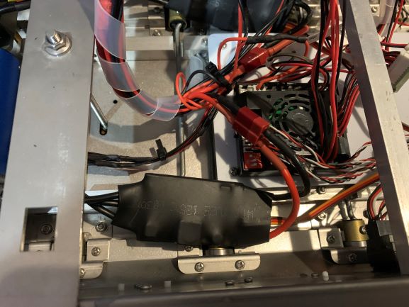

The 2A4M CAN is shown below. At the moment I expect that I will make the conversion in two steps.
1. Strip out all electronics, less lighting and replace them with a complete set from German SGS Electronic (https://www.sgs-electronic.de/). This will include barrel stabilisation and wireless connection between the hull and turret. Test new electronics etc
2. Model conversion work, starting with the hull and working up to turret.

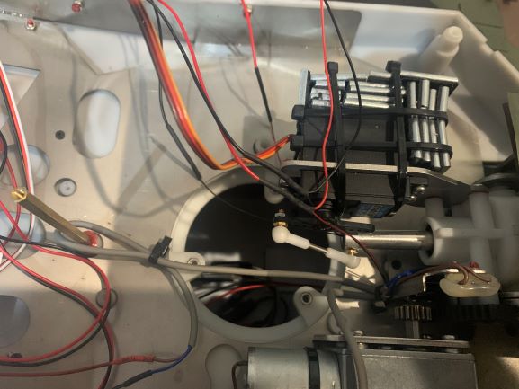

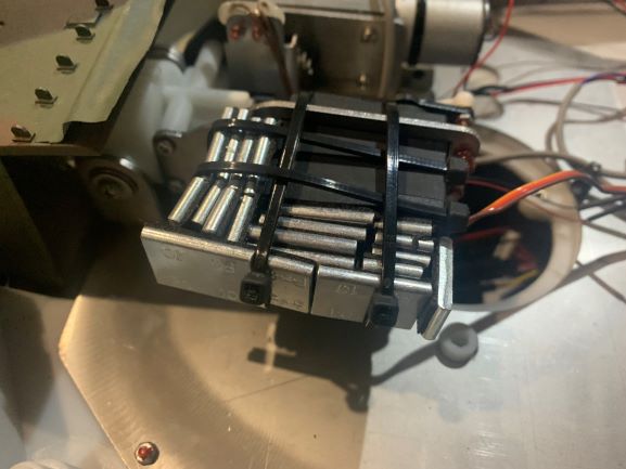

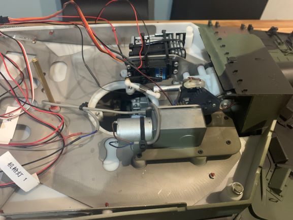

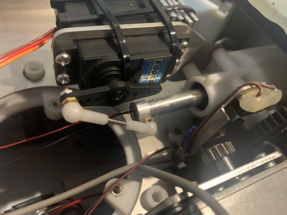

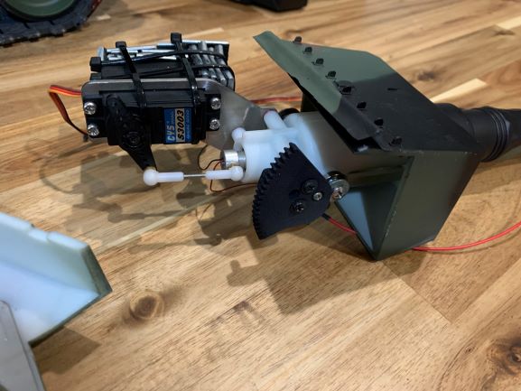

A little bit of progress. I need to remove the barrel elevation drive motor supplied and replace it with a servo. The electronics that I plan use have barrel elevation features that will only function with a servo controlling barrel elevation and depression.
To remove the motor has meant removing the barrel and stripping the turret bare.
The elevation drive is identical to the turret drive, which I have also removed from the underside of the upper hull. This will be re-installed in the turret so that there is no wiring between hull and turret.

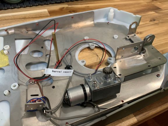

Some of you will have seen that various wiring harnesses have been labeled by Hooben. This would be useful if the labeling was correct.
In the photo below you can see that the wire is labelled "barrel elevation". In fact this is the barrel elevation drive.

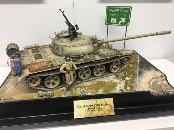

Hi thanks for your positive comments. One of the reasons I'm here is because I know this will be a tricky and at times frustrating build and from time to time I will need encouragement to keep at it
(BTW did you mean Iraqi T-55A or are you confusing me with someone else?)
