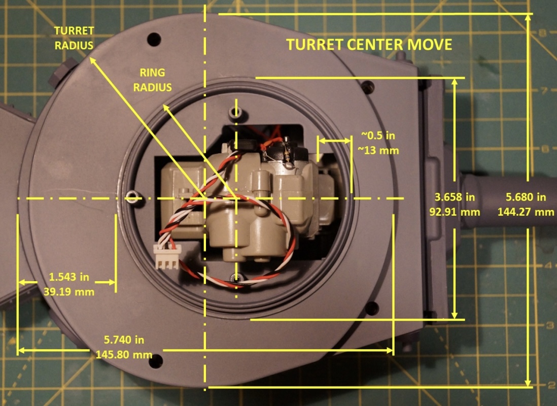

Jofaur86 wrote:Hello :D
Personally, I would have preferred, that someone told me if interesting, known, or not? I just wanted to share an info, issued from a French forum
Have a good day :thumbup:
Of course it is interesting and it pleases me that you found it and showed it to us,
I only suggested that if the measurements had been 1/16 then anyone interested in having an accurate Tiger 1 Body could print the drawing and use the drawing as a template over an existing Tiger 1 Body without having to convert the dimensions provided in your picture BUT you have certainly made the conversion much easier for which I am grateful :thumbup:

quitcherbitchen wrote:Just so I understand what is going on. The Turret on the HL is in the wrong place?
For many years Heng Long and Taigen have insisted that they are not connected in any way and yet both company's Tiger 1s duplicate the radio aerial stowage on both sides of the engine bay whereas Tamiya get it right and yes both Heng Long and Taigen have the Tiger 1 turret in exactly the same wrong position and yet again Tamiya get it right and then there is the Panzer 4,
Both Heng Long and Taigen have the engine bay silhouette wrong to exactly the same degree and Tamiya has it right,
Does anyone still think this is all coincidence.
if we in principle that well centered of origin? during the rotation, we quickly perceive which is offset, hence this diagram to make the modification, of course it is necessary to reinforce the underside after cutting by gluing of plastic bands. Attach the link on RC Groupe forum, which will be appropriate can better for understanding and with dimensions in Inches
https://www.rcgroups.com/forums/showthr ... ads-of-Pix

Jofaur86,
I've found this post most interesting. As Sir Jarndice has noted, Heng Long and Taigen brands are pretty much one and the same (I've always had my suspicions). I've also always thought that my Taigen Tiger 1 turret placement looked off by just a bit. It appeared too far forward by just a bit. I never bothered to validate that; but bingo, here's this post! Nice to know; that since staring at pictures of Tiger 1's since I was a young boy, some small bit of info stuck in my gray matter for all these years! :/ :haha:
