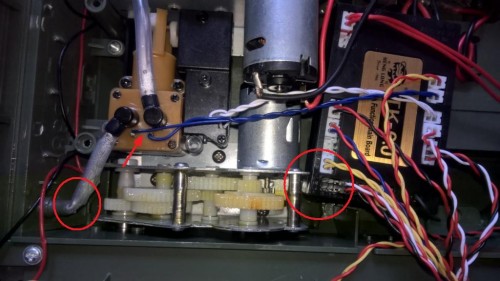

Hello Dai
The cables that you ordered have only JST XH plugs. I can't see in this cable set any black 2.54mm 2 pin plug for LED's. I also see there an 8-wire JST which is not needed in the 6.0/6.1 MFU version. But that's even better. If you buy a few white JST 2 PIN plugs - you will be able to disassemble this cable and build 4 sets (extension cords) with 2 wires.
My advice. Try to build a connector ( and extension also ) that will allow you to quickly and easily disconnect the wires from the upper hull ( slip ring ) and MFU. Take a look here:
viewtopic.php?f=79&t=30884
And last thing. As I told you before - you should to like playing with a soldering iron and multimeter :)
This will make your life much easier in the world of RC tanks :)

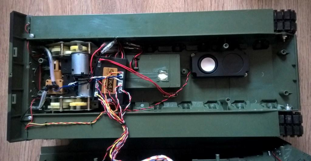

dai phan wrote:The wires are so short that they pull the MFU to the turret causing massive binding. As such many wires are ripped out so I spent hours trying to put them back. The 6.0S MFU is fried so I had to borrow a 6.0 MFU from a T90. For 3 hours I have been trying to get the turret turning 360 w/o binding but most I get is 120. I wanted to move the MFU toward the front but the wires are too short. HL just stuffs things in there and if they bind, then tough it. Such pathetic poor engineering. I paid extra for the 360 rotation but now I barely get 120. Dai
I can see right away that your MFU is in the worst possible place. It was not supposed to work directly under the ASG / recoil ... As for the cables and the MFU mounting point, see how tight it was on my son's Leopard.
This place for the MFU is a bit better than yours because the ASG system and the tower cables do not touch the MFU, but the smoker cables were stretched to the limit. Moving the MFU to the front of the lower hull is a good solution to your problem. You can also try mounting the MFU vertically between the battery compartment and the side wall of the lower hull (but I don't remember if the cables will fit). Or you can cut out the battery compartment completely and seal the bottom of the lower full . This will give you a huge amount of space for arrangement (especially if you plan to upgrade your model to the hobby grade standard).
