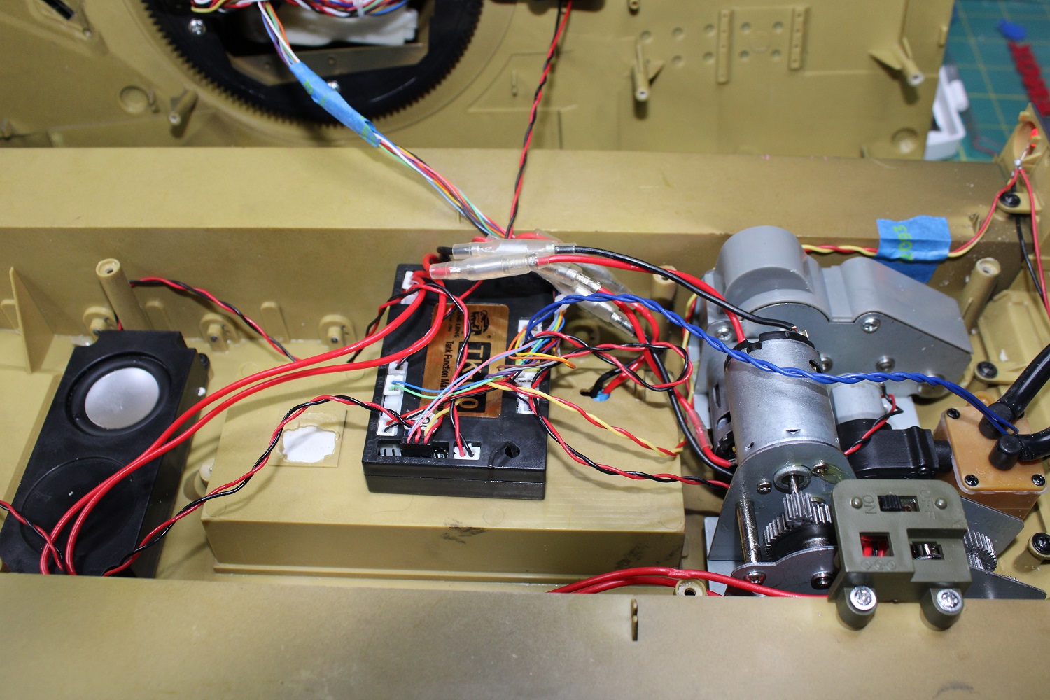

Got the tank yestersday. No body/barrel recoil, no cannon lifting. Turret could not do 120 wihout catching. Wires inside is tight like piano wire and stripped by a slight touch. Complete mess inside. 300 bucks down the drain. Nuff said! Dai

The wires are so short that they pull the MFU to the turret causing massive binding. As such many wires are ripped out so I spent hours trying to put them back. The 6.0S MFU is fried so I had to borrow a 6.0 MFU from a T90. For 3 hours I have been trying to get the turret turning 360 w/o binding but most I get is 120. I wanted to move the MFU toward the front but the wires are too short. HL just stuffs things in there and if they bind, then tough it. Such pathetic poor engineering. I paid extra for the 360 rotation but now I barely get 120. Dai

Hi dai,
Sorry to hear of the problems with your new purchase, you will find though that a lot of the heng long tanks are the same regarding the wiring. As a 'toy grade' tank that heng long deems it to be they do not consider the purchaser opening it up regularly as we do with our tanks and that is why they have the battery box access underneath so it's easy to get to without opening the main body and pulling on the wires. The newer heng long boards have a lot of separate plugs for the different functions but on the older boards there was just an 8 pin plug running to a separate daughter board to power the turret functions, you can buy an extended version of this cable which relieves some of the strain off the cables when opening it up. Unfortunately though as yours does not come with this type of cable you may have to make some for yourself which shouldn't be a big problem if you can get the corresponding plugs etc and a soldering iron, welcome to the Joy's of tank upgrading

The only way to solve the binding turret is to lengthen the wires and then move the MFU all the way foward. Then tuck the wires on the side. The way it is set up is disaster on the way and it did. The binding turret rips wires on its way even damaged one of the connecting (CN4) plugs making turrret turning impossible. I had to borrow a MFU from my Sherman. Just cheap enginnering. DaiModel Builder 4 wrote:Hi dai,

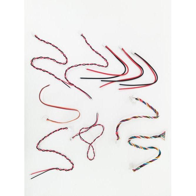

Hi all,
Just ordered couple of wires set from Taigen so I can move the MFU to a better location. Dai
