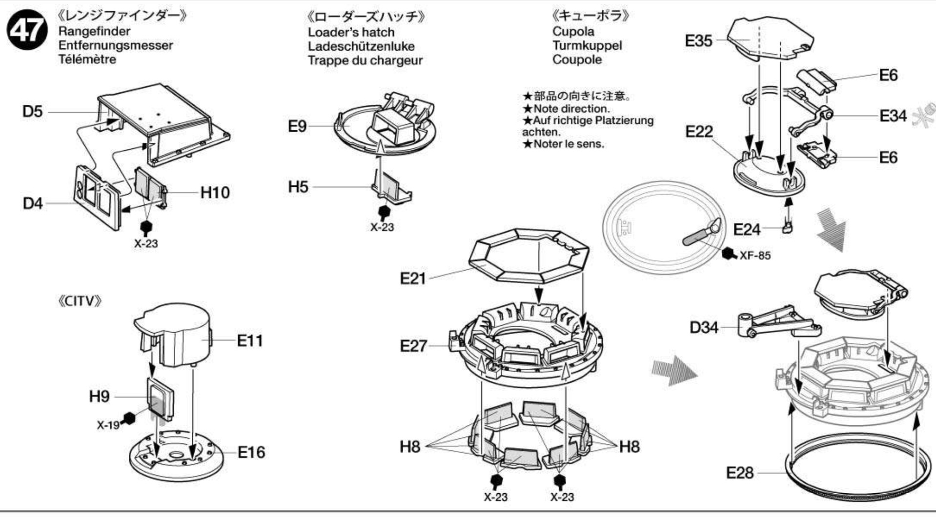

The ones shown in the Abrams pic, above, look very impressive, but in the manual, X23 (Clear blue) and X-19 (Smoke) are cited as the paints used on the visions blocks and periscopes...
Tamiya Abrams vision blocks
(Click to ENLARGE)
It's difficult to see how the apparent 3-D depth of the blocks in the photo can be achieved simply using two flat colours. :problem:
Just curious, that's all. :)
Posts: 7594
Re: Best way of simulating periscope lenses?
Roy, they'd be XF 23 and XF 19 if they were flat colours.
