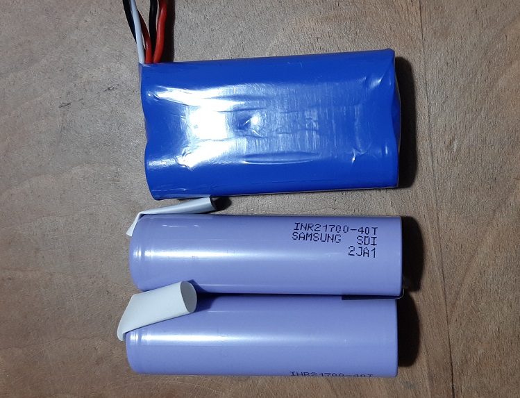

Personally, I opted for 21700. 21 corresponds to the diameter, 70 to the length of the elements. More autonomy for a format barely bigger, that suits me! On the NKON site, you can ask to have pre-welded metal legs, which prevents the elements from overheating.
(in the photo, a pack of 18650 with the 21700)
If anyone is interested, here is the link:
https://eu.nkon.nl/samsung-inr21700-40t ... h-30a.html

If you put together two of those will it be 4000mAh? That’s a crazy number for that size.

Yes, you get a 7,2V 4000 mAh battery. Really good for the seize :thumbup:
