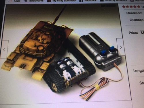

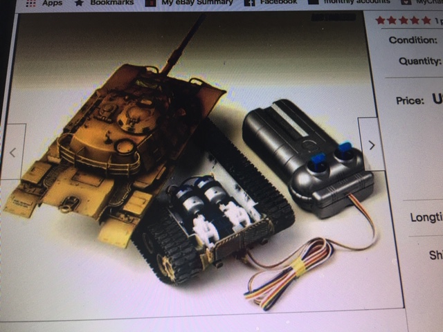

So that Tamiya type 10 would be a Scale Model to motorized RRC using the gearbox shown in the picture? Looks like it physically fits the chassis. Could you do a side shot of the axle coming out of the chassis?
Here is a ebay link for the motorized remote control M60 A1
https://www.ebay.com/itm/Academy-1-35-U ... SwUKxYiKmP
The M60A2 13296 kit you mention is not motorized. For a few dollars more you can get the motorized M60 A1,
Can not beat this Academy M60 A1 for the money.
jimbo_wa
Posts: 380
Location: Cambridge, UK
Re: Tamiya 1/35 M60A2 motorized RC 1974 vintage >RRC
Post by jimbo_wa »
modler wrote:So that Tamiya type 10 would be a Scale Model to motorized RRC using the gearbox shown in the picture? Looks like it physically fits the chassis. Could you do a side shot of the axle coming out of the chassis?
Correct, I needed to cut off the mounting tabs and it's just resting on some Blu-Tack at the moment.
My plan is to create a solid mount for the gearbox and fill the drive sprockets with epoxy, before drilling the shaft mounts.
It works well in my head anyway... Image
Sent from my Pixel 2 using Tapatalk

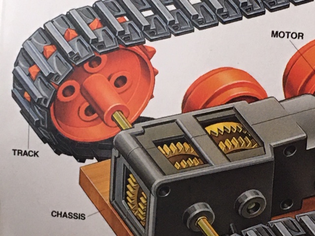

Yes the position of the drive axle will work. This is a critical factor. the hexagon shape axle requires some thought on how it can be interfaced with a drive sprocket in some fashion that is not too hard to implement and is repeatable.
this is how tamiya does it
I bought one of these to see if it had potential and to check how hard it would be to interface drice sprockets to the hexagon axle

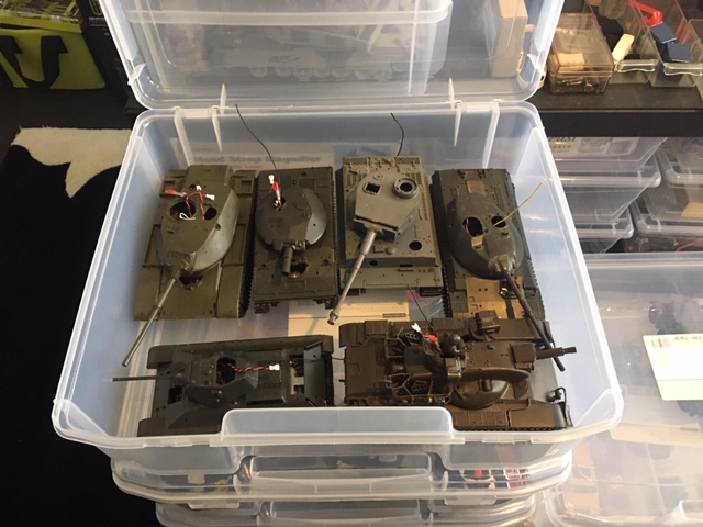

Yes I often buy models as donors for others that I like better.
Have not finished the M60A1 yet. It has a very smooth Academy plastic gearbox that is geared a bit higher than the Tamiya metal gearbox so it is a bit faster in the stretch.
These all run very well.

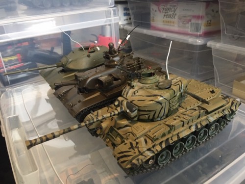

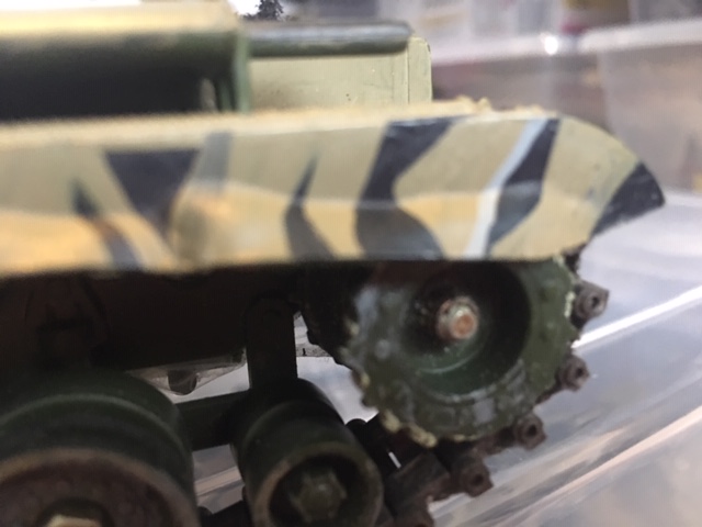

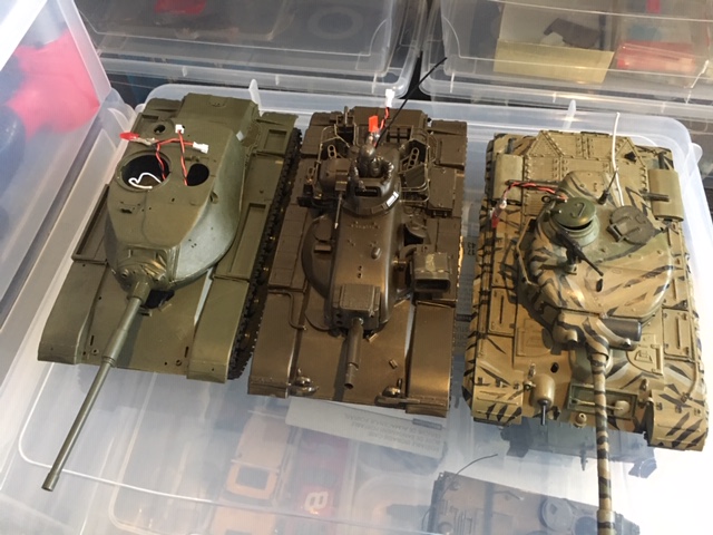

Drive sprocket of the M48 with the Tamiya plastic gearbox.

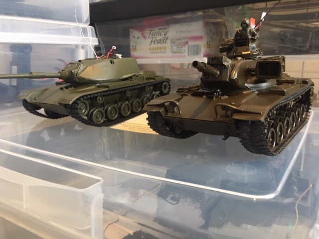

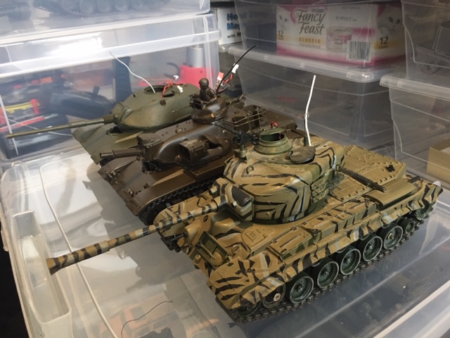

M60A1,M60A2, M48.
M60A1,M60A2, M48.
I bought these storage cases for my 1/35 model tanks recently and it greatly simplifies storage and protection of my prized models.
