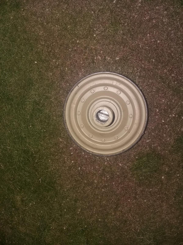

Info road wheels metal tiger1 torro
General Jumbo01
Posts: 1780
Re: Info road wheels metal tiger1 torro
Post by General Jumbo01 »
I suggest you take it to a RC model shop and pay them to fix it.
Last edited by General Jumbo01 on Mon Oct 28, 2019 10:26 am, edited 1 time in total.
john1970
Posts: 392
Post by john1970 »
Came unglued by the look of it the silver part is the end of the axle shaft
General Jumbo01
Posts: 1780
Ah, yes. The magnet has come unglued so the never used late B| wheel has fallen off. I give up! ;(
So much missinformation, so little time...
Wibble
Model Builder 4
Posts: 2426
Location: South Wales valleys
Post by Model Builder 4 »
There is NO MAGNET, the round silver head is the axle shaft that fits through the inner half of the road wheel and into the suspension arm. The outer half of the wheel pushes over the shaft hole of the inner wheel half, a dab of glue can be used if it is to loose just to stop it falling off :thumbup:
Cheers, Lee.
General Jumbo01
Posts: 1780
Thanks Lee, sense at last. So.. where does the magnet go? :crazy:
desmo16
Posts: 56
Joined: Mon Dec 24, 2018 9:11 am
Post by desmo16 »
Imageuploads photos
This is the view of the whole. I invited an email to rctank.de
Model Builder 4
Posts: 2426
That's the first time somebody has said that I've talked sense :haha: :thumbup:
Cheers, Lee.
General Jumbo01
Posts: 1780
Just kidding ;)
desmo16
Posts: 56
Post by desmo16 »
Model Builder 4 wrote:There is NO MAGNET, the round silver head is the axle shaft that fits through the inner half of the road wheel and into the suspension arm. The outer half of the wheel pushes over the shaft hole of the inner wheel half, a dab of glue can be used if it is to loose just to stop it falling off :thumbup:
Cheers, Lee.
Thank you all! If so can it go well as Loctite 480 glue?
john1970
Posts: 392
Post by john1970 »
should do clean the mating surfaces first and dont get glue on the axle shaft
