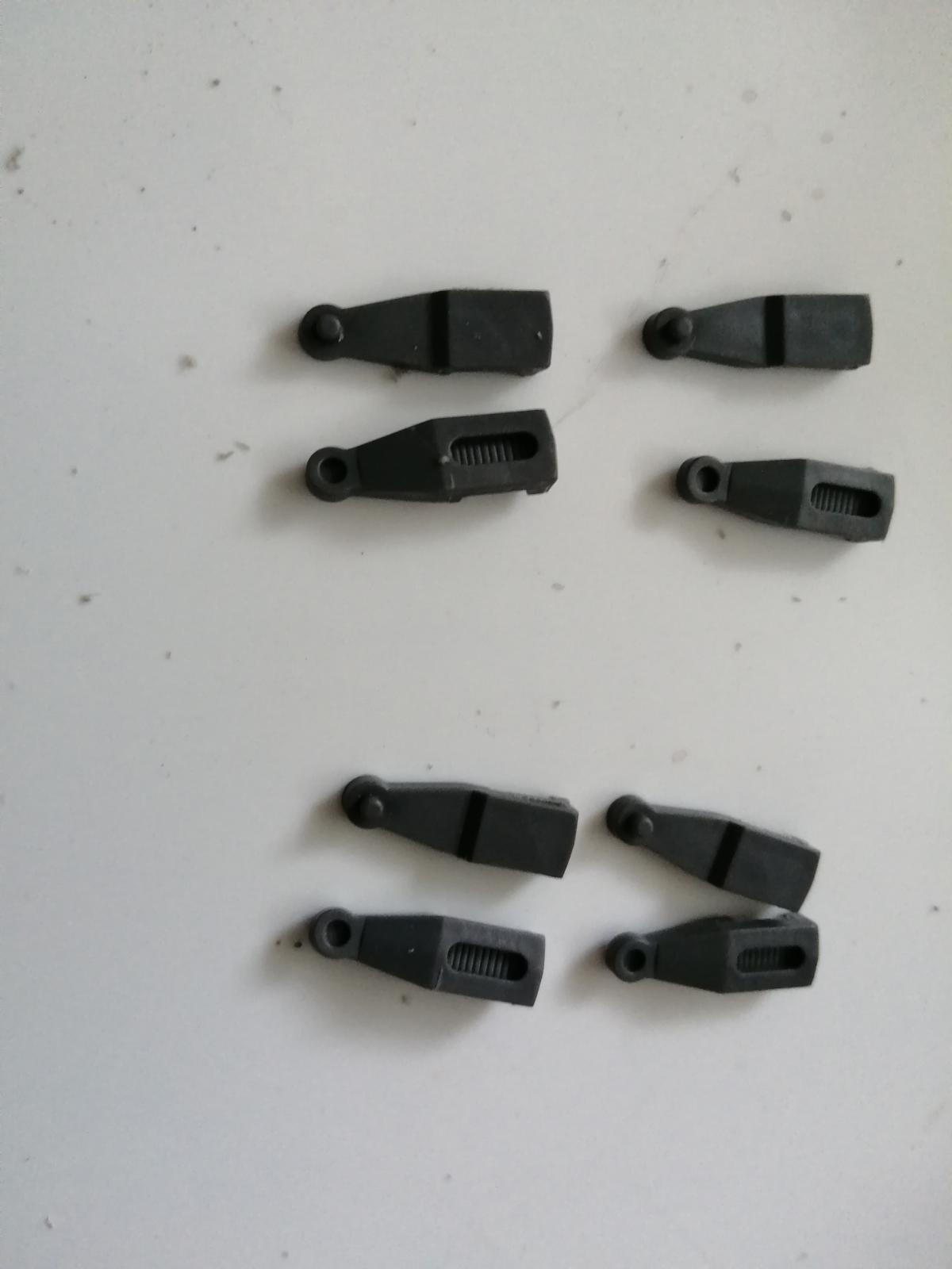

I have made a start on the surgery. With some trepidation and a fine toothed razor saw, I have cut down the suspension units.
I now have to play jigsaw puzzles with the spring and rubber strips, and hopefully end up with 4 matching units

Richard remember you need to use a strong glue for this step since the kit pieces are thin and the leaf springs will be under tension and are encapsulated in that small section. :thumbup:

c.rainford73 wrote:Richard remember you need to use a strong glue for this step since the kit pieces are thin and the leaf springs will be under tension and are encapsulated in that small section. :thumbup:
Thanks for the heads up. Unfortunately, by the time I read this, the deed was already done! I used Revell Contacta. It appear to have effectively welded the 2 halves together. I ran it around the parts that would touch and clamped the assembly in a vice for some time to allow it to cure fully. I hope this will be enough.
