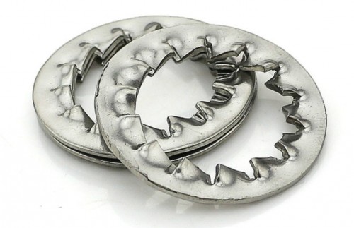

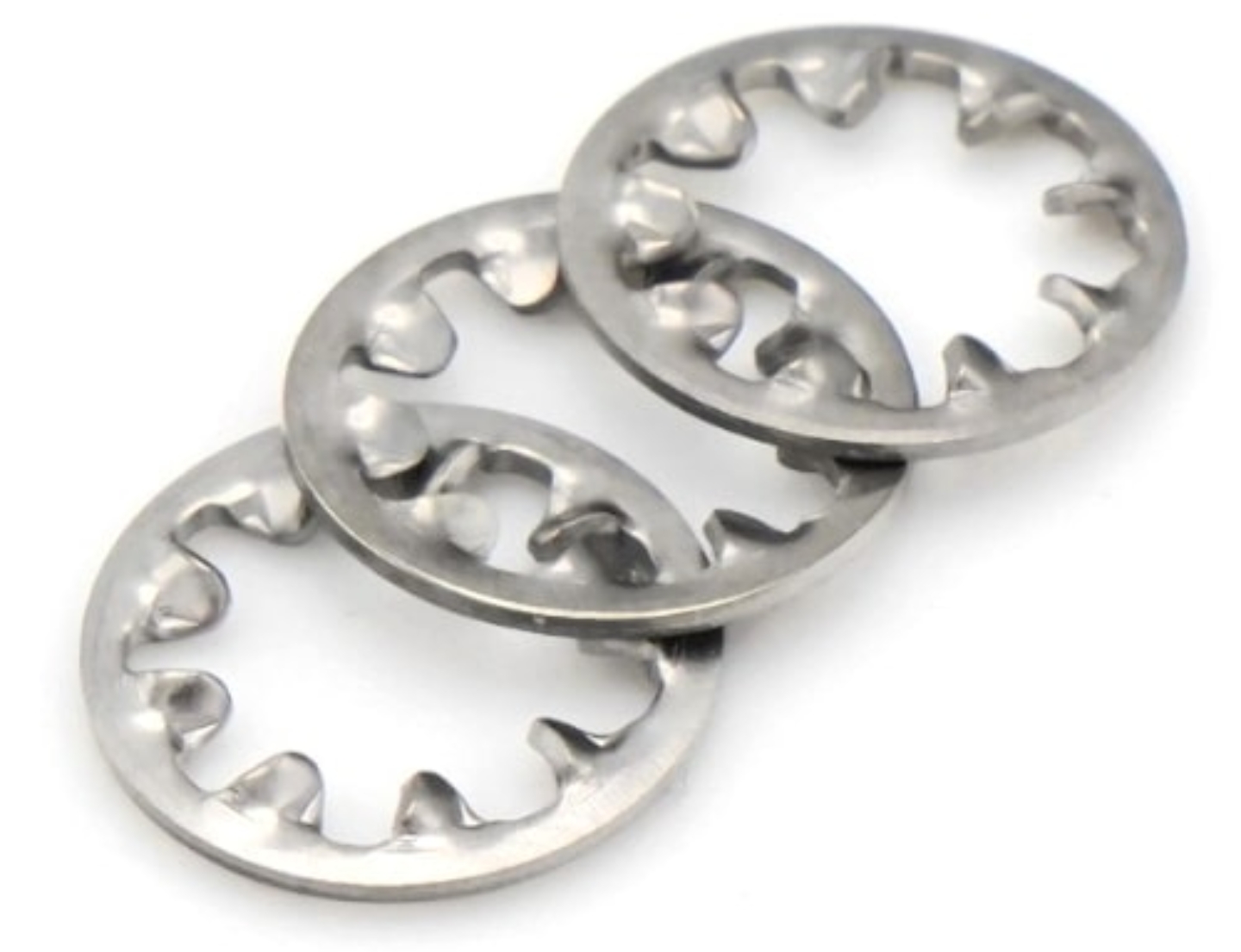

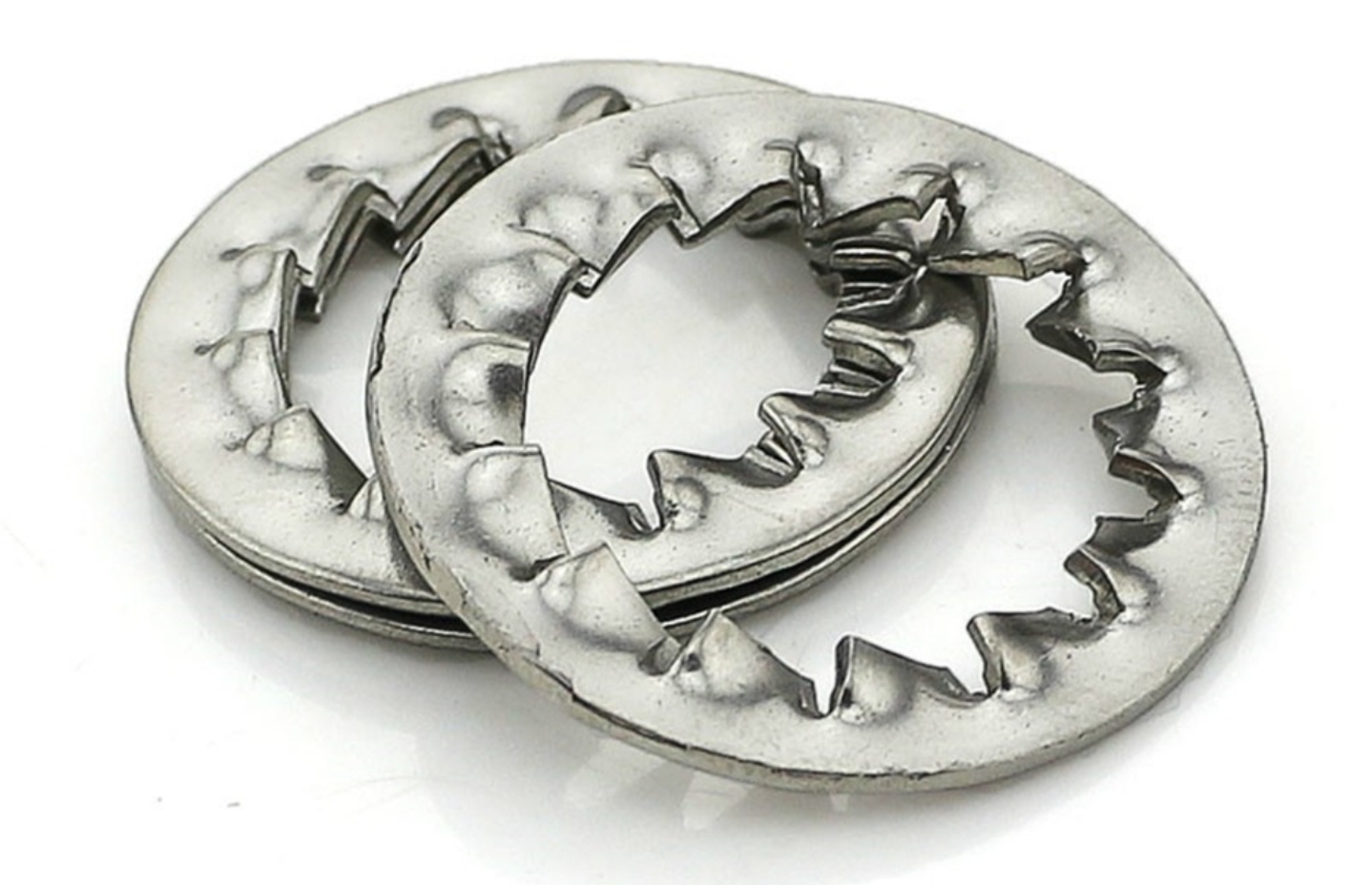

These washers are good for the sprocket screw.
They are internal star or toothed lock washers, either of the two types I show are good. Note teeth are in the hole, not on the outer edge, better for small sized screws.
