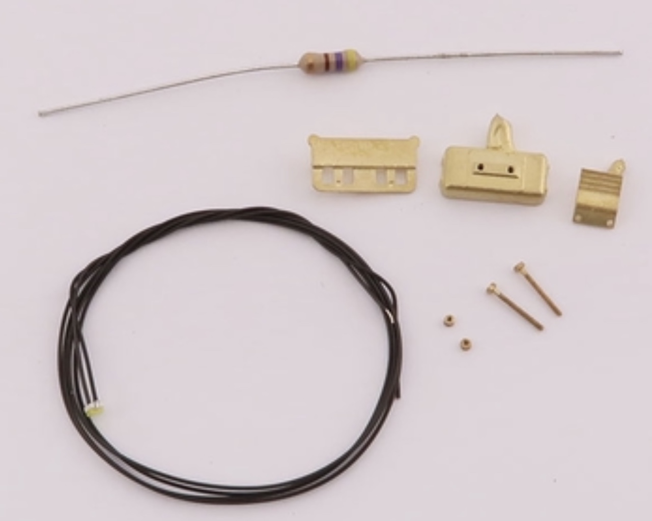

Do they come disassembled? I bought one from them recently and was ready to install.

Looks like this. Not shown is the green film that you cut to fit in behind the rectangular openings.

Oh it's that one. I had a different one. Is this tiger 1? Which period?

Posts: 8408
Re: Convoy Light Hook Up?
That's what prompted my question of Jimster as I was expecting a fully assembled item,
Thank goodness for upright members of this Forum coming to the rescue. :thumbup:
I assume you were talking about the later cylindrical convoy lamp.
