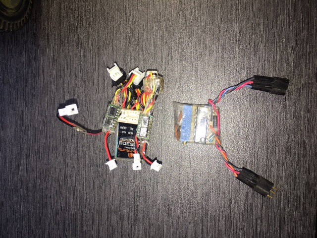

Back in the "old days" of radio control, if you wanted to reverse a servo with out taking it apart and rewiring it (5 wires), you could use a "servo reverse" board to do the job. seems crazy now as you can do that with a flip of a switch or push of a button on a computer TX with a screen.
The new electronics VS a "servo reverser"
wow this is some old gear from the 80's. Still works good but impossible to work with compared to what we have today.
Model disassembled for the big radio upgrade. No dual rates, Expo, travel, sub trim, reverse setting available with this rig lol

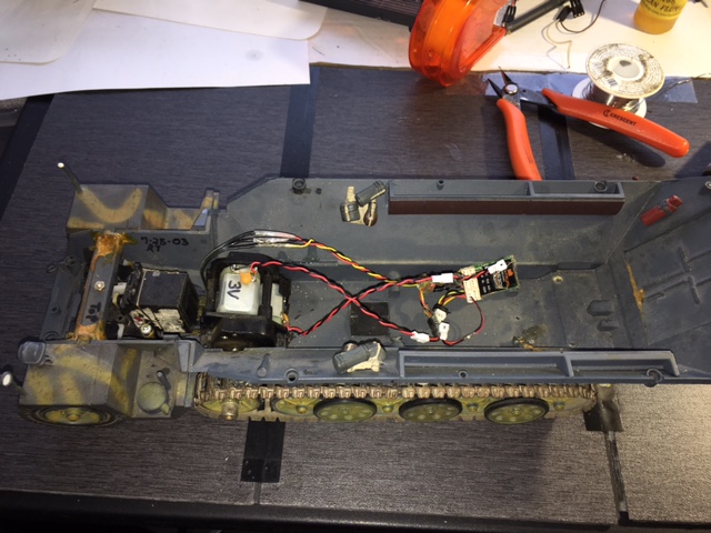

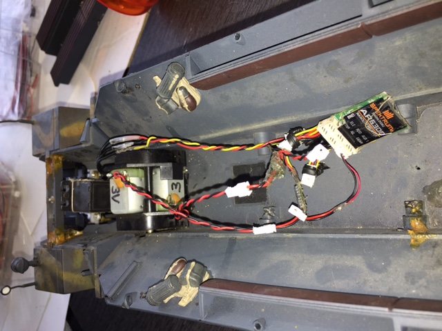

I wired the Halftrack for 3 channel with new DSM2 radio and have started working on the dual track to steering mixing and so far not seeing much benefit as far as turning radius is concerned. This half track has long tracks and that may have something to do with it.
I did get quite a bit more steering from the servo as I was able to crank the servo travel to 150 vs 100. That made a huge difference in the turning radius. I am still working on it and will post results here. Any comments or suggestions are welcome in this and any other thread I have here.
So far the mixing setup is Elevon wing mixing on elevator. aileron channels drive the two ESC's with the third channel Rudder controlling the steering servo. Another mix is Aileron to Rudder. This basically acts like a live axle but with more control on the trimming between the 3 channels. Not sure it is worth the added complexity at this point.
So far I would say the wired "twin motor live axle mod" works pretty good and only requires one ESC but I am still testing and will keep the thread updated with new info.

Ok I just figured something out and eliminated the Elevon mixing and used a total of 5 mixies to come up with something that looks promising. I am using the Gear and AUX1 channels so a 6 channel Receiver is required. This new configuration does decrease the turning radius and can even "drag a track" in the turn for sharpest turn. Having some minor reverse issues but early in the game here.
This is a new configuration that may prove interesting 8)

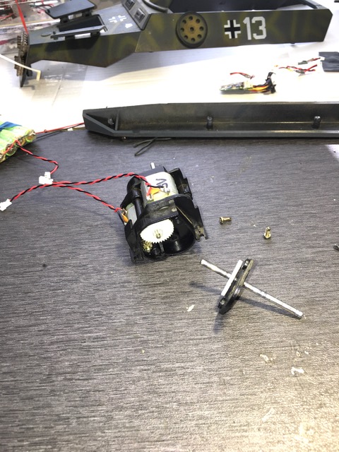

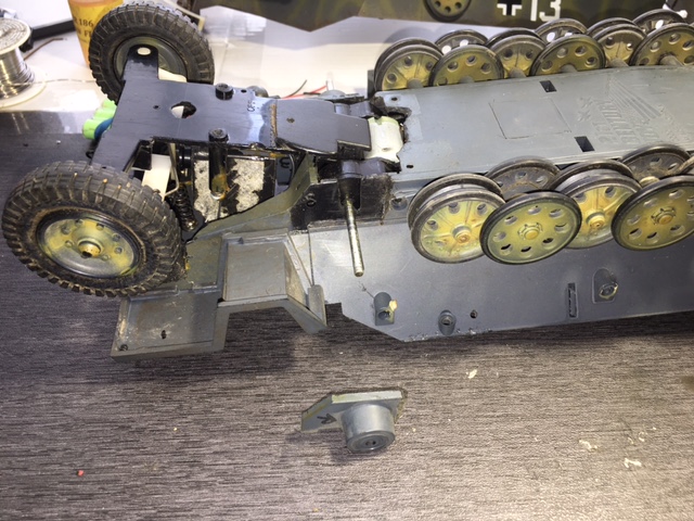

After testing the new radio setup in the Hanomag HT, noticed a noise in the right gearbox. Sounds like a broken tooth but could be something else. So did a complete tear down of the model and removed the right gearbox cover and after inspecting the gears found plastic particles in the gear teeth so cleaned both sides out and lubed then reassembled gearbox and bench test looks good. So maybe that is fixed. Will reassemble the model and try again.
Update. Model is back together and works very well with the Track\+wheel steering mod works excellent.

ready for reassembly
everything looks good now
plastic particles found their way in here causing a skip in the gear noise.
first teardown in nearly 20 years.
