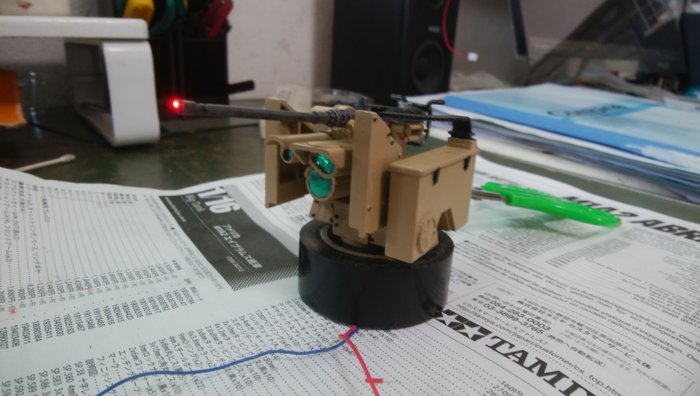

The M153 CROWS (Common Remotely Operated Weapon Station) mounted on US military vehicles is very few even modeled on the 1/35 scale. The 1 / 16th CROWS model is so hard to get, so I ordered it as soon as I found a 3D printed product in Shapeways HP. However, the white natural versatile plastic of this 3D printed product is a very hard material with rough surface. The surface does mot hardly become smooth by only paper sanding.
If I choose the option of another material Fine Detail Plastic, the surface must be smooth but the price is quite high. I stopped the surface treatment at an appropriate level and painted it. As a result, although it takes some time and effort, I feel that I could somehow make this model by using plastic and brass materials. Anyway, I was able to save the time and effort for the survey and work required to scratch this CROWS model.

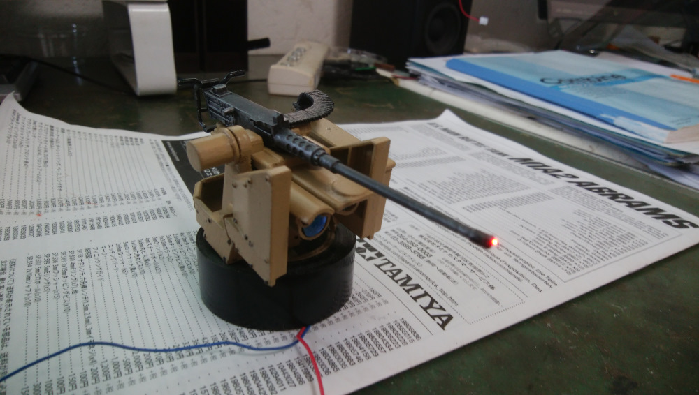

Next, I cut the barrel of the M2 machine gun in this kit in order to enable the MG to flicker. After cutting, for the new barrel, a 2.5 mm diameter plastic tube (tapered toward the tip) is used, and two enamell wires with LED chip soldered to the end are inserted in the tube. This is my favorite method, and I think it is a method that can flicker easily and inexpensively without affecting the appearance of fine parts where optical fibers are difficult to insert. However, it is necessary to solder a thin enameled wire to a very small LED chip.
This picture shows the condition that the LED is lit experimentally.
I planned to mount this directly on the rangefinder on the turret, but for a real tank, the CROWS seems to be attached to a dedicated mount. Although the detailed whole shape of the mount can not be seen well only from a real tank photograph, I found a wonderful 3D CG image.
After all, I have no choice but to make this mount with plastic plate etc referring to this image and the real tank photograph. I will do this little by little as part of the detailing up.

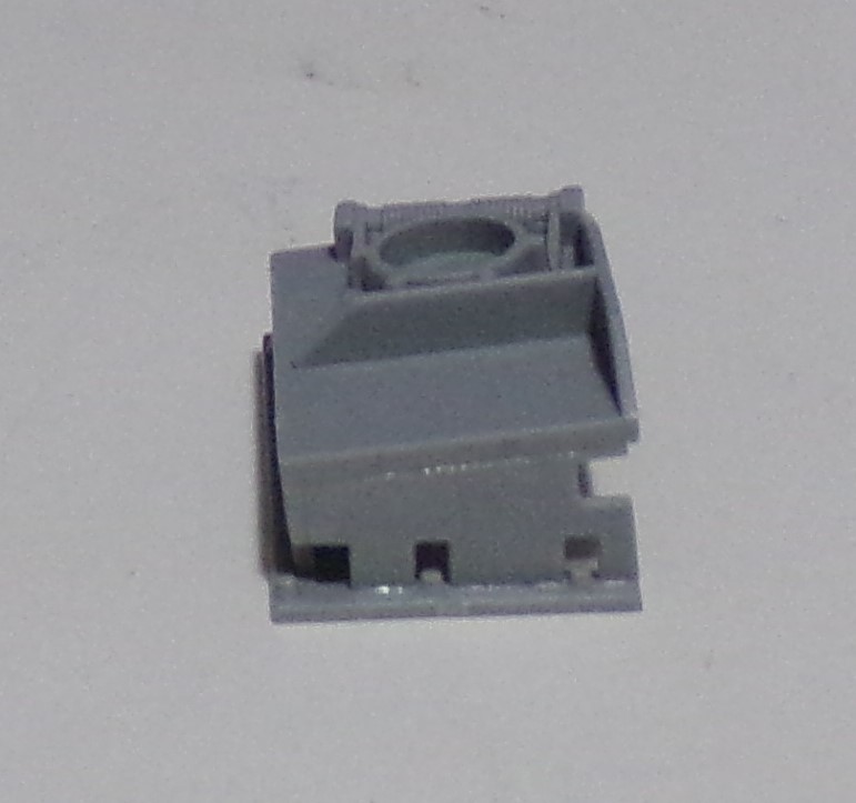

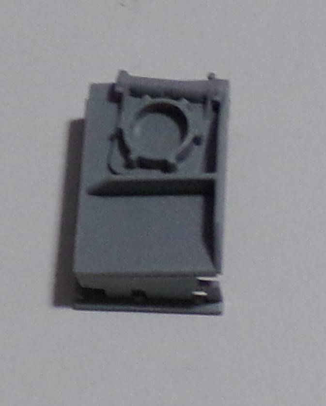

I probably bought the same CROWS from Shapeways that you did. I haven't got it yet, but yours does look very nice. The 1/35 Dragon kit I have has the CROWS system on it. I have attached Doghouse mount pics. Sorry they are a little blurry. My camera doesn't do well on small objects. This assembly is mounted over the existing Doghouse. The CROWS mount to it. The hinge allows it to be folded down to the left for storage or clearance during transport.
- The round portion is a spring

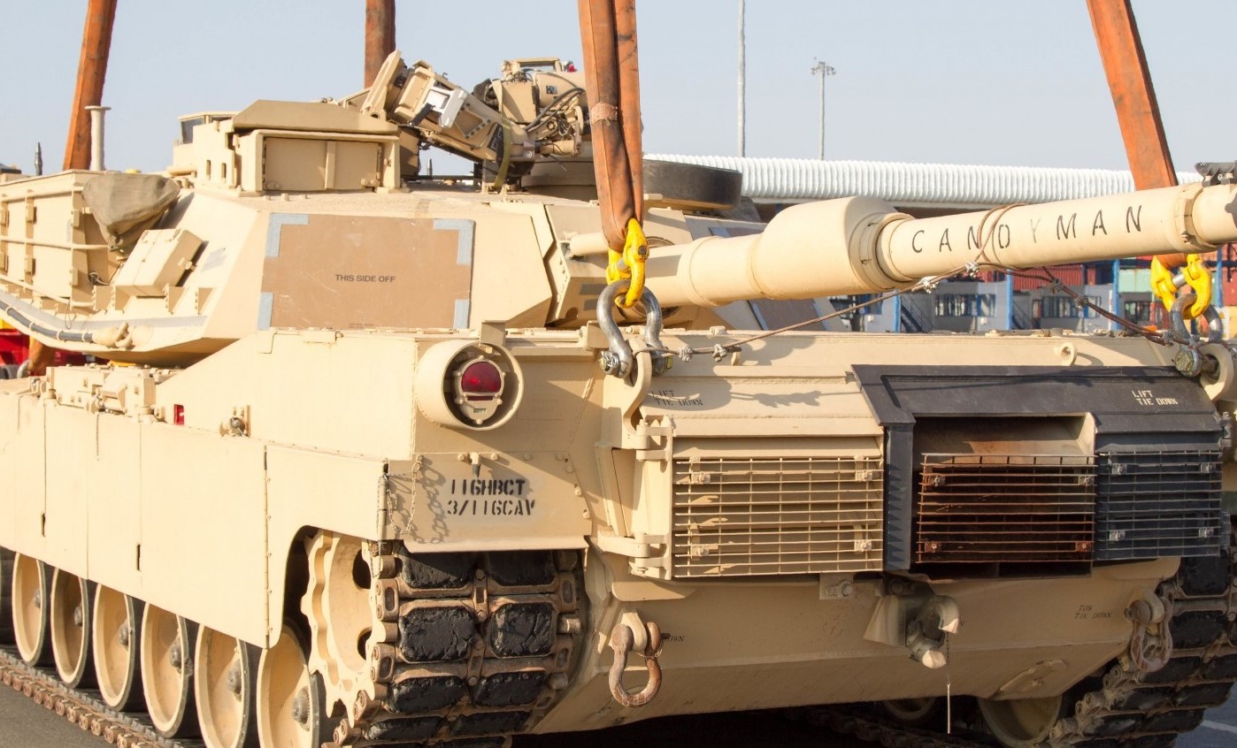

I think they fold it down whenever the tank it being transported by rail, air, or ship just so it doesn't hit anything. They also fold down the wind sensor. Both lower the overall height of the tank. I know I've seen pics of a Navy landing ships that had a really low cargo hold ceiling. They fold it down or it won't clear the ceiling. Here is a shot of it folded, but this looks like it might be the newer PROTECTOR low profile CROWs. Once it's folded down it rests on two rubber blocks. Second pic is of the original one folded.

Thank you very much for your valuable photos. I was looking for a such picture. I thought that the overall height would not change so much when CROWS was folded sideways. I found that the CROWS became compact when the machine gun was removed, turned 90 degrees from the front and folded to the side.tankme wrote:I think they fold it down whenever the tank it being transported by rail, air, or ship just so it doesn't hit anything. They also fold down the wind sensor. Both lower the overall height of the tank. I know I've seen pics of a Navy landing ships that had a really low cargo hold ceiling. They fold it down or it won't clear the ceiling. Here is a shot of it folded, but this looks like it might be the newer PROTECTOR low profile CROWs. Once it's folded down it rests on two rubber blocks. Second pic is of the original one folded.
