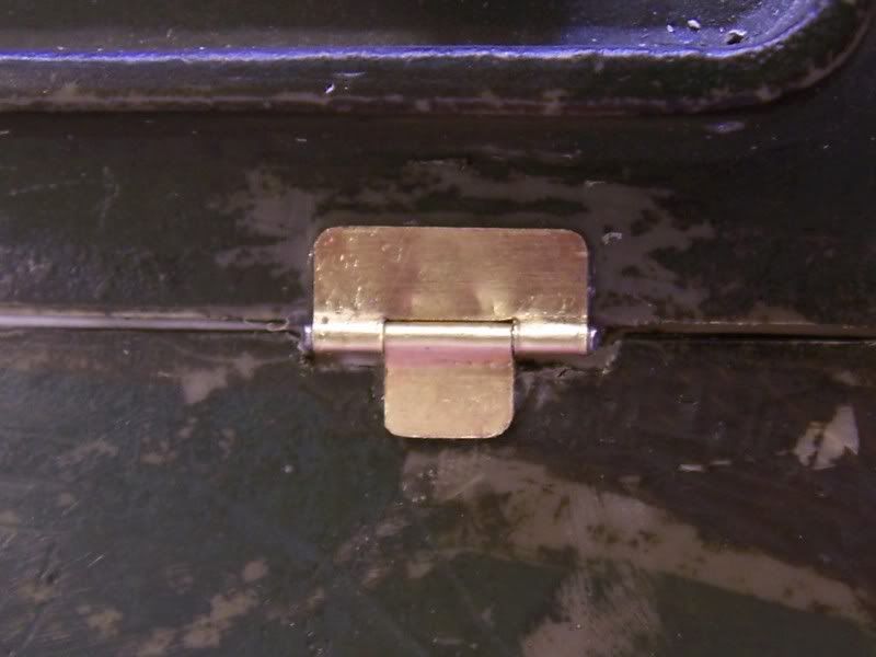

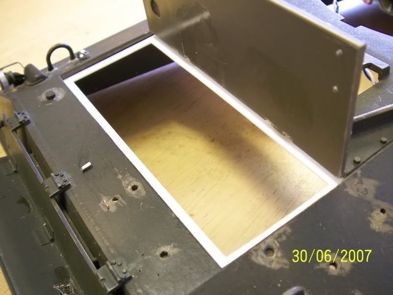

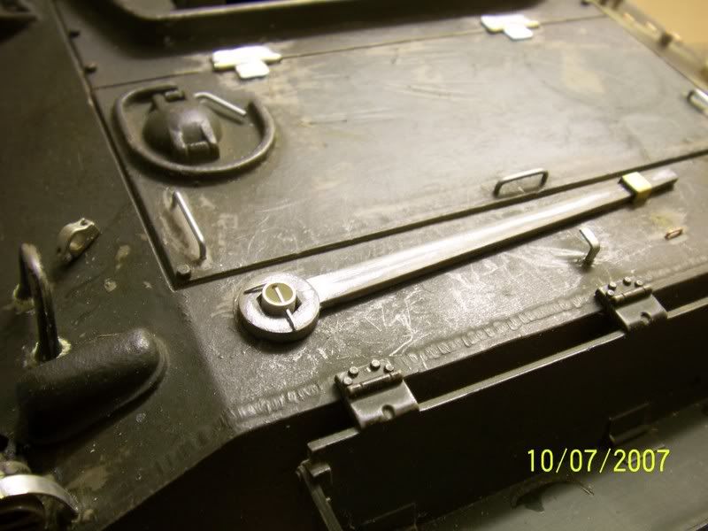

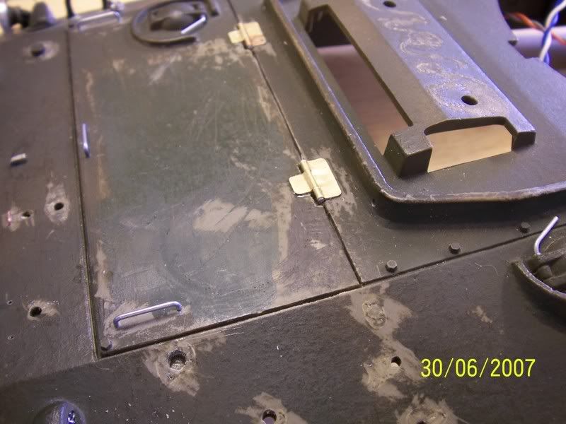

Thinking of the future and the possibility of retro fitting some sort of smoke generation I decided to make the rear engine deck openable.
I made the hinges out of thin brass bent around stainless welding wire and soldered together.Brass pins are soldered to the underside of the hinge plates to provide extra support.

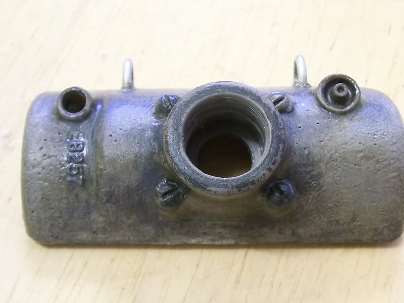

Texture added to the mantlet by softening the plastic on with a quick coat of acetone and stipple with a stiff brush.

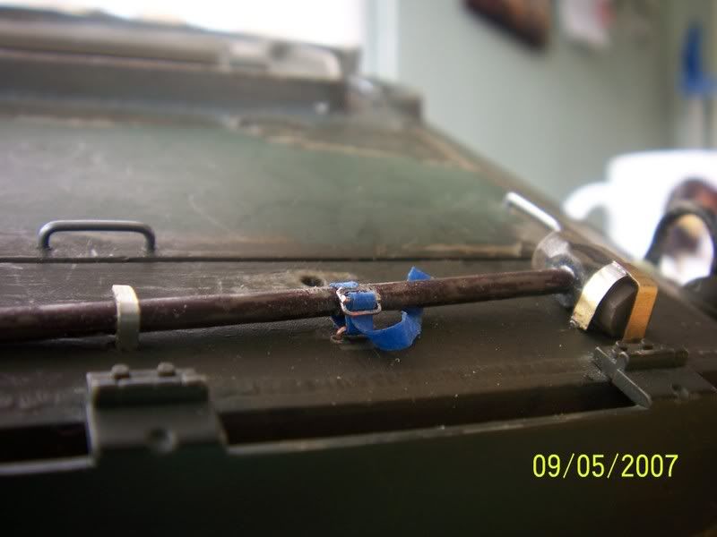

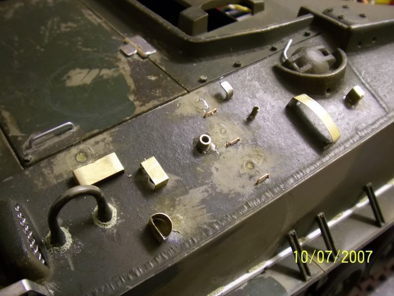

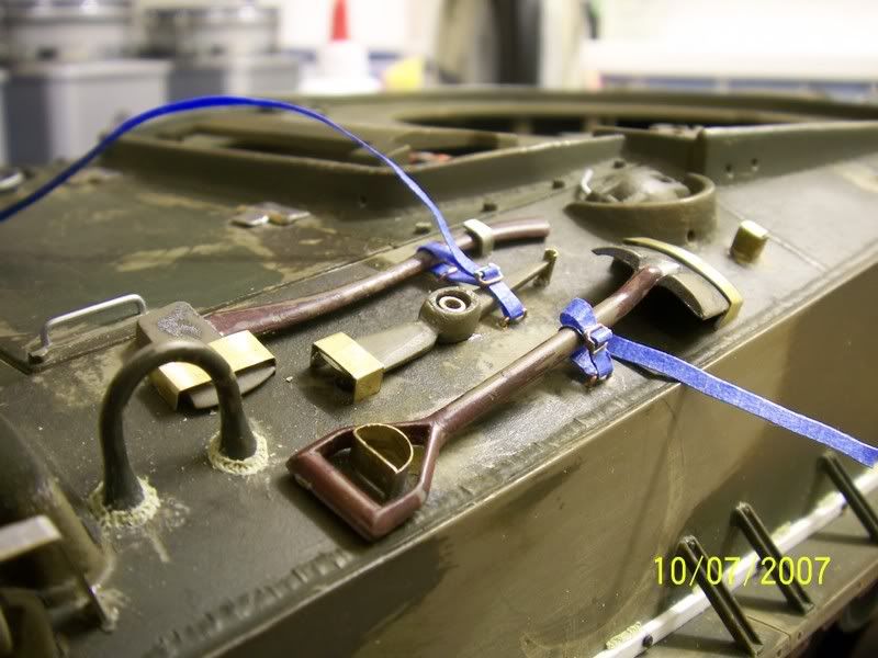

Not happy with the way the tools were attached I had a go at carving them up a bit.
Which then meant I had to sort out a way of holding them in place.
The blue straps are not meant to be blue and will be painted,eventually.

I bet you made the buckles on those straps.

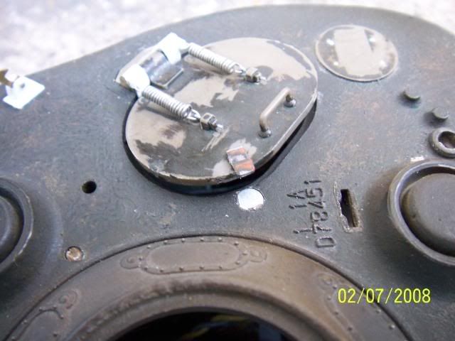

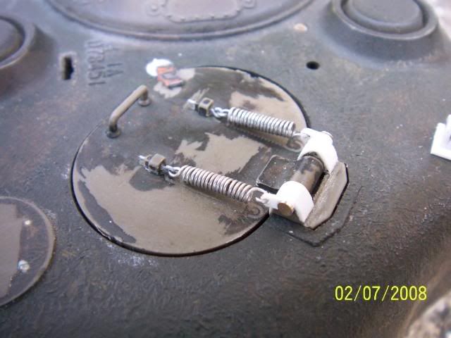

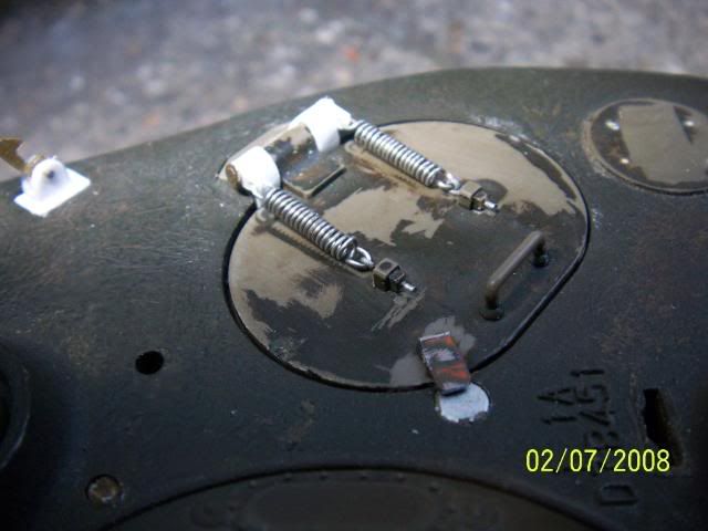

I made some springs to replace the molded ones on the loaders hatch.The springs were made with wire from those little twist ties you get with electrical appliance cables,I just stripped off the black sheathing.
I then found that the springs do thier job too well and the hatch would not stay shut.To get over this I put a magnet in the top of the turret and replaced the molded lock bar with a small piece of hacksaw blade.
It's amazing the things we tankers use for detail on our tanks.
I had to build up the material of the hinges as the springs are mounted off centre towards the top.This aids the spring action and allows the spring to go loose at the top of it's travel arc.
