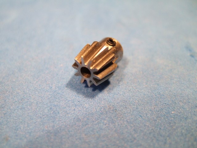

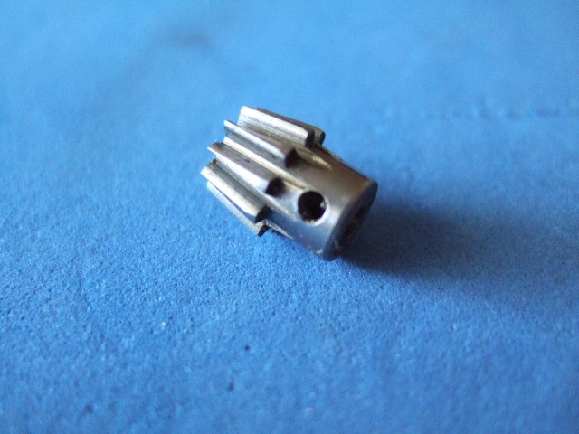

But then I opted out for a steel one.
101 (Small).JPG (80.28 KiB) Viewed 6464 times

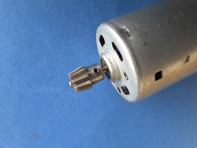

Pinion pressed onto motor shaft.

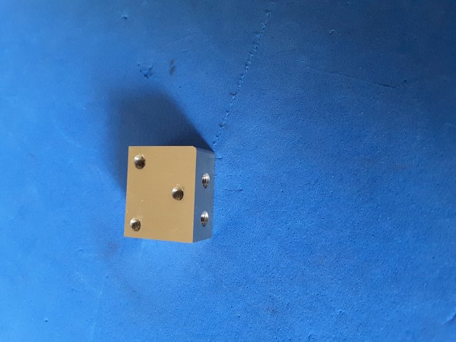

I made a small brass block to give the gear box frame rigidity and also a surface to attach the motor holding plate.
IMG_20180426_101933 (Small).jpg (92.97 KiB) Viewed 6462 times

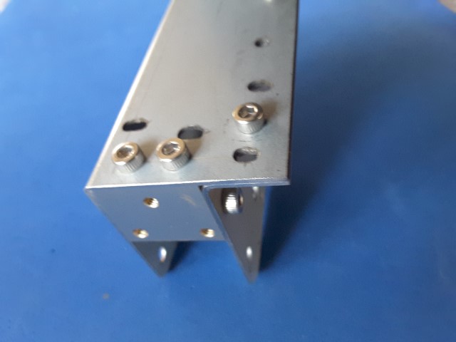

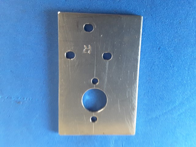

The motor holding plate. The 3 bottom holes are elongated to give some fine adjustment to the pinion and bevel gear.

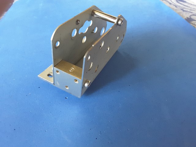

The brass block fitted.
IMG_20180423_124144 (Small).jpg (76.14 KiB) Viewed 6460 times

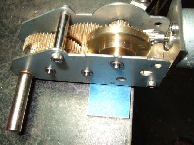

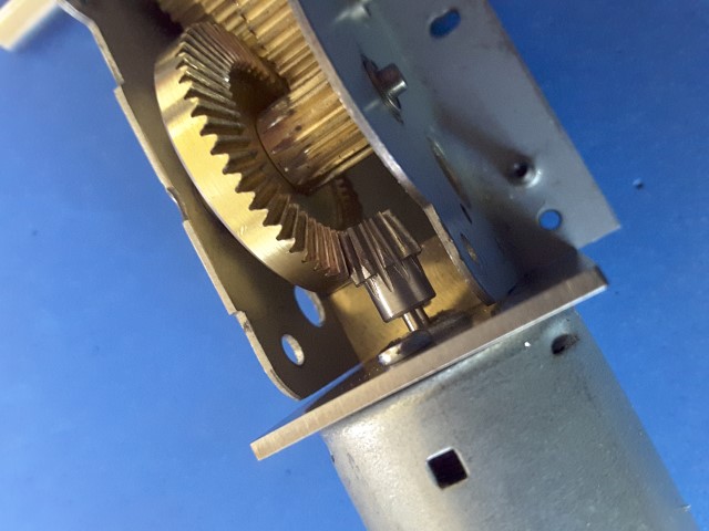

Gear box assembled. From the start I wanted to replace only the one steel gear, but on one of the gear boxes the steel gears where of bade quality and needed replacement. So I did the lot.
IMG_20180422_135300 (Small).jpg (91.3 KiB) Viewed 6458 times

All brass gears
117 (Small).JPG (97.83 KiB) Viewed 6457 times

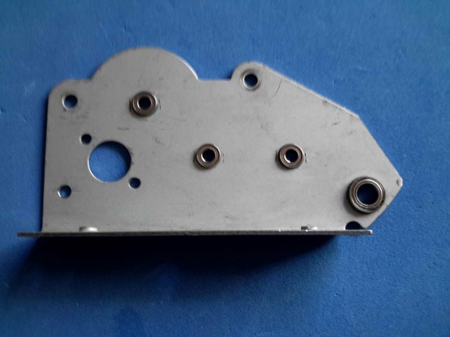

I also replaced the brass bushes with flanged ball bearings 3x6x3 and the drive shaft 5x9x4
IMG_20180427_151904 (Small).jpg (84.1 KiB) Viewed 6455 times
