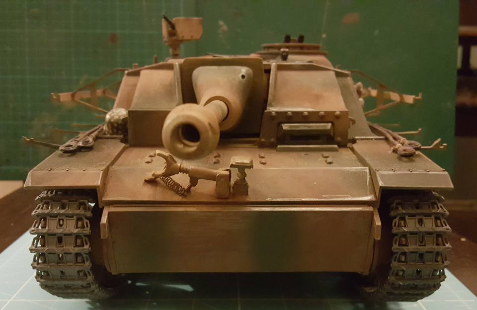

Thanks for the offer Dan. I've been researching for a while, as the Panther paint stages were curing. I'm going for the early G version. I'm going to skip the logs too, it smacks a bit of the Tamiya Sturmi in 1:35.
I actually think the hardest bit of this project will be getting the decals and doing the hard-edged camo. Everything else you can pretty much buy off the shelf.

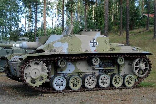

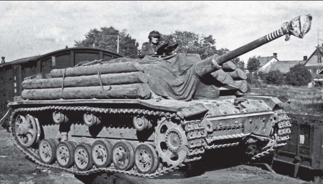

This is what Andreas Lärka’s Finnish armour website says. I can only take it at face value:
"The 1943 -batch StuG's were early production (but not the initial) G models with the square gun-mantlet..."
"The 1944 (second) batch StuG's were "late middle / early late" production G models with the Topfblende / "Saukopf" gun-mantle, all-steel return rollers (Alkett and MIAG), drive-sprockets with the wheel-bolts showing, loaders hatches opening to the sides, deflecting armour for the commander's cupola, solid (non-rotating) periscope-ring on the commander's cupola, late type fendersupports, typical German rear deck stovage-racks and Zimmerit."
"In the early 1950's ... some StuG's got gun travel-locks like the ones featured on some of the 1944 batch StuG's."
"From the 1944 batch of StuG's none probably ever fired their guns in anger. Most of them arrived too late to see any real action, as the first of the 1944 batch StuG's that arrived were used as reserves and for securing the rear areas. "
Which probably explains why none of the wartime photos I could find show a Sturmi with a travel-lock. The last photo is interesting as it appears to be a 1944-batch StuG.

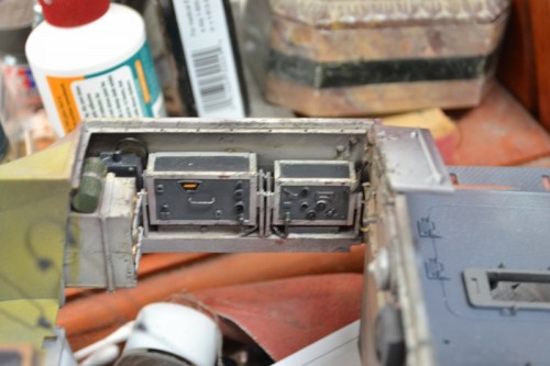

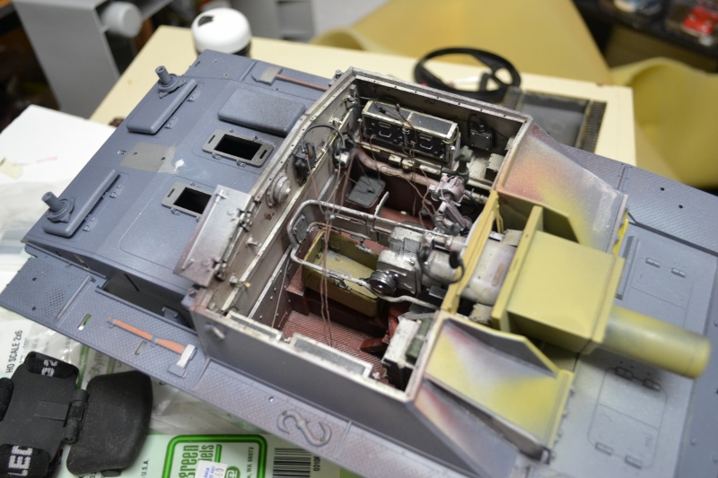

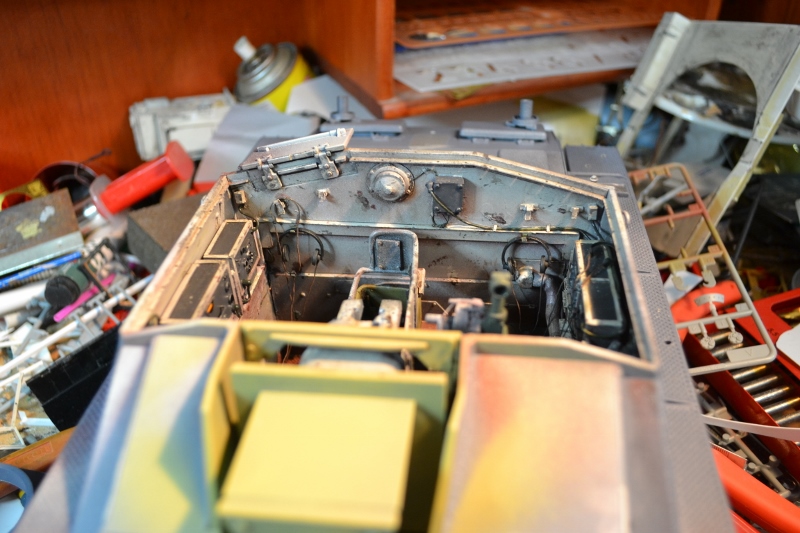

Ah, Roy. Check this Stug interior out! Even the radio dial appears to glow.
T'is but a flight of fancy though. Recoil and elevation can't happen without the mechanisms. He's gutted a dead Heng Long and made it into a stationary model.
This talented Kiwi upscaled everything from a 1:35 kit. You can see the whole build here:

Very impressive. I guess it would be possible to have an open topped Stug 3, displaying all the wee internal treasures, which can still clank along under its RC power. That would be half display model, half RC.Estnische wrote:Ah, Roy. Check this Stug interior out! Even the radio dial appears to glow.

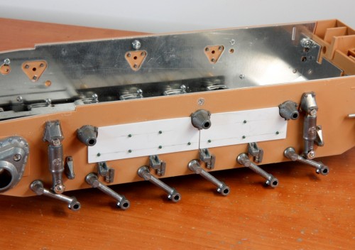

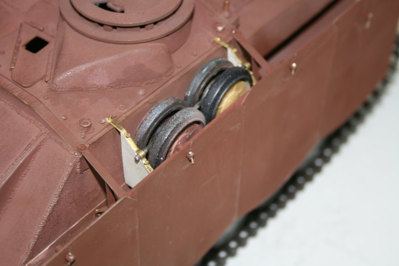

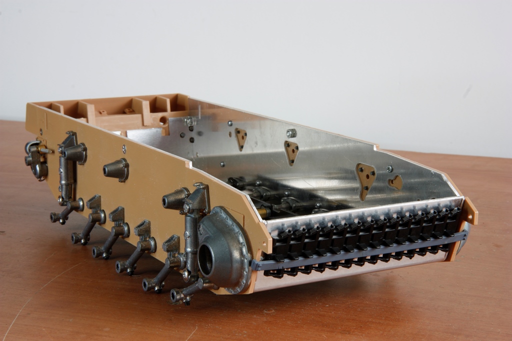

One of the things that will push this build along are the large number of aftermarket Mato parts available and very cheaply, for PzIII and Stug builders. Like a kid in the lolly shop, it was all I could do to stop myself saying "I’ll have one of everything!". Although I haven’t seen many of them built in the last two years, the range of extras indicates they must have been popular at some point in the past. I’ve only been around the hobby for the last two years.
The first thing I want to do is look at the lower hull. There is a significant difference on the Sturmi and that is that the Finns dispensed with the intricacies of schurzen, and instead went for plate armour bolted between the return rollers. This photo also shows a mounting bar for spare track link between the second and third rollers, but that was a post-war modification.
As I detailed a few posts ago, the original Heng Long lower has the side hatches which would need to be removed prior to fitting the plates. But handily, they are omitted on the metal reinforced Taigen version.
My last build was the Panther with which I vowed to stick with the plastic lower hull rather than convert to a Taigen metal reinforced version. This time though, the Taigen lower has so many advantages and extra metal bits attached that I am going with it. When I saw that Dave at Forgebear had them on special with 5.1 gearboxes included in the deal, I couldn’t go past it.

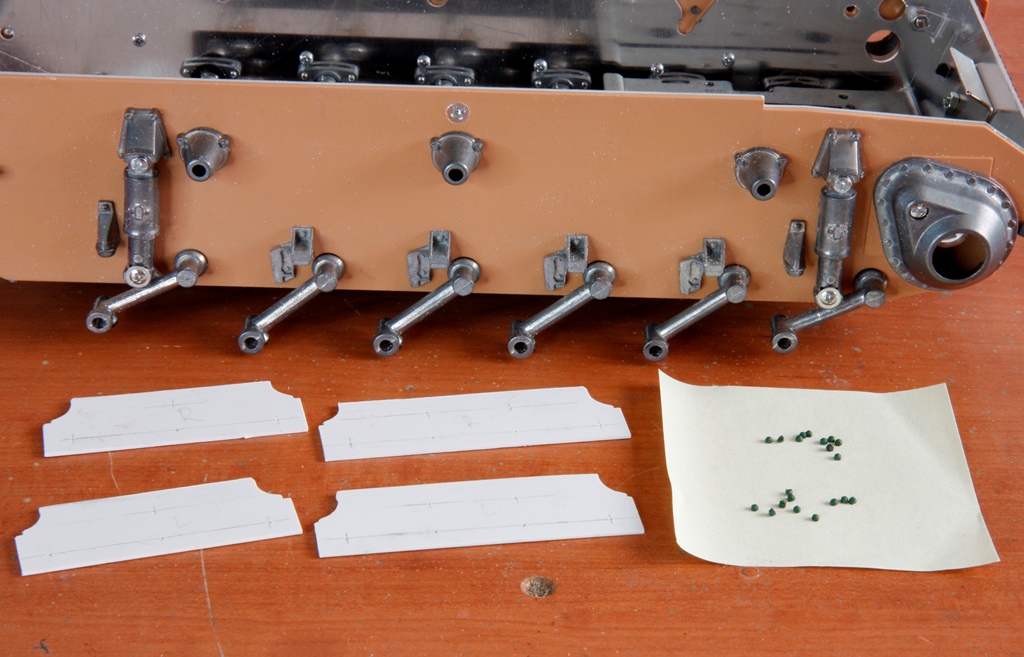

Some plasticard panels will do for the plate armour and I was contemplating using some fine detail miniature nuts. Then as I was looking around my leftover bits and saw there are 24 bolts on each of my leftover old Panther wheels. A bit of gentle cutting had them off neatly and then I superglued them on. There is a hole drilled behind them that allowed the glue to go right through so hopefully that's enough to make them stay in place. Happy Days!
