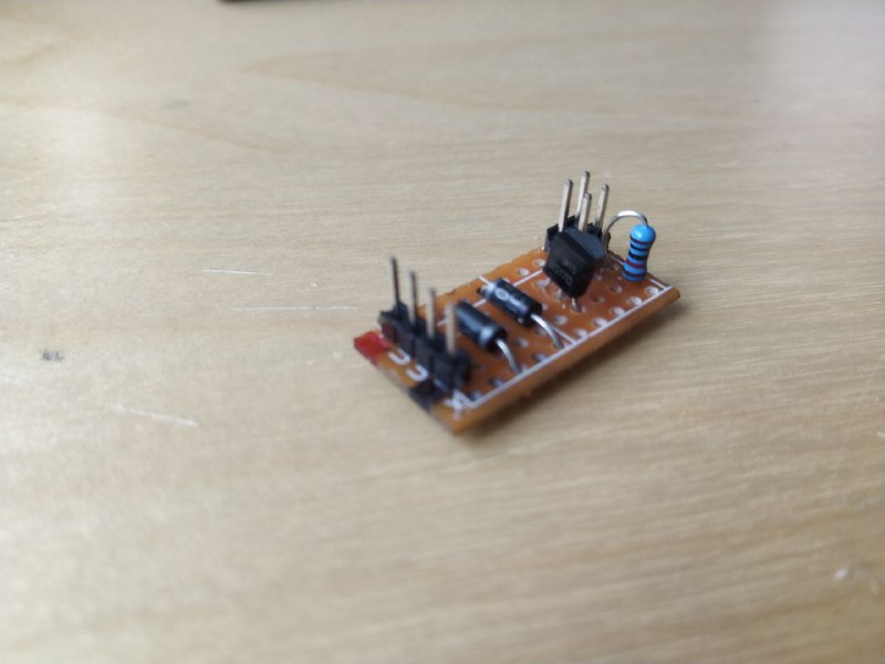

Mini update.
Not my cleanest job, not my best photos, but the driver board is ready.
This little board I made will connect to the radio internals, and from it, it will split in two small boards that will control the two vibration motors.
I only need the rest of the parts to arrive from china..

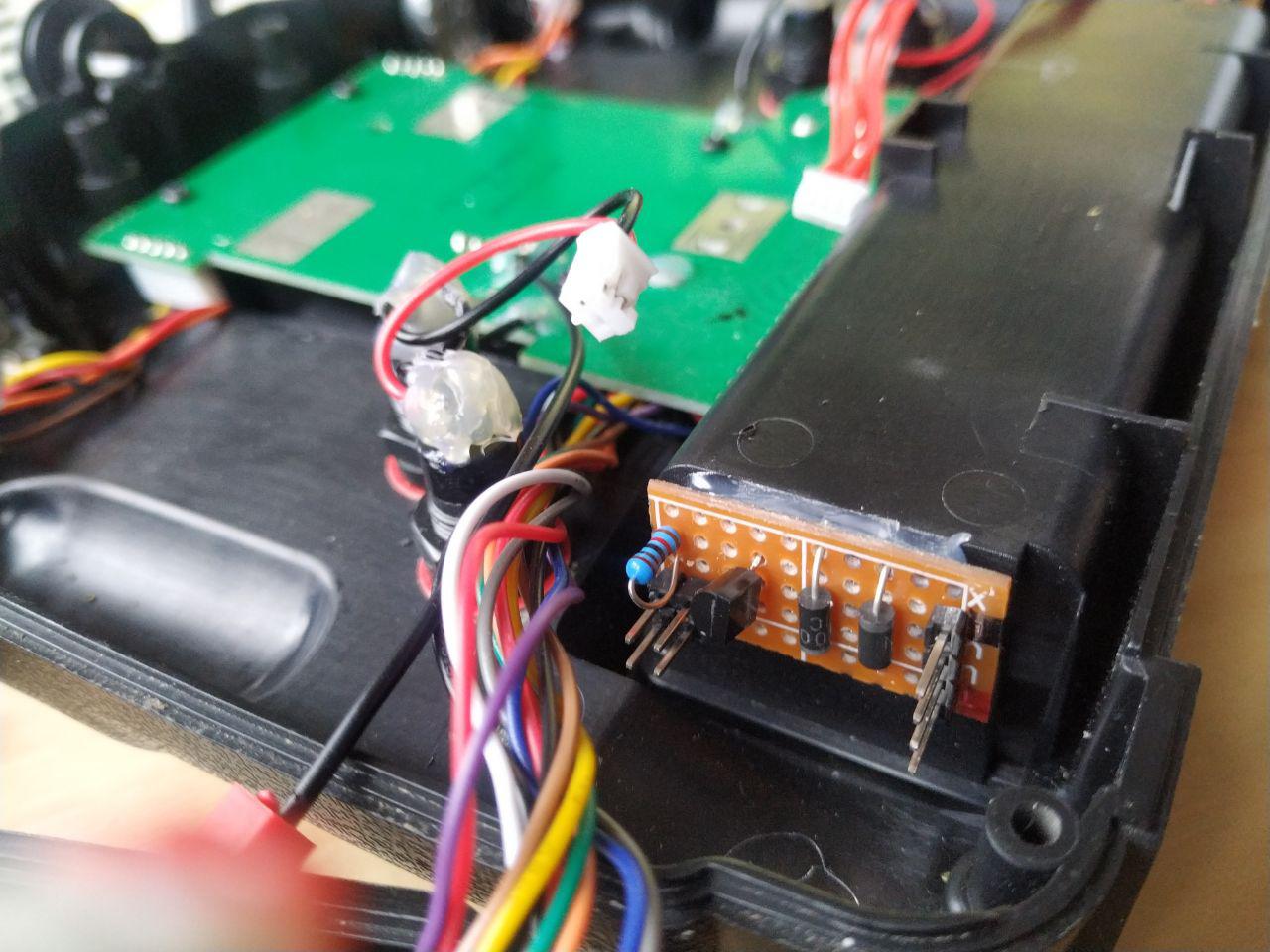

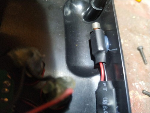

Re: My radio mods.
Hi guys, today I managed to install the vibration motors and my own PCB in my radio. I installed two, one on each side. Now my radio vibrates in a determinated way to tell me that my tank or radio are running out of batteries... Also it vibrates when I shoot the main cannon, the machine gun, and when I start the motor on, giving a nice effect of "feeling" the tank.

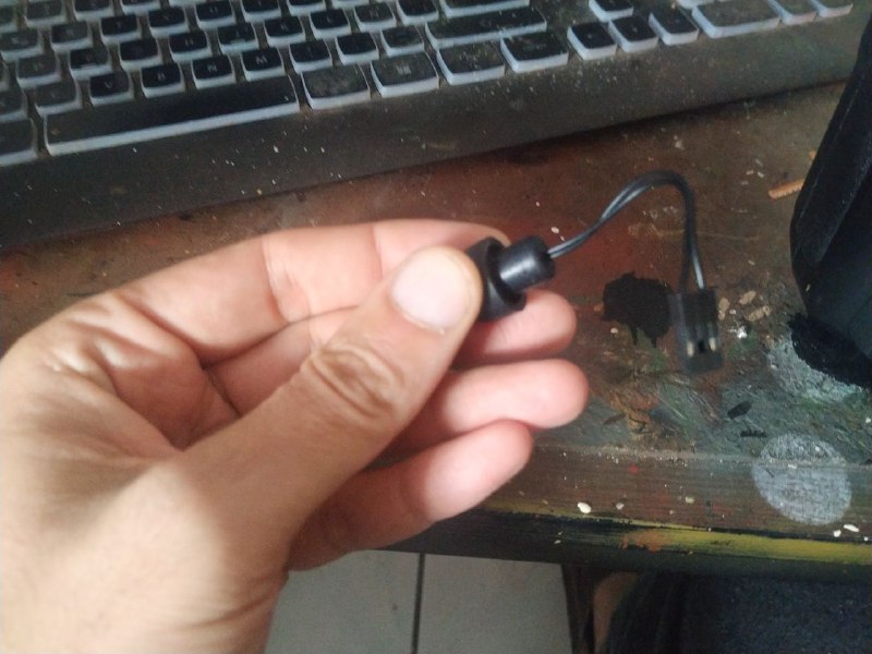

I almost forgot to show you another easy mod. It is one of those things you dont need, until you need it.
If you are like me, that have only a couple of good radios and a lot of receivers, from time to time you may have the need of binding them with one or the other radio. Also if you go to a tank meeting, you might need to bind some other`s guy tank with your own radio. And if you are not using modern receivers, you need a bind plug... That of course you left kilometers away at home.
This wont be a problem anymore! Now I have a bind plug hidden in an unused part in my radio, so I always carry it with me.
It sounds like a stupid mod, but it saved me a couple of times.
