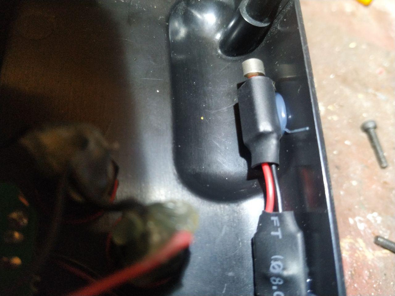

Hi guys, today I managed to install the vibration motors and my own PCB in my radio. I installed two, one on each side. Now my radio vibrates in a determinated way to tell me that my tank or radio are running out of batteries... Also it vibrates when I shoot the main cannon, the machine gun, and when I start the motor on, giving a nice effect of "feeling" the tank.
I cant be happier...
The FPV mount is installed too, I just have to take some photos, and then, the last piece, the holy grial, the Encoder has to be installed, but it will take me some months...
Again, without the help of the Openrcguys, this would have not been possible. Cant thank them enough.
