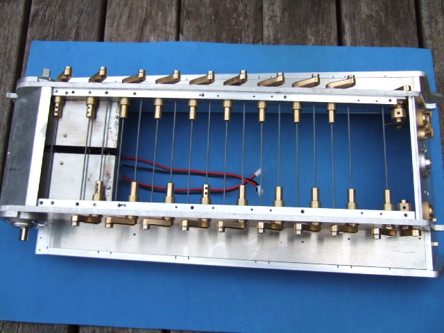

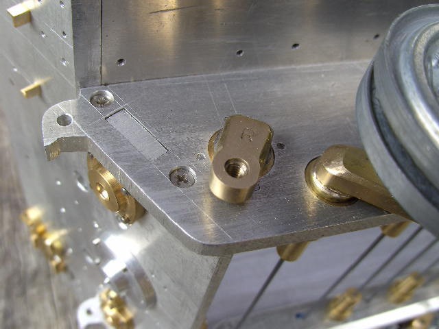

Arms assembled.
013 (Small).JPG (88.06 KiB) Viewed 6583 times

Suspension arms, torsion bars and track tensioner are in. Extra bearing support is also fitted. Torsion bars are made from 1.4mm dia spring steel.
014 (Small).JPG (97.55 KiB) Viewed 6576 times

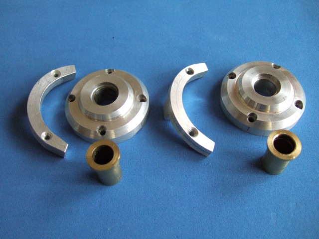

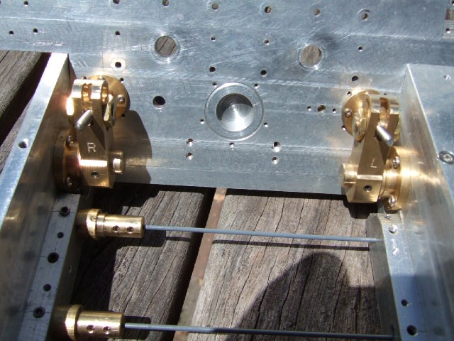

Gear box bearing support parts.On hindsight I could also have used ball bearings instead of brass bushes. Wonderful thing hindsight is.
115 (Small).JPG (75.94 KiB) Viewed 6574 times

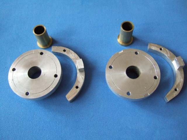

The other side.
116 (Small).JPG (79.7 KiB) Viewed 6574 times

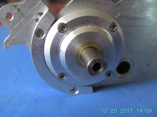

Assembled.
103 (Small).JPG (58.8 KiB) Viewed 6574 times

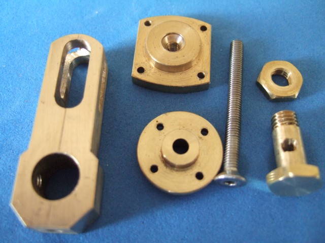

Track tensioner parts.
011 (Small).JPG (83.21 KiB) Viewed 6573 times

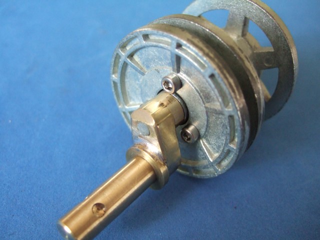

Idler arm.
048 (Small).JPG (68.8 KiB) Viewed 6573 times

Idler arm fitted to idler wheel.
031 (Small).JPG (73.46 KiB) Viewed 5990 times
