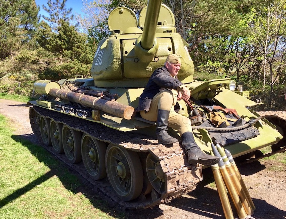

Here's a working T34/85 that came to visit the Highlands last May. It even fired the cannon, and deafened all the local seagulls....
T34 Scotland 2017
T34 Scotland 2017
Click to enlarge!

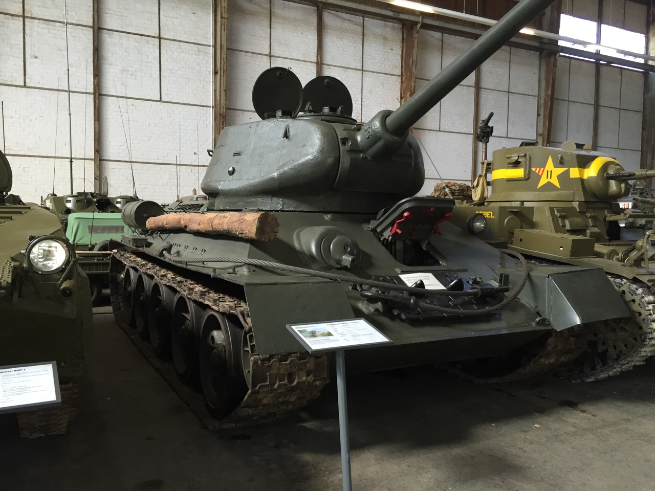

Here's one I snapped in the Swiss Military Museum back in 2016. Getting full profile shots is not always easy, unfortunately...
T34 Swiss Military Museum
They may help a bit..if only with a bit of image variety
