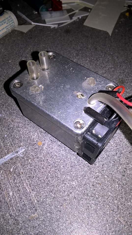

Brilliant solution on the smoker outlets, Nick. It's not easy having the smoker in the lower hull and the exhaust in the upper hull, but this is the most elegant idea I've seen. Great work on the model, keep it up!

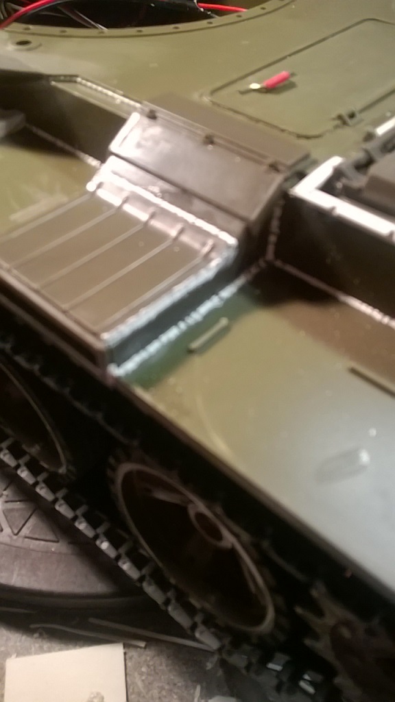

Heres the alteration to the smoker
I'm manning the gun's ! Who's driving ?

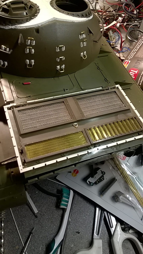

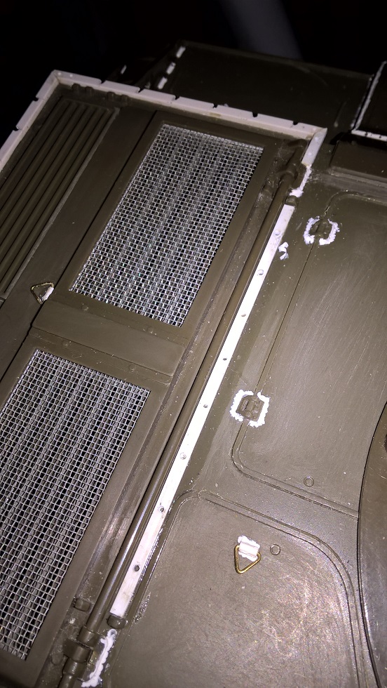

Started on the rear deck detailing. The engine frame is angle plastruct there are two types of mesh, the aluminium is from a fat splash guard I got from Dunnes kitchen department for £2

This view shows the PE mesh for the rear vents

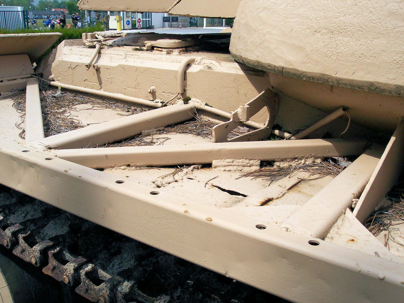

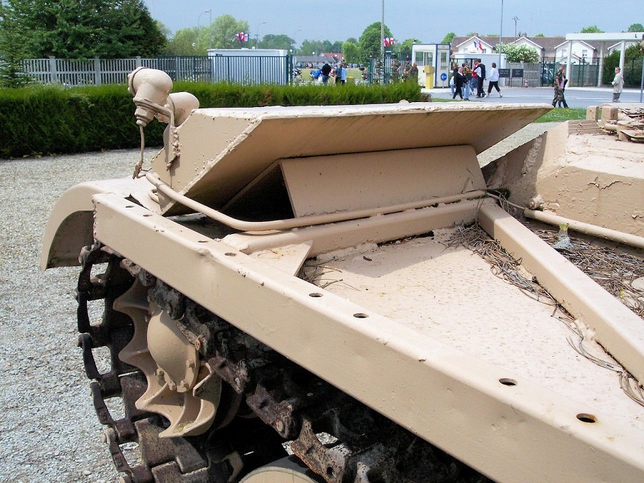

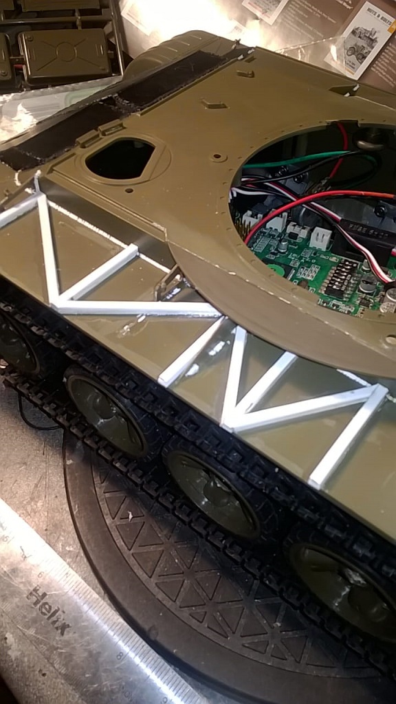

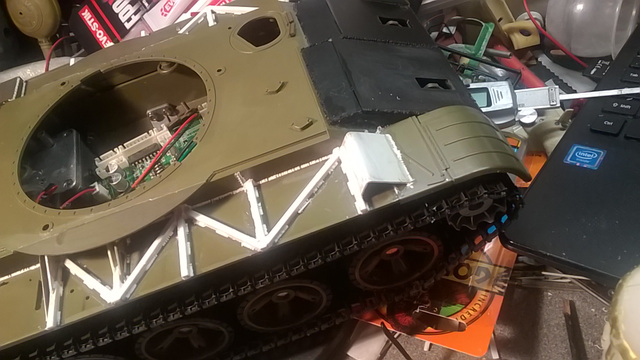

Next to sort out are the side frames that hold the side armour. To get the right profile each cross piece is made of two lengths of plastic strip cut from sheet and rounded on the edges. Lots of reference to original photos for all this. There were they think about 8 Enigmas built all slightly different. The spatial armour is made out of armour plate layered with rubber between, in some cases it was found to have had no rubber fitted which points toward a lower tech manufacturing process not quite back street garage but certainly not high end engineering. The exhaust cover is welded on and the weld detail is added. I've drilled out the holes in the exhaust port which is used to

The front spatial armour on the sides is simply mounted to a folded steel plate welded at the appropriate angle.. Lots of small bead welds to replicate

I use the Prime Portal Walk Around as sorurce material the Bovington Enigma has a page with hundreds of photos, but I picked the American war prize
