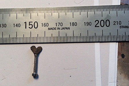

Please can you critique my attempt at M2 wing nut please? The bolt is an M2 standard capscrew. Let me know good, bad or indifferent, I really would value your opinion.

Pete I absolutely hate measuring the quality of good bad or different work of others BUT
My M2 wing nuts are exactly the same width at their widest (8mm) as yours are,
Perhaps you could file a deeper and wider hollow into the centre and slightly flatten the top line of the wings giving the effect of slimmer wings,
Have you thought of making a drawing of what you are trying to achieve and transferring it to 1 mm Plasticard,?
A good blade and a set of modelling files can achieve wonders and you then have a source of reference for that time in the future when you need more. (And you will)

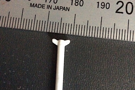

Thanks for the feed back, Shaun, i have widened the hollow and they look better already. You are right the 1 mm plasticard is the way to go. The good thing is doing what i have done has given me the confidence to go for it. I have just traced round a Schumo one and this is all but the correct size if i cut around the outside of the pencil line, also a much more convincing shape.

Here is my first attempt at M2 wing nut in plastic. Definitely better making them from plastic. I used 4 pieces of longer 2.5mm rod and this made them easier to hold and manoeuvre. Also the plastic glue sticks really quickly so that helps.
Also i put the rod in my dremel and then ran it against a file to create the tapered body of the nut. When I am ready to use them I can either cut them off or thread the stem M2. I will try this first to see how it looks, otherwise I will cut them off, drill and Tap and there we go.
As this is my first atrempt I have plenty of plastic left and will try to improve them again.
