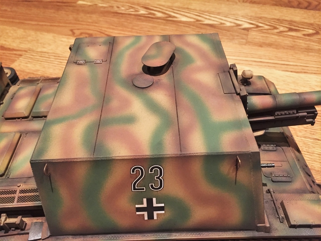

Estnische wrote:Louis, could I trouble you to give me the dimensions of the four sides of the top plates, and the roof?
Sure
Front plate; Bottom front is 175mm wide, top 139mm, 63mm in height from the lowest part
Profiline 1/16 Sturm-Infanteriegeschütz 33B

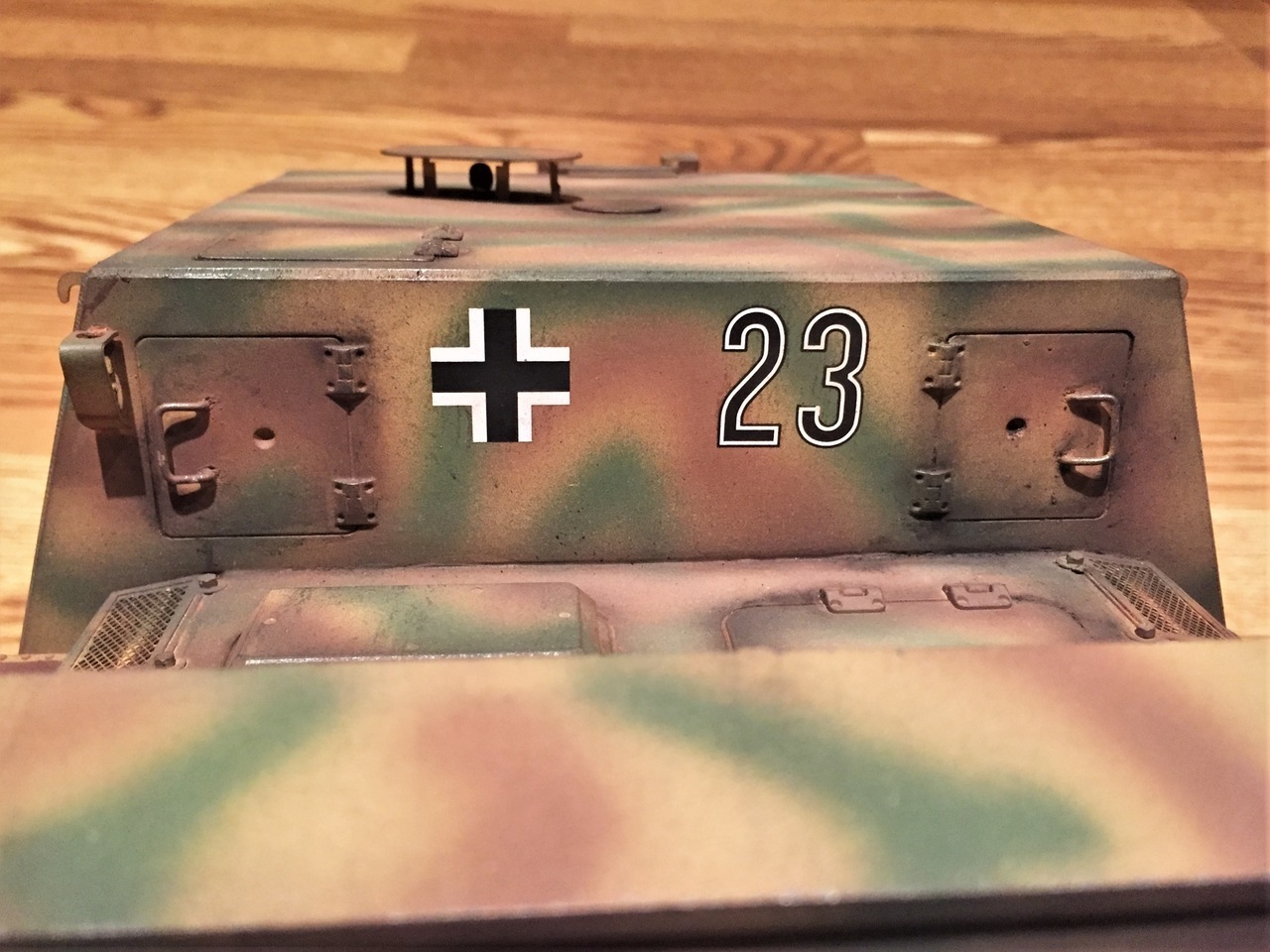

Back plate is same as the front but the deck is 40mm from the top. Those 2 hatches are 25x27mm.
Side; Length is 142mm at the bottom, 130mm at the top, height is 60 at the back, 66 at the front. The inclination is all on the front armored plate, the back plate is strait. The top hatch is 26x30mm, the oval part is 38x21.
Regards, Louis

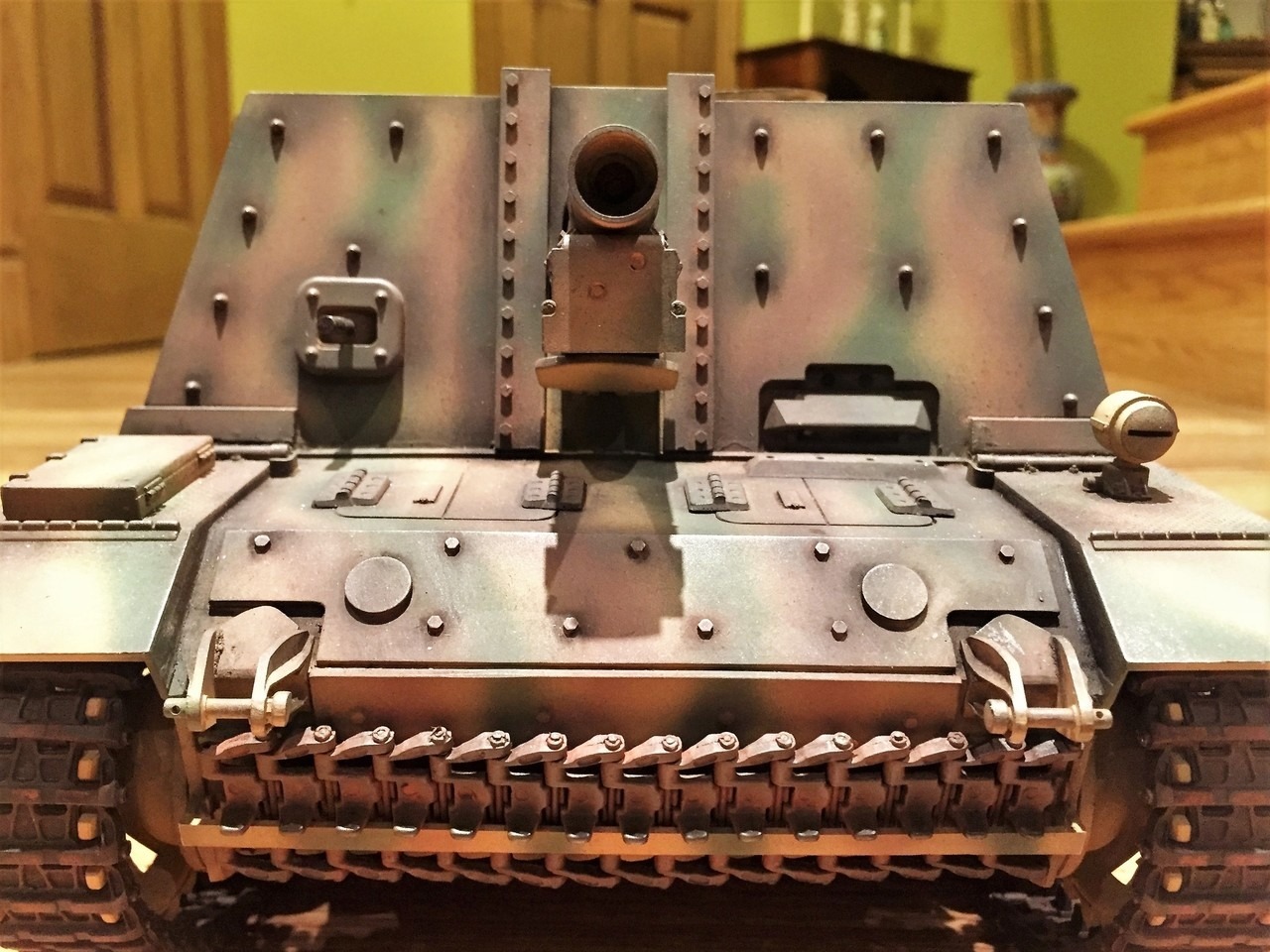

The conversion came out fairly well. It's a cool tank and it fits nicely between the sig33b on the pnz1 chassis and the brummbar.

I came across this interesting build about a year ago to be exact and now I must add it looks even better now my friend :thumbup: always been a fan of these large gunned armoured beasts. Louis as usual you have taken it to a whole new level of detail
