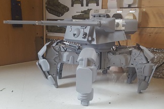

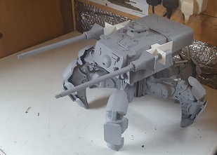

been inspired by these so here is my attempt
- 18156498_10212779833475852_6323995824170606304_o.jpg (28.19 KiB) Viewed 3926 times
- 18156344_10212779835275897_5394307161434814878_o.jpg (25.6 KiB) Viewed 3926 times
- 18121895_10212779836155919_7819250772881490489_o.jpg (30.95 KiB) Viewed 3926 times
