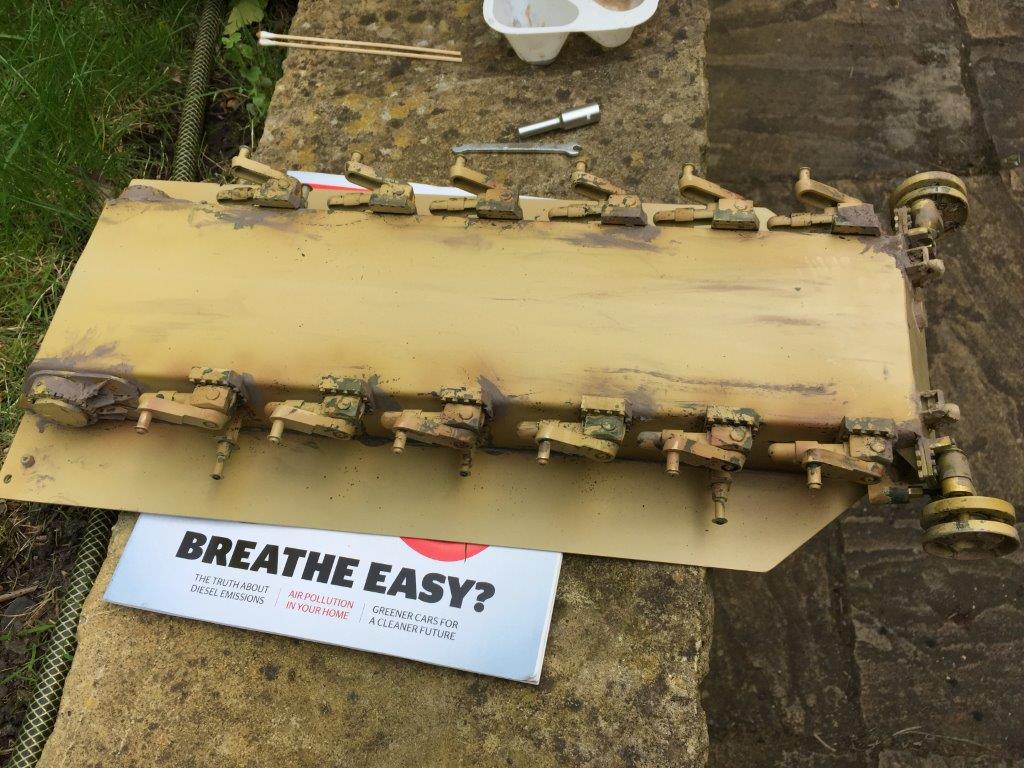

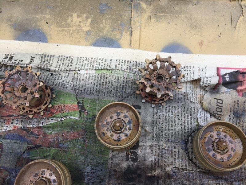

After a long lay-off on the build (well actually I have been doing bits and bobs in between the usual demands of Father, Uncle, dutiful husband and handyman - but I cannot lie, it has been difficult to sneak in quality time on the Chally). However, I had got to the point where I could claim victory on the mechanicals and electricals. I had managed to plumb in the TARR to test, got the Recoil to work reliably and was happy enough to rip everything apart for paint. A Primer of Hycote and 2 Tamiya Sand rattle cans later and it was time to fire up the Airbrush.
I have never used one before, so I was a bit worried that I was about to trash a rather expensive metal sculpture. Whilst I am sure more adept members of this forum could have done a far, far better job I can live with the results.
I have applied some weathering powder (VMS Spot on in 2 flavours: Dull and Intensive. Applied using their Alkyd Binder). The binder is certainly interesting stuff - and takes an age to go off - but I am pleased with the texture it creates. Just to finish off, I applied Matt Varnish - in this case Windsor and Newton's Professional. The varnish had me seriously worried for a while. It reeks to high Heaven and looked to have a wet sheen for quite a while after application. I needn't have worried - the final finish is great.
Here are some pics:
Chassis prior to Varnish

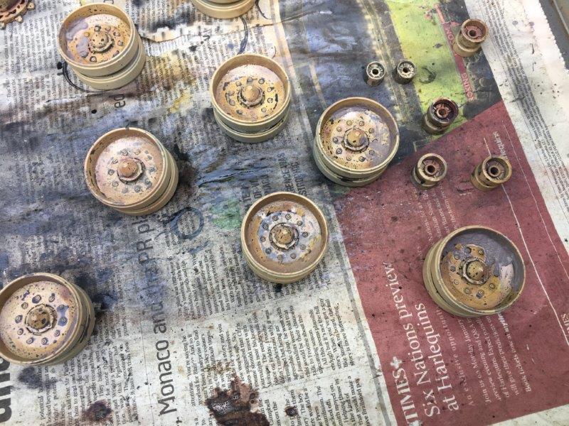

Wheels after applying varnish - look a bit shiny!
More wheels.......
More wheels.......

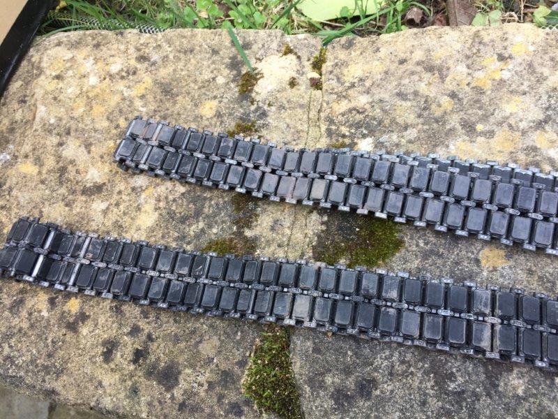

Tracks having had a bit of weathering
Wheels on after they have dried off

So, all in all I am happy with my first attempt with an Airbrush. I like the VMS Powders, and would certainly use the Windsor and Newton varnish again. All I need now is another free weekend to get everything back together, including the cunning plan I have for final plumbing of the TARR smoker. Fingers crossed, there will not be quite the same delay in posting what I hope will be a final installment.

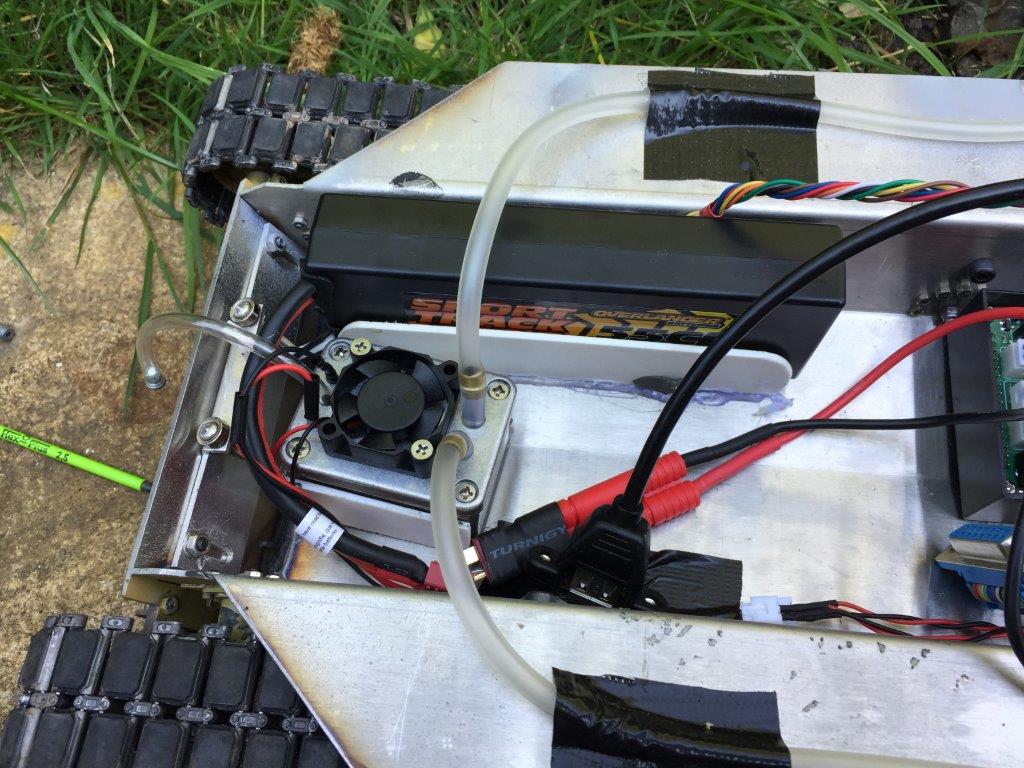

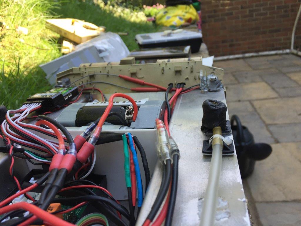

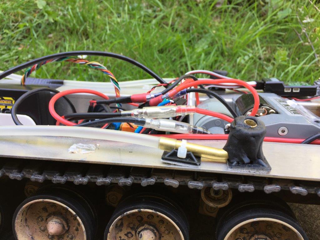

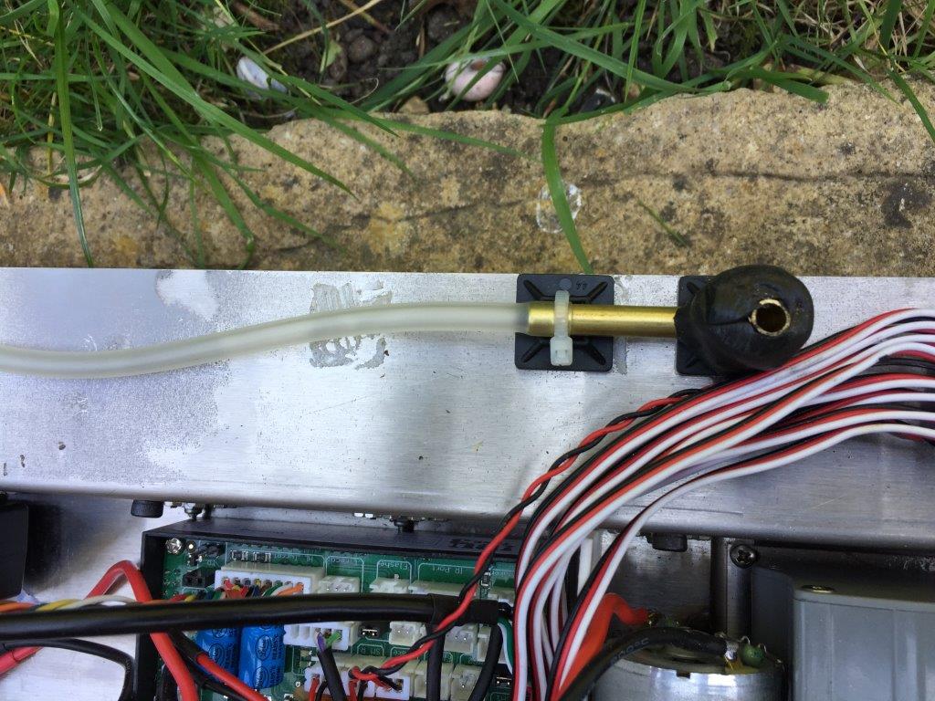

Anyway, back to the TARR. You may have divined by now that I was obsessed in this build with ensuring that upper and lower hulls be separable with the minimum of faff, and I have achieved that aim with a few compromises. One of those compromises (or design flaws if we are honest) led to the over-engineered slip ring. This encroaches significantly in the lower deck space with the result that the TARR was going to have to live at the front of the turret. The exhausts are affixed to the upper hull. Wanting to make especially difficult led me to the decision to use a combination of aquatic tubing, brass tubing and "rubber" columns formed out of SUGRU - the idea being that this would create a seal which was flexible enough to withstand the knocks a tank might reasonably be expected to encounter off carpet. I even used brass tubing to facilitate the connection of TARR to the air tubing.
Here are some pics:
TARR 2 at front of chassis. A long way from the exhausts
R/H smoke stack made using bent brass tube coated in SUGRU
L/H smoke stack side view
You can see the angle formed by the SUGRU
