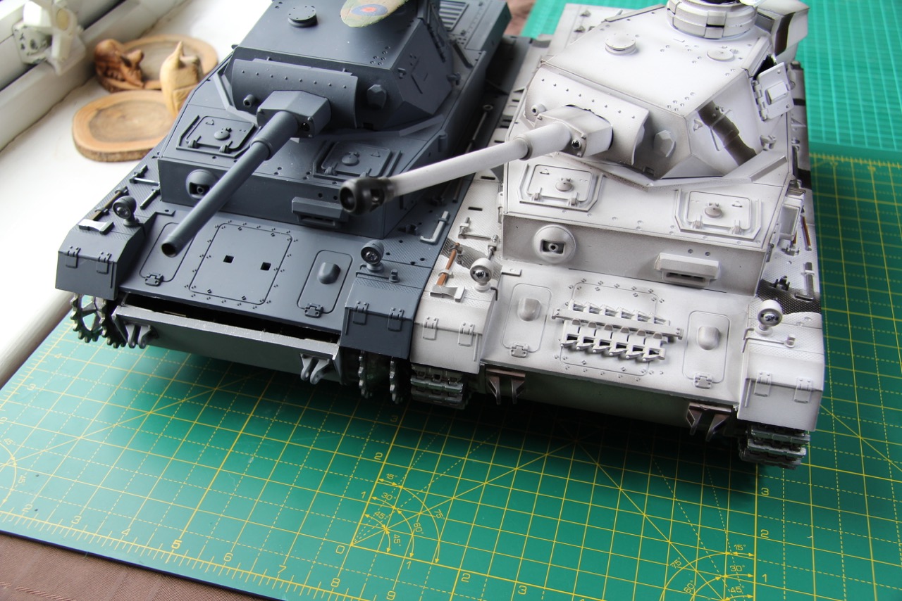

Hmmm..let me state this as clearly as possible, Rad. I have measured (repeatedly !) the Asiatam metal hull and -from stem to stern- it is slightly more than 1cm longer than the Taigen/HL equivalent. Never mind that plate and screws, nothing short of
a Deus ex Machina (Divine intervention..) will ever make give this irritating assembly have the same appearance and proportions as the Taigen plastic one. You can add to it, tart it up, smear it in 'zimmerit'; but..underneath it will still
be too long for the Taigen top. Fact. Not even Penn and Teller could disguise this problem ... :problem: Either the hull has to be shortened; or the HL upper hull lengthened a reciprocal amount. A third option is to use it for target practice with a sledge hammer... :lolno: But this unit was not cheap, and so i shall have to bite the figurative bullet and modify it.. This is what the germans chose to do on the rc-ketten link. With the mention of your being Spanish..incidentally, for some reason I keep getting an impression of Manuel in 'Fawlty Towers' in mind, being confronted by an exasperated Basil Fawlty. Quite why, I don't know... :D Now where did i leave my hacksaw, I wonder?

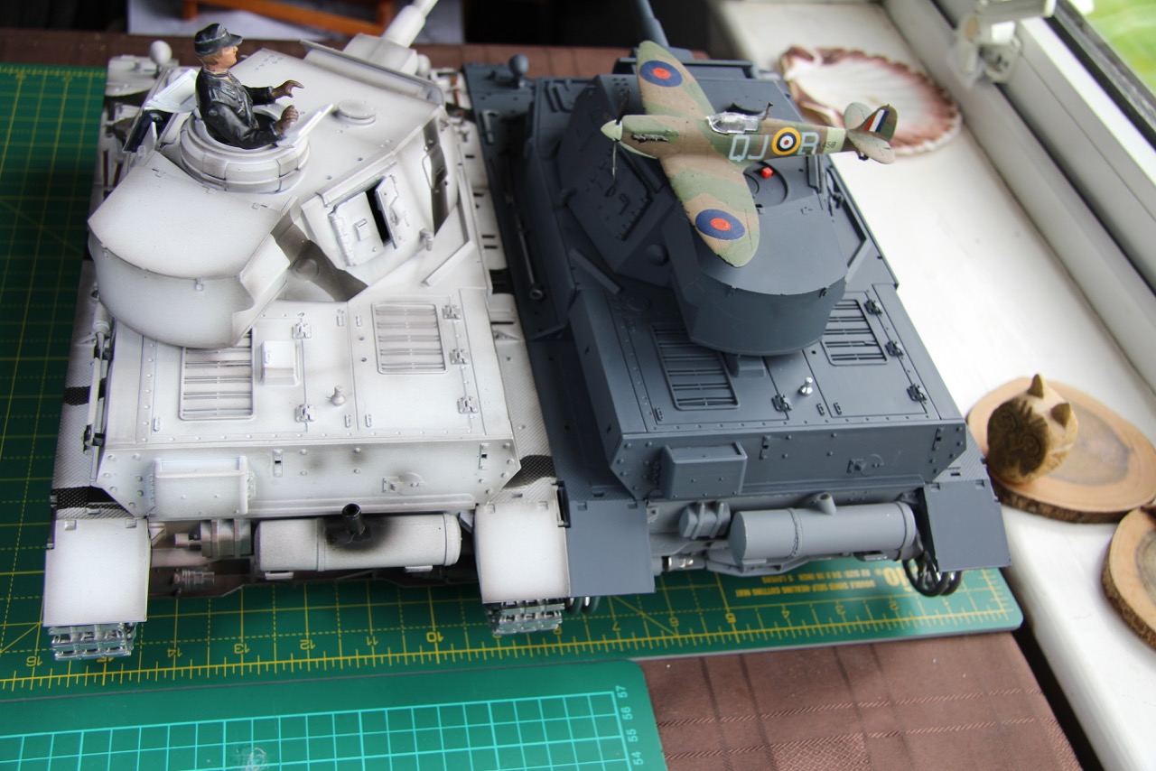

One final set of visual clues to the Asiatam anomaly, before I set out sawing the thing up. Richard asks whether Taigen/HL have the correct dimensions, or Asiatam. Well, I wonder what Tamiya- the Rolls Royce of model tank manufacturers-
decided on. Getting accurate figures for the actual length of the PZ 4 hull is not in itself straightforward; and then it's 1/16th of that. A cursory look on line shows figures ranging from 17.7ft (5.39mts) to 19.5ft (5.92)..and maybe that's at the root of the problem. I see Axel has the Tamiya hull for the PZ IV ausf in stock...and I'm sorely tempted to buy that for comparison purposes. http://www.axels-modellbau-shop.de/kata ... 5465...wow what a lengthy URL!
During that would seem a dreadful extravagance to the canny Scot; but I would see it as the basis of a long term project, when I've consigned the Asiatam horror to the smelter..... :think: maybe.

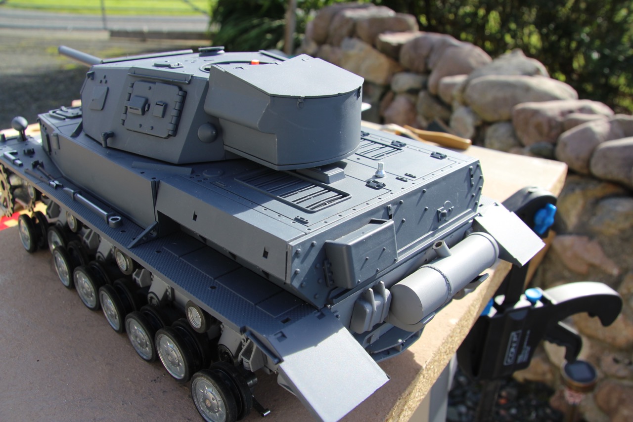

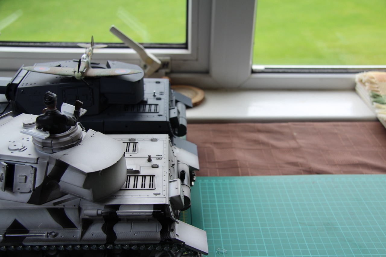

Once again then, this is what the rear of the Asiatam hybrid should look like when correctly positioned. This also what the posterior of the real thing looks like too.. note the exhausts and rear flanges in correct alignment:
All parts correctly aligned
and from another angle:
The perfect posterior..
Now if you compare them with the pictures at the start of the thread, where the front glacis plates of the two were in perfect alignment, you'll see the difference...There was a yawning gap at the back. But look what happens to the front
when the back plates are in their correct relative positions: :O :O
....Worth a thousand words
Any attempt to find a median position, where the gap is evenly distributed between from and rear, is going to look...well, wrong. Really wrong. This is what the Germans found on rc-ketten. What's really astonishing, is..with the exception
of the german modellers I referred to..how nobody has noticed this before. Could it be a batch issue, I wonder? Whatever the reasons, lads, this is going to be a labour of..hate @) Now, is it hacksaw or club hammer? :-< :-<

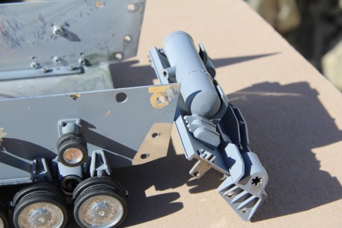

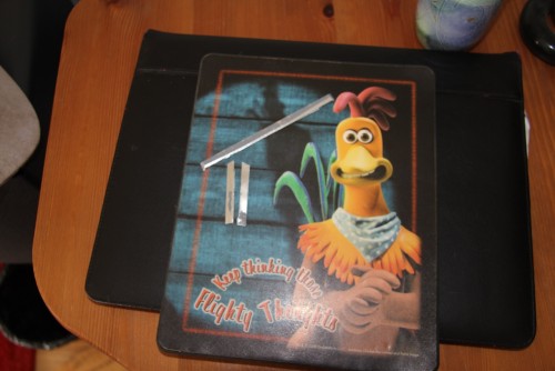

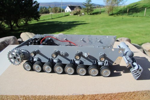

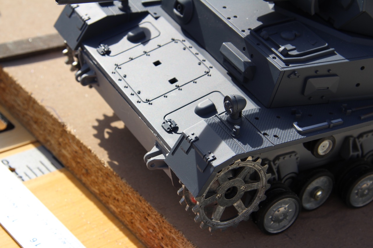

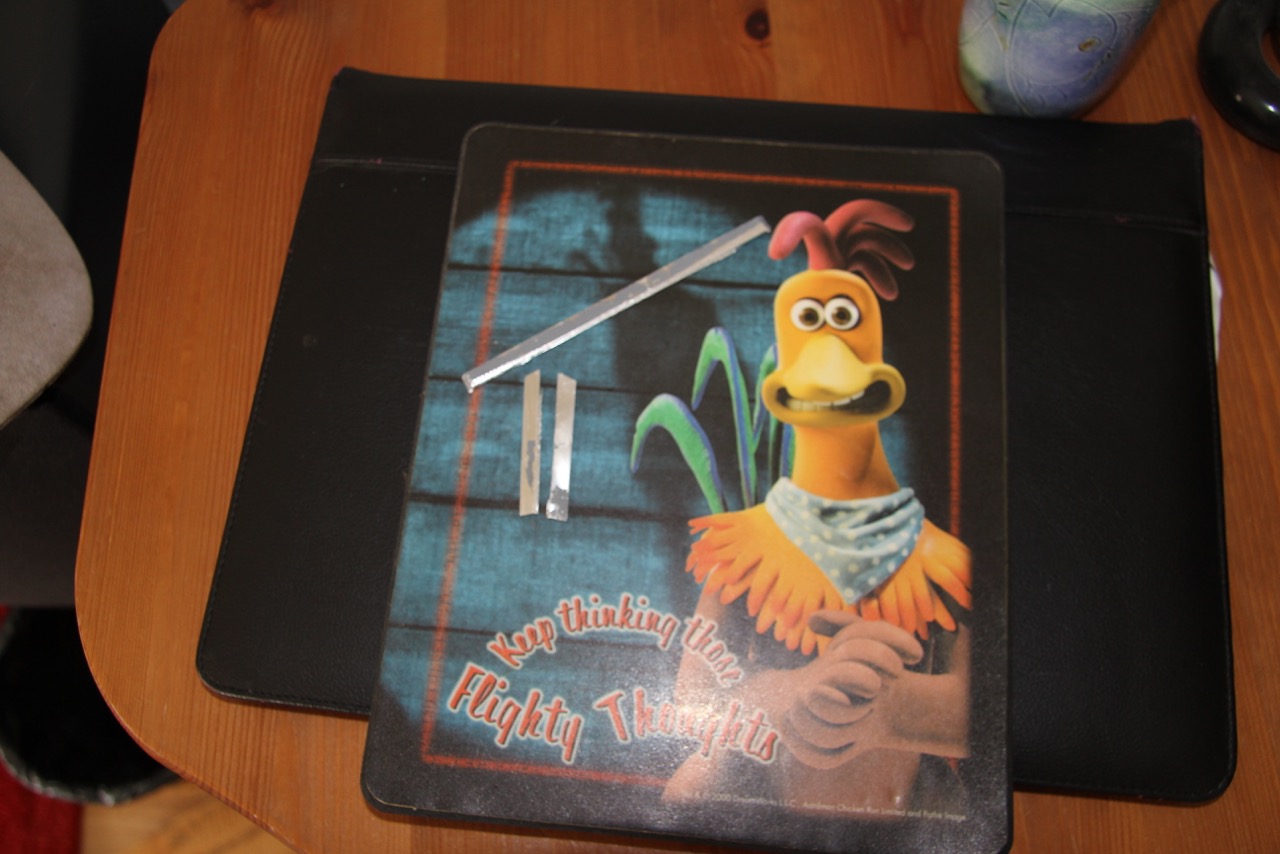

Success!.. :thumbup: A fresh taut hacksaw blade, a mortice gauge set to 8mm as a scriber, a file, and a sunny day were all it took to get the Asiatam hull to sit under the HL upper hull. Previously, the Upper hull had looked as though it was 'wearing daddies shoes..'so outsize was the asiatam lower. Any future developments will now appear on my build thread, after this protracted glitch and hold up...All in all, giving the asiatam a snip at the rear seems to be the best solution. Thus, in all, after the 8mm cut- and some filing for fine adjustment, I took in the region
of 9mm off the back end.
The outsize Asiatam culprit
The offending posterior parts..
Waiting nervously for the snip..
The 8mm bits I removed..
Gone, but not forgotten!
At last: the perfect posterior! Now the Upper and lower hulls are in line at the flange that links them
Post-operative Panzer posterior
and the front looks as it should, but now I have to devise a means to hold the sections together tightly: probably a combination of a mechanical link (hooks of some sort), and mini-magnets..
Front properly lined up
