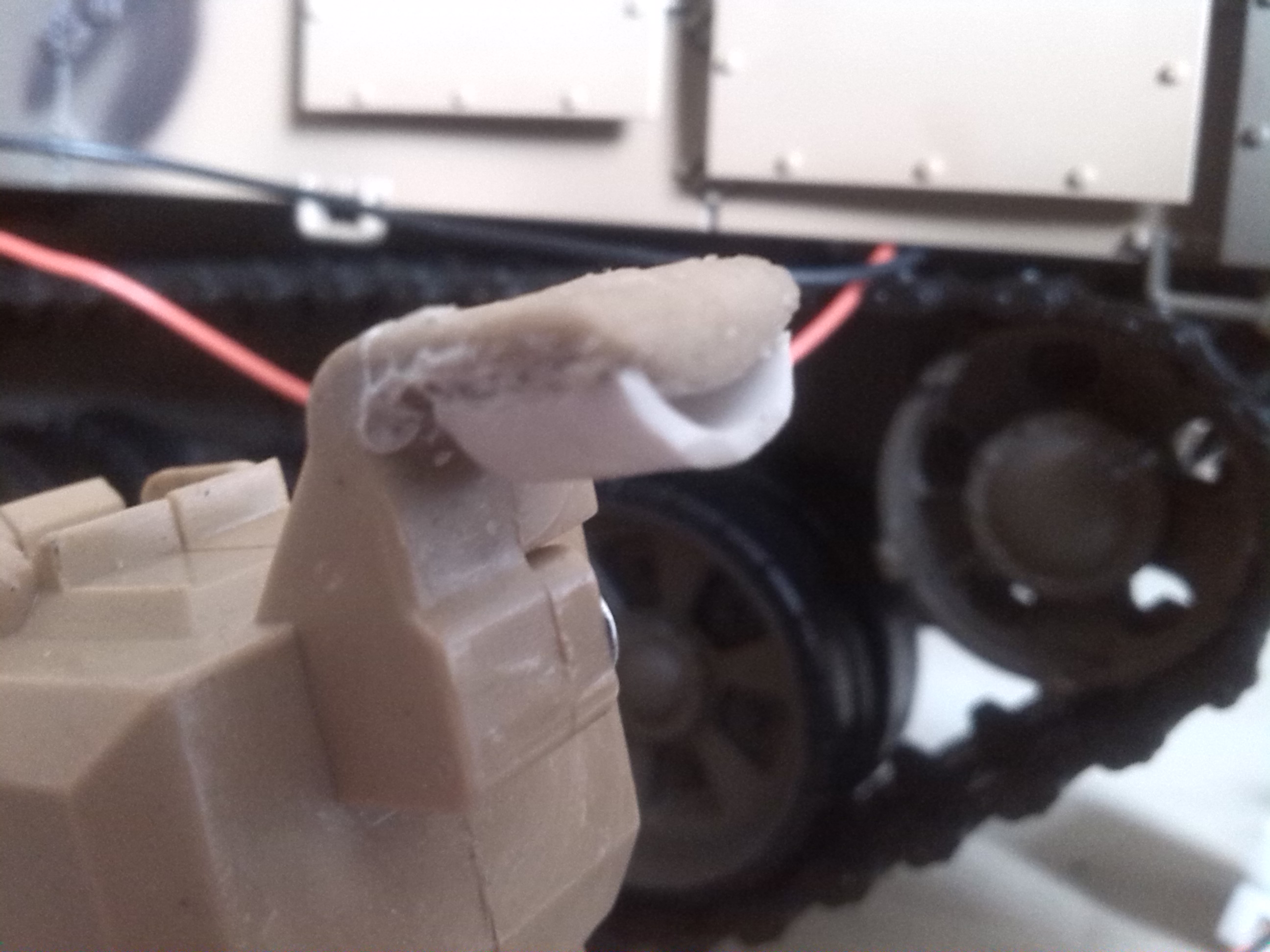

The modification to the barrel elevation worked a treat, it now depresses to below horizontal.

As I had to pull the turret apart again, here are pics of the elevation mod, and another showing where the muzzle flash wires will thread through the airsoft unit without dismantling anything.
