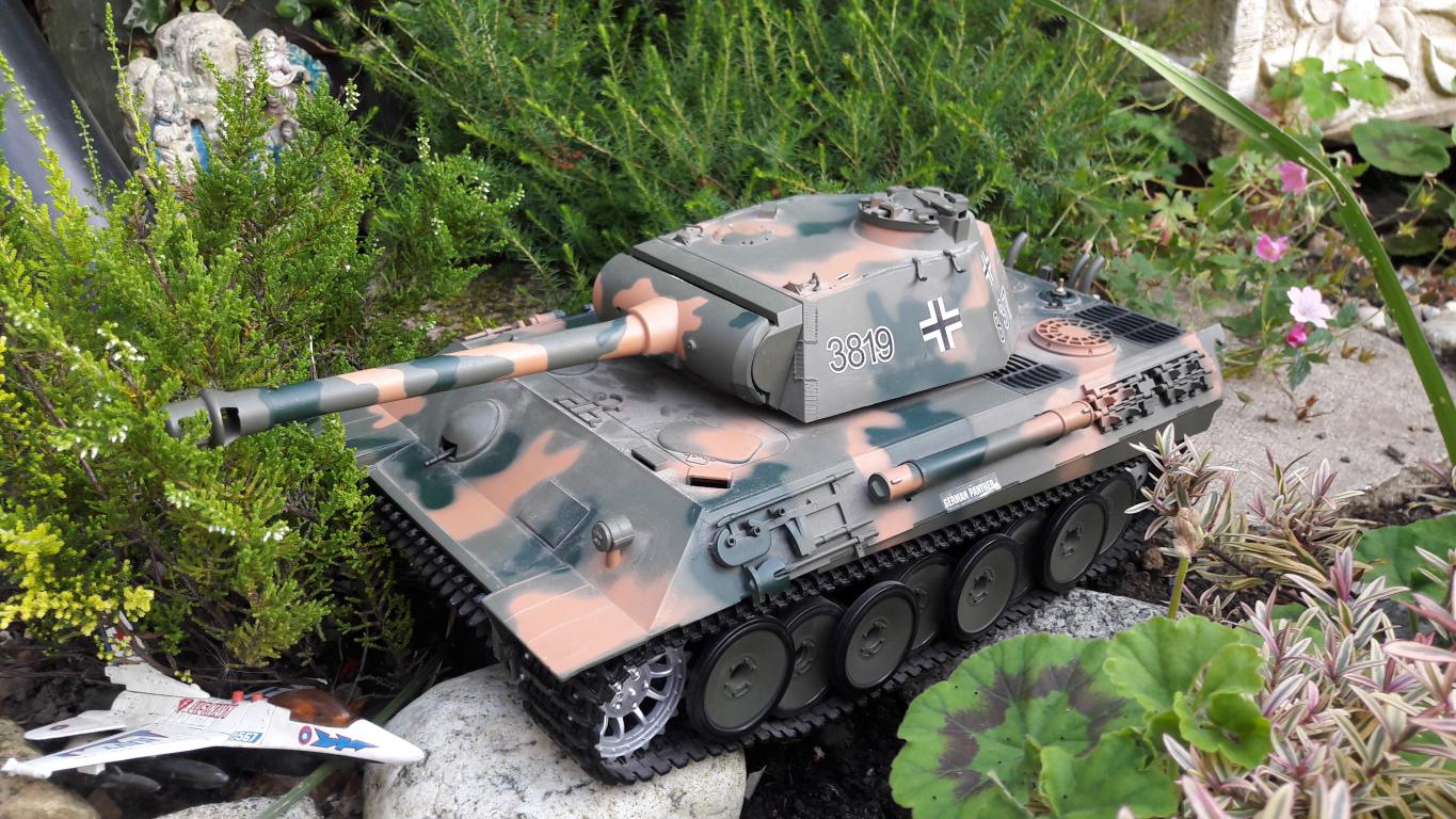

could I play with the big boys now

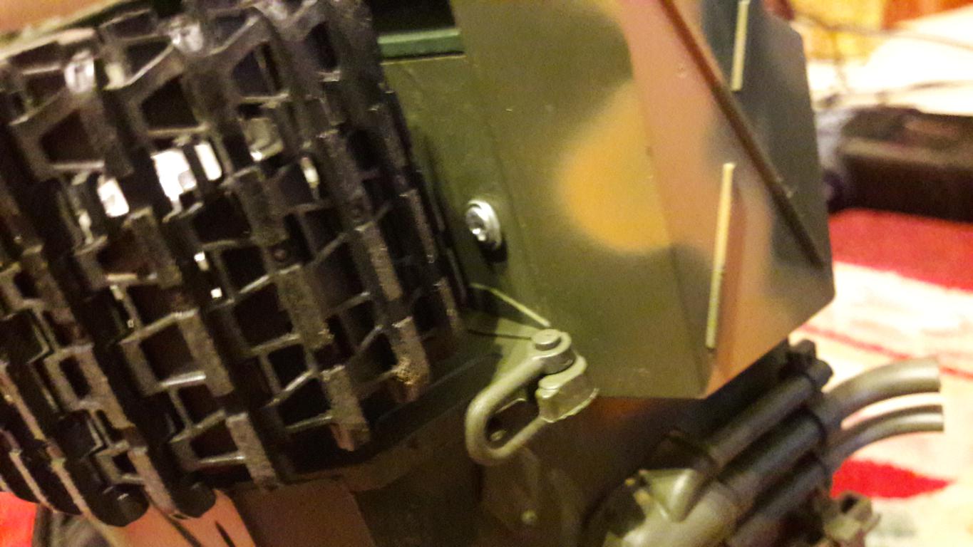

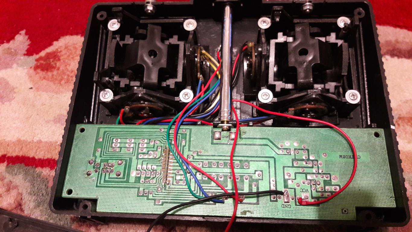

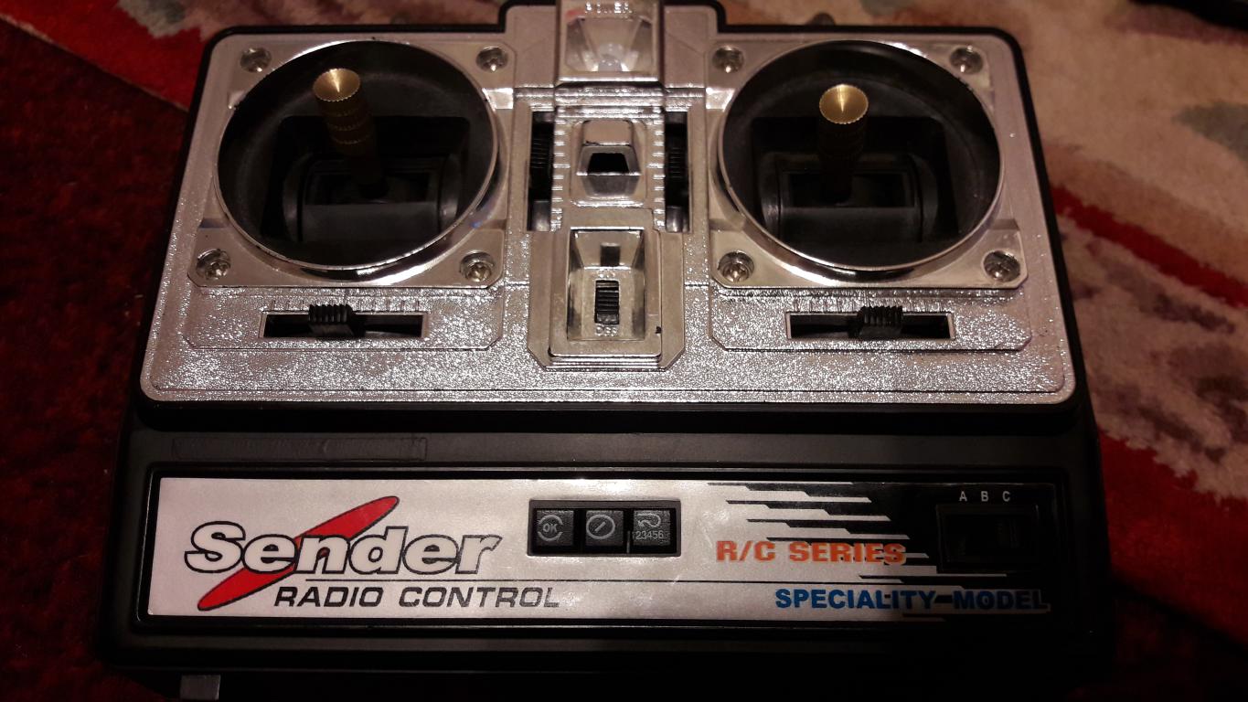

I found this on Gum tree it was £30 and according to the lads Dad the son broke the TX unit within a few days after Christmas all it needed was the left side control lever putting back in the 4 way universal that said he lost the back of the TX unit and the Antenna and I'm not to sure what the three buttons near the base of the TX unit do and I took 3 screws out of the base but there's lots under the Hull
I was hoping it had sound
ps what Number should be on it there's a right mixture on it now

Stewart Hi,
Forgive me but I am slightly puzzled about your attitude to the paint finish on the Tanks you have seen,
Almost none of the Tanks on sale have an accurate paint finish,
This raises some points of importance to me. I have owned and built many Tanks from different sources and without exception I have repainted them all,
Tank building, depending on how far you want to go, can be challenging, but Painting is the easier side of the hobby and it has the unbeatable advantage of being YOUR Tank when you have finished,
There are many sources of reference if accuracy is your aim.
The only important thing to do is you must first clean the whole Tank with Acrylic Thinners using a lint free cloth, Then as with any thing else, you mask those things that cannot be removed,
If it is a Heng Long Tank all the external tools simply POP off, then using a hairy stick or a rattle can or an Airbrush you apply a primer then a topcoat or two. all the time reminding yourself that most Tanks were painted in the field by the Tank crew using rags and a yard broom,
Give it a go, after all Acrylic paint is water soluble and can be easily removed if you don't like the finished artwork.
Shaun.
