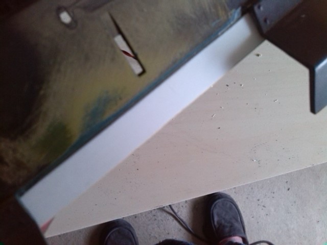

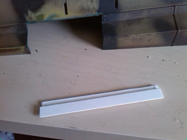

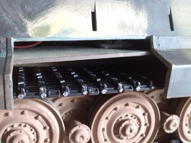

I did the fender removal, and managed to make a neat job of it. I took pics so that anyone else who is thinking of doing it can see what is involved. I sanded out the joining strips both sides to make it more accurate (or as accurate as it seems to be going by all of the pics I have looked at). Also went all around the hull filling and sanding all of the accessory holes, filled them in, and gave it a quick blast of primer to check that I hadn't missed anything.

We're you able to install that little piece of plastic card without trimming the part of the lower hull?

It was 10mm wide and came to bang on level with the bottom of the lower hull track cover. I will be covering it with zimmerit so the join will be invisible. I looked at the Atak kit and see that it includes parts for the Tamiya that I wouldn't use, I may either do my own or just buy sheets and cut them to size. The zimmerit 'slots' are 10mm wide judging by the one at Bovington. If I do it with Milliput and it turns out rubbish I can just remove it and buy the sticky stuff.jackalope wrote:We're you able to install that little piece of plastic card without trimming the part of the lower hull?

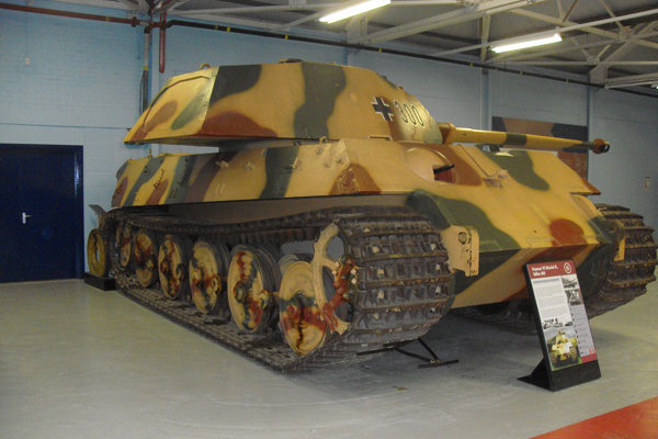

Zimmerit was standard fitment when the first run of KT's was built, the Porsche version was the initial 50 tanks so they would all have had it applied at the factory. Looking at the archive pics of tanks with the fenders missing they all have zimmerit extending down to the bottom of the hull sides, which would tend to support this. The stuff is so messy that trying to apply it along a plumb line and then attach the fenders would have been very time consuming and difficult.jackalope wrote:The zimmeret wouldn't go below the fenders unless it was applied after the fenders fell off. I would also say the camo should stop at the fender line as well and the portion from under the fender should be the tanks base color or primer.
The Porsche KT at Bovington doesn't have any zimmerit as it wasn't a battle tank, it was one of the prototypes. There is no loaders hatch on the back of the turret.

Tanks are a tricky thing, take a look at the exhaust shrouds on the back of the one in the pic above? I've never noticed those before.
