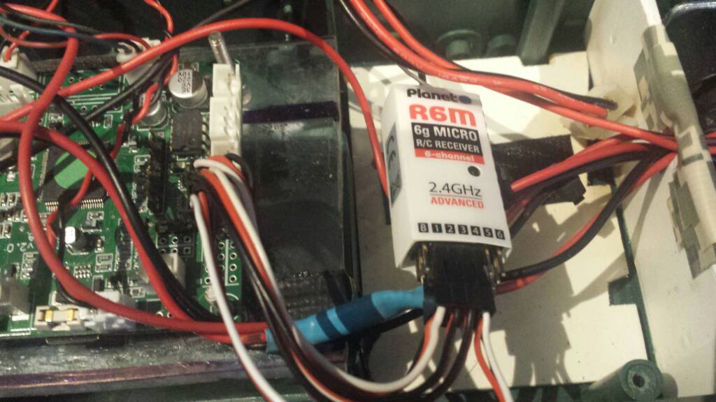

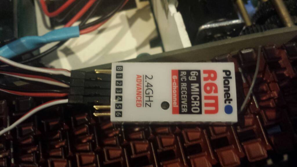

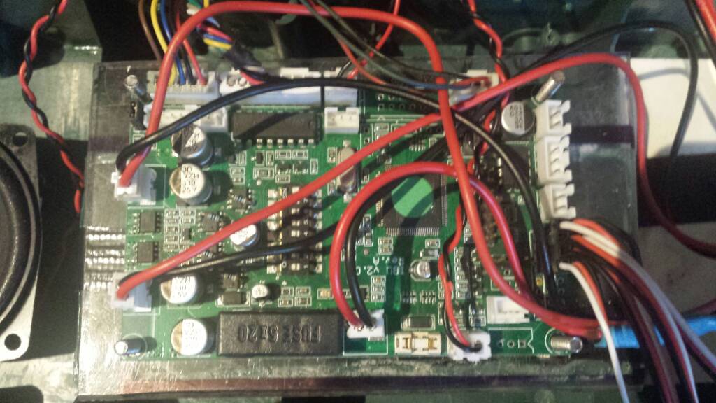

I've taken a few pictures, don't know if they are useful or not so I tried to include everything Image
Your help is greatly appreciated guys Image

First observation is that on the pic of the receiver it looks like the plugs for 2 of the channels are in around the wrong way?
They should all be in with the white wires along the same edge. The same at the board end.
The wires are signal - white, live - red, negative - black.
By putting them in the wrong way around you won't get a signal from the receiver to the board etc. White will be the signal, so check the Planet manual for the rx polarity and the IBU manual for the board polarity.

I will take a look at that Rob, I can see what you mean about the wires now ( being colour blind doesn't help me much ) :haha: , I put all the plug ends in facing the same direction ie with all the sides with the little cut out showing the connections :eh: I thought this was how they were supposed to go, I'll change those 2 around and see if there's any joy :thumbup:

The speaker looks to be in the wrong port.
If you look in your 3rd picture it should be in the left hand 2pin socket.it also needs the volume control plugged into the 3pin socket next to it.

First connect the speaker and volume as mentioned above.
Unplug the receiver cables from the board.
Take the wires out of channel 2 and 3 on the receiver and turn them 180 degrees so the wires are the right way up.
Now take channel 1 from the receiver and connect to channel 1 on the ibu
Channel 4 from the receiver goes to channel 2 on the ibu
Channel 3 from the receiver goes to channel 3 on the ibu
Channel 2 from the receiver goes to channel 4 on the ibu
This puts the correct channel pairs on the correct sticks.
Set it up then take a pic and we can tell you if you need to rotate any cables.
