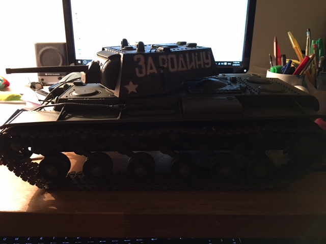

- Airbrushed on slogans
- image.jpeg (77.72 KiB) Viewed 5103 times
