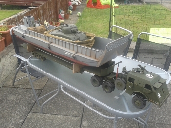

Hi I think the total to build the Dragon wagon was just under £300 this includes a Bruder Trailer which I have stretched to carry my LCM Has working ramps and legs .

971wright wrote:Hi I think the total to build the Dragon wagon was just under £300 this includes a Bruder Trailer which I have stretched to carry my LCM Has working ramps and legs .
Dang, that's cool! Where did you get the Tamiya Chassis?

Hi Bought it on e-bay just a rolling chassis £150 , had all I needed wheels gearbox and motor axels and suspension. Had to move the front suspension and gearbox from standard to fit under dragon wagon cab . If you don't want to scratch build the cab (which isn't easy buy a scale model to copy) you can buy one here http://www.modellspiegel.com/m25-m26-pacific/
