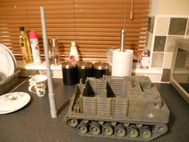

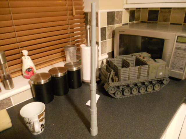

Well I went with what I had calculated, had to make a few adjustments while printing as I had to split the barrel into six sections, it took all day.
It's about 13mm too long, but I can live with that, and there is no way I am going to re-do it all now, though the glue hasn't taken on one of the joints (pla is a bit hit and miss with superglue - it worked on all of the joints except one, so I tried plastic glue, and then araldite) so I may have to cut a short length out to get back to solid material.
Here's a couple of pics next to what will being towing it, just to show how long the barrel is. Sure beats any tank barrel....

Hi Rob seen next to the gun tractor it looks right when compared to the google photos. Really great job! Alwyn

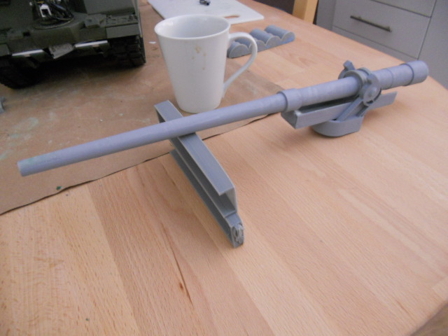

Getting a bit more done, and posting the parts onto a printing site as I go so that anyone else can do this if they want to.
The recoil bed is a pain. I have had four attempts at printing this, but every time it starts lifting off the print bed towards the end. I decided to repair the best one with styrene in the end as it was becoming a chore waiting 90 minutes to see the next failure.
