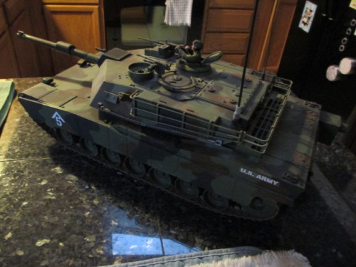

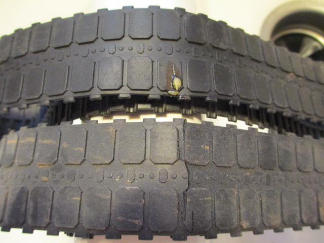

I had one of these for years. It was the first large scale RC tank I owned. It was a ton of fun ( to be truthful, it wasn't that sparse inside so I guess they got cheaper as time went by ) and I really enjoyed it for what it was until HL brought out their first Tiger1. The tracks eventually went and Tankbear got me fixed up with another set. A friend who was really down needed a hobby recently so he got it with a directive to fix the turret rotation gear ( and how to do it ). What Tankbear has done with these tanks is pretty amazing! so you are in good hands to get yours to a higher level. ;o)
