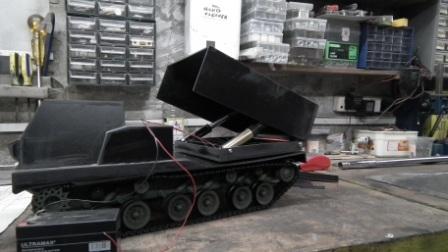

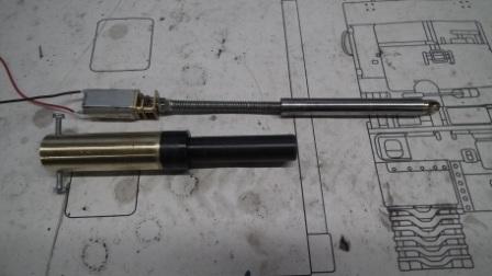

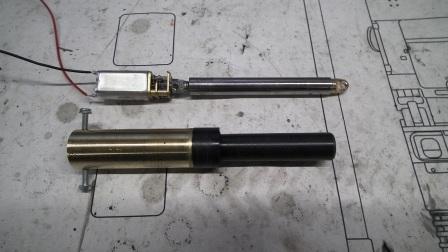

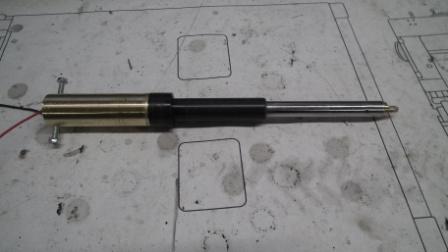

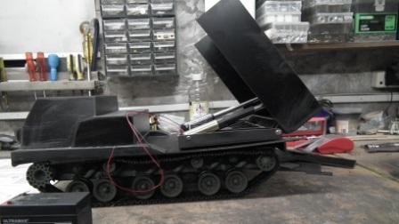

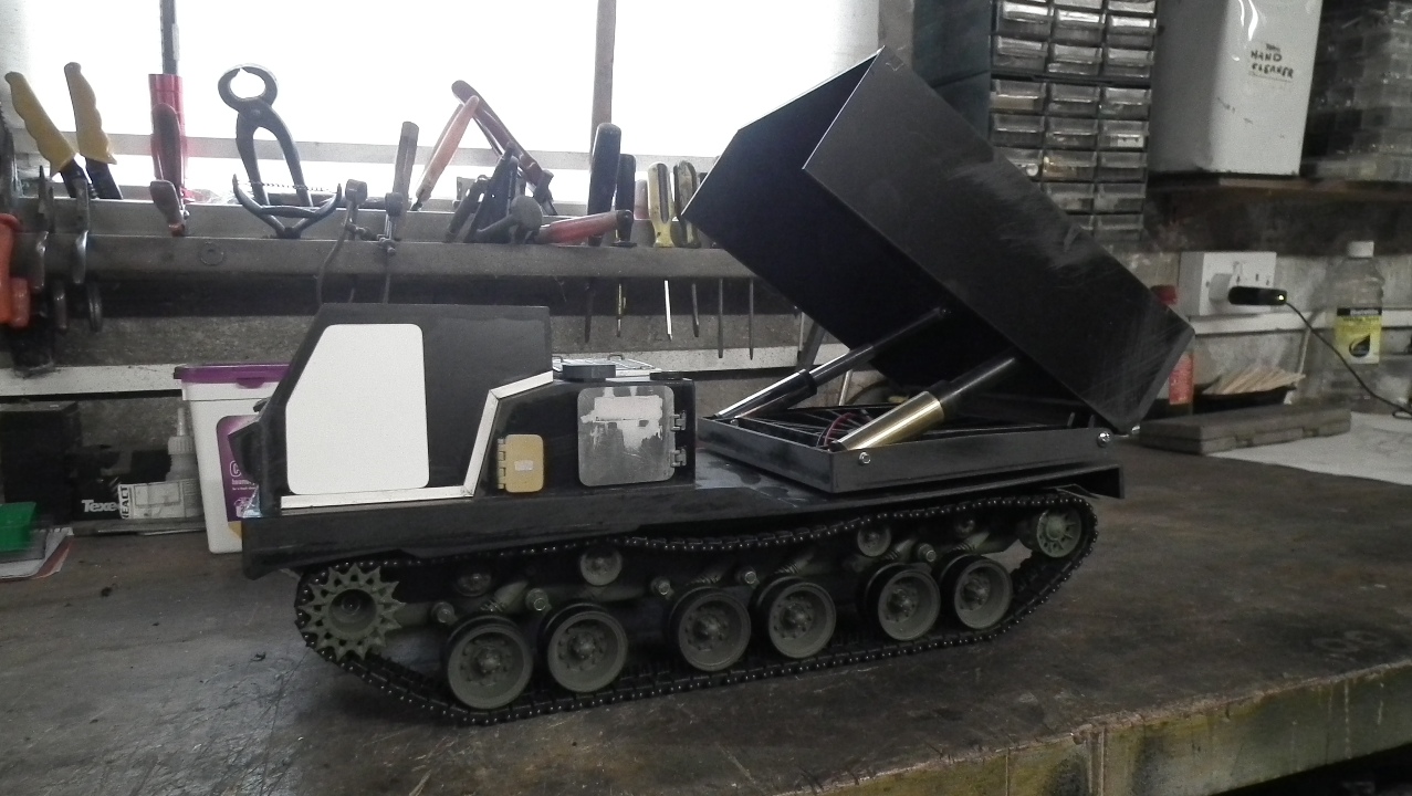

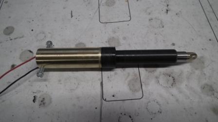

Apart from being bored stiff with this damm bad back and hip, I thought I let you have the lastest pictures of my effort at a M270.
They just off my lifting actuators for the missle box and then fitted to a basic box once I'm happy with all the workings I'll start on the detail work.

Well she now drives and turns also the missle box rotates and also lift's. Sooo now I have decided it's got to fire at least one missle so I've decided to go for the PFRMs load out which is an airburst system and is only one large rocket in each pod. So I might have a chance to design a working system to fire just the two rockets, (not sure about the airburst bit :haha: ) but you never know I'll have a rocket 150mm long by 30mm dia might by able to rig something up >:< my god that would surprise a few people at a battle day.

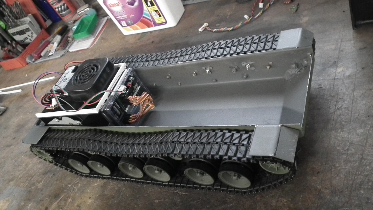

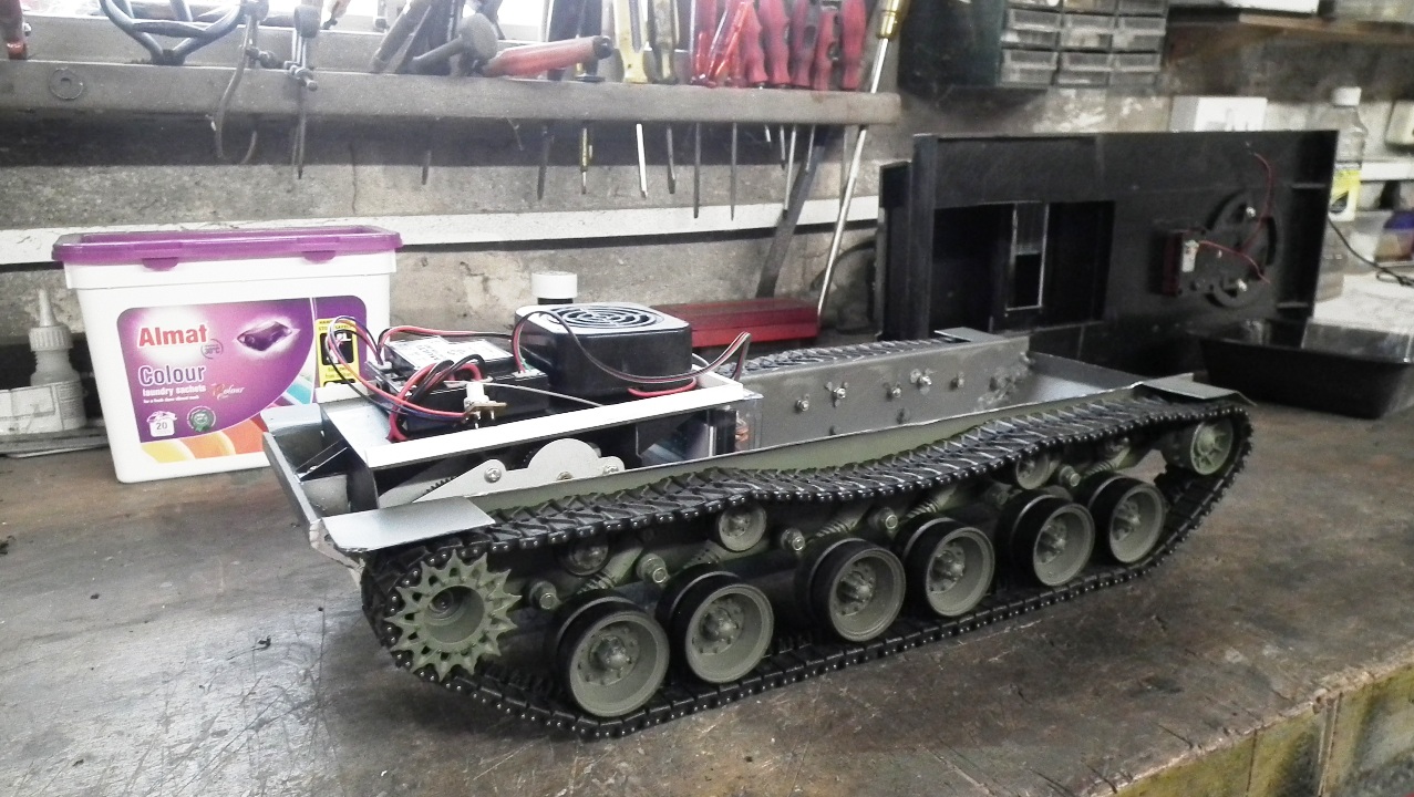

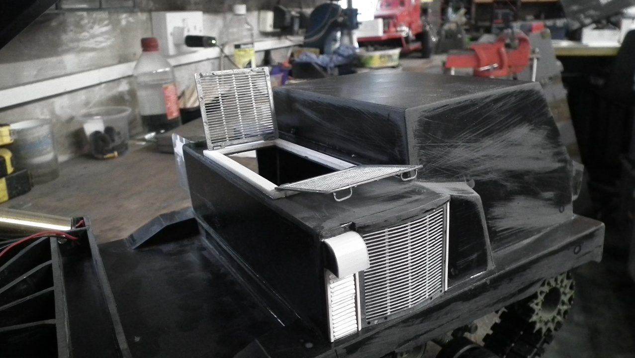

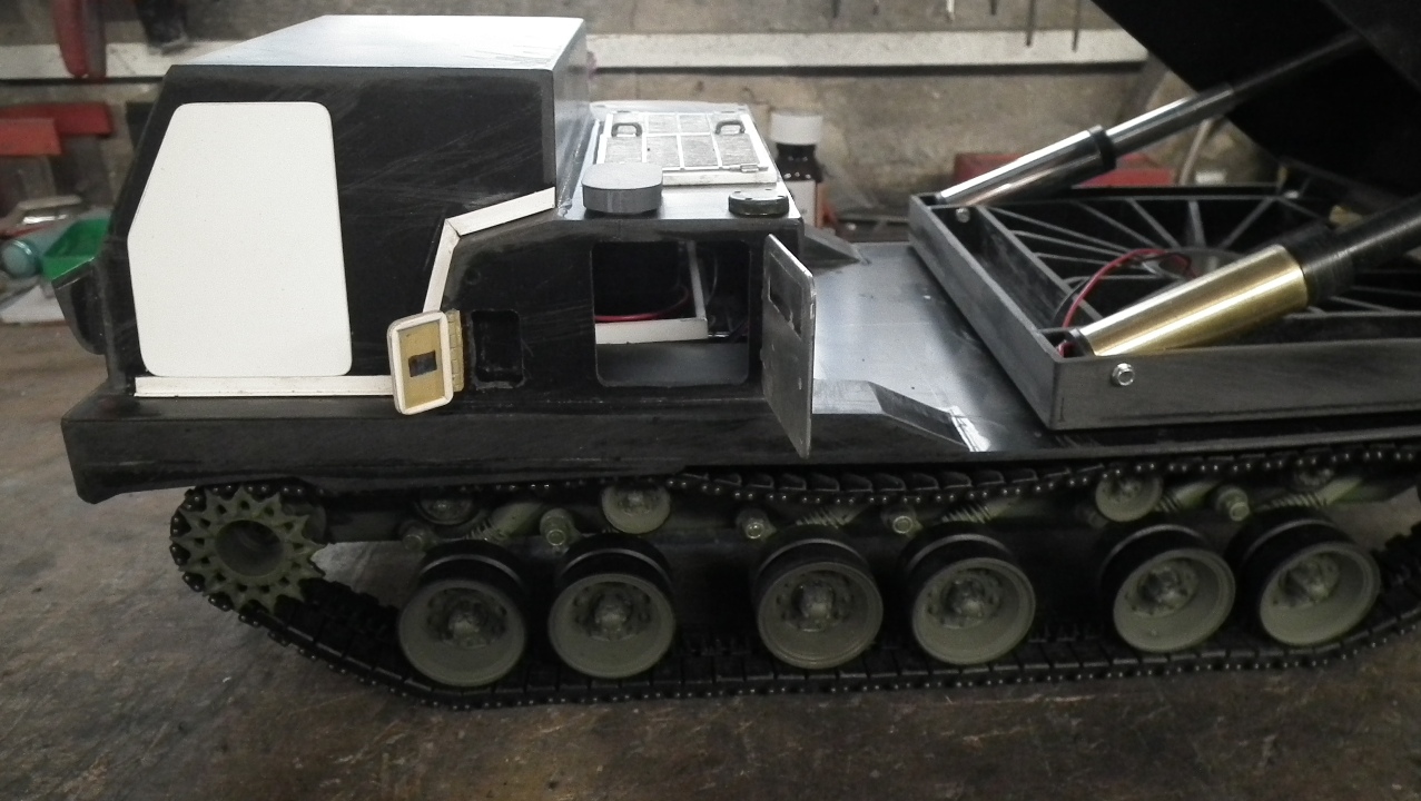

well its been a while but I've finally got back to this project and so started on some of the detail work. I thought I'd get the big stuff out of the way first and then work down to the tiny bits later as and when.
I going to use a mix of HL (RX-18) for motor control, engine sound, Lights and missile table transversing, but driving the RX-18 through a RC5HL converter and a Turnigy 9X transmitter, Thats only 3 channels and so leaving the remaining 6 channels for missle platform lifting, missile firing system and maybe missile pods removal and replacement plus any thing else that might be needed or will fit in. Due to the low chassis profile space is very limited.

hopefully do the window shutters, ariel bases, and doors next.
Denzil
