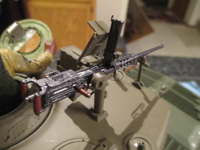

The Gunmetal Blue looks good unweathered as well. ( inserted a pic of the .50 cal on the Pershing ) To get to your stage of realism take a good deal more work. ;o)

Your .50 Cals look really good too Painless.PainlessWolf wrote:Paul,
warm regards,
A good starting point is always helpful and those Tamiya .50's are excellent. I used several different MG34s and barrels for parts for the 2 in the picture. Research helps too, and I will usually download dozens of pics of the real thing before painting.
