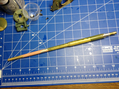

Here's update on my KT.
For anyone wanting their L/71 too kick-ass.
Resleeved with a 6.03mm brass barrel, lathed on drill press for proper taper and airsoft fit, same length as original.
New Taigen shooting unit.
Used a press-fit/glued on Taigen brass muzzle break (didn't need too thread the end).
Results are: flat trajectory out to 25-30ft!, straight as an arrow! Best shooter I've got! The L/71 is still king!
