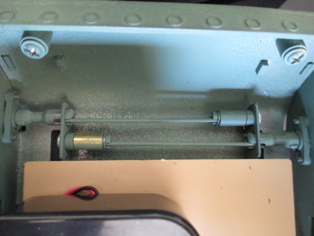

I didn't notice any sideways variation but I did notice that the amount of bend in the loop was not the same. The bars I added to the back two sets on the KV-1 lower were of slightly different lengths to mate up with the end of the loop and be cemented into place. Could I see a pic of those troublesome clips? They may be different from what I worked with.

Will try Painless... My macro is kind of touch and go... but I'll see if I can get a clear picture :D

After five shots...this one came out the best
You know Painless the more I tinker with Taigen... the more I appreciate the simplicity of Heng Long :haha:

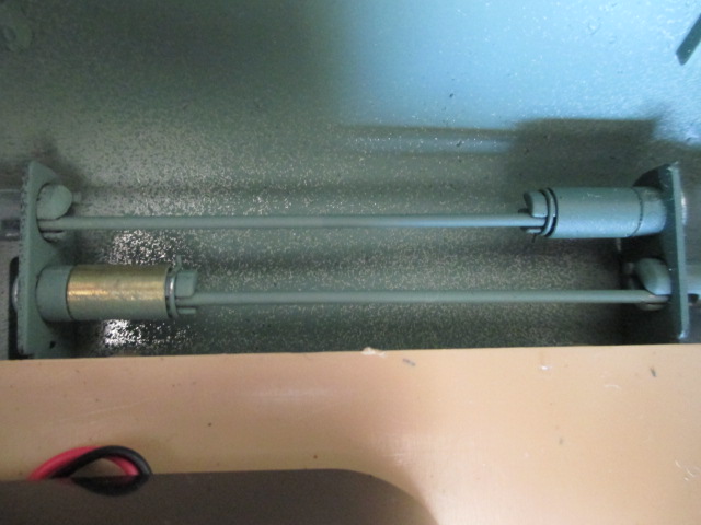

Alpha,
Yes, that is a different suspension than the one in the KV-1 lower hull. The ability to adjust the position of the swing arm and thus the tension in the bar is a step up from the system I am using. I don't see any 'C' clips here just the cast in part of the mount of the side wall that looks summat like a 'C'. Except for the diameter of the bars, the whole system looks beefier than the one I worked with on the KV-2. You can see the 'C' clips on my version. They hold the sleeve in position that keeps the bar in the arm mount.

There is a "C" shaped thing on the silver cap .... but I couldn't get a handle on it...you can also see the castellated ends... which could be turned for adjustment...not sure if this is old or new.... the hull I just got was a second hand purchase... the guy said he had it for three years ... and was selling it because he couldn't figure out how to adjust the suspension arms...I figured it out... but if I could have disassembled the whole thing... I could probably set the arms perfect ...right now they are a little inconsistent...but workable
Yours is completely different.... but still I would say replacing the rods with blades would make the current settings better... You're fortunate in this area because Tamiya makes the KV2.... so getting those blades will be easy ;)
