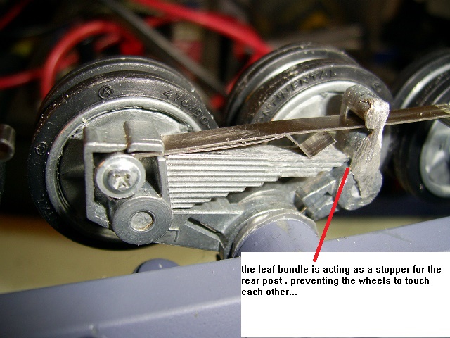

It could be done without removing the suspension from the chassis: -Remove the clip by sliding it toward the back wheel
- You can then take the leaves off the assembly
I would cut the second leaf because the suspension is now using the leaf bundle as a stopper when on rest position
This mod also raise the suspension and give more ground clearance to the lower hull
It's quite a simple mod; here's another pic that can help:

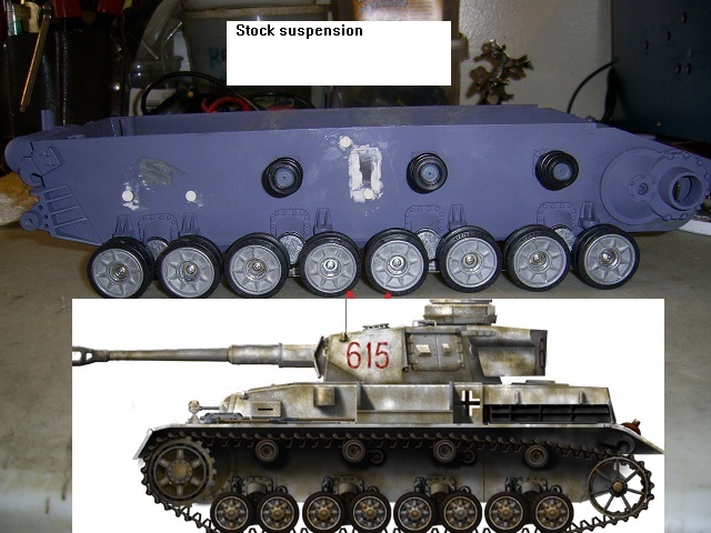

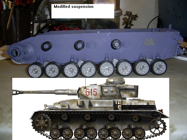

In my opinion, the stock suspension is riding too low...
Even after softening the leafs, there's too much space between the wheels on each posts; leaving not enough between the wheels of 2 adjacent posts...
Trying to compress a suspension like this will result of the rear wheel of one post rubbing against the front wheel of the next post...
Here's 2 pictures comparing the space between the wheels to the real thing; before and after the mod.
Heated debates on climate changes contribute to global warming!!!
